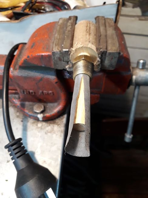

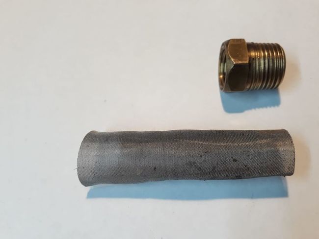

Some works this week.

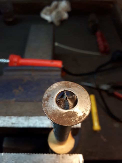

HI you have done a nice job of making a filter i like how you used the washer to make the shape at the top 8-)

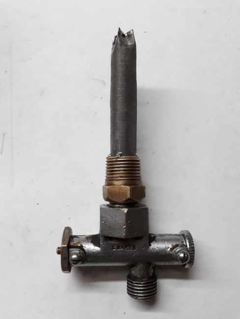

How does the 'Reserve' work Luis ? With the just the filter as you appear to have it, won't the 'Main' fuel tap be supplying all the fuel from the tank ? When you run out with the 'Main' tap on the tank will be empty and there will be no fuel left for when you switch to the 'Reserve' tap.

Well the reserve i think has been short than normal.... my be a few miles plus then open tap...
I can enlarge the upper inside pipe.. I have not done tests yet...
I will have to carry and extra jerrycan! :lol:
