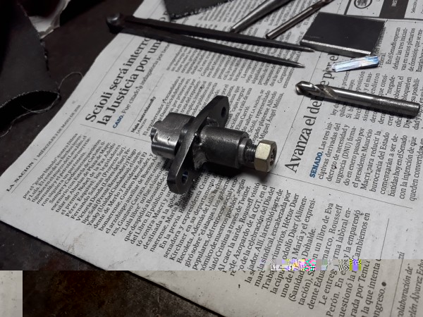

Today I started to build the cam
A scrap bolt turned into brake cam! :lol:
it remains to adjust and finish ...
Luis, from Argentina
1944 Ariel WNG
Posts: 5564
Re: W/NG Front Brake Cam
Don't forget the square on the end is displaced about 10 + degrees to get the brake arm in the correct position. They MAY be slightly tapered. That would get a better fit. The "fixed " washer is rivetted on. You leave a small extension. Hope it's not to late for that one. Nev Nev

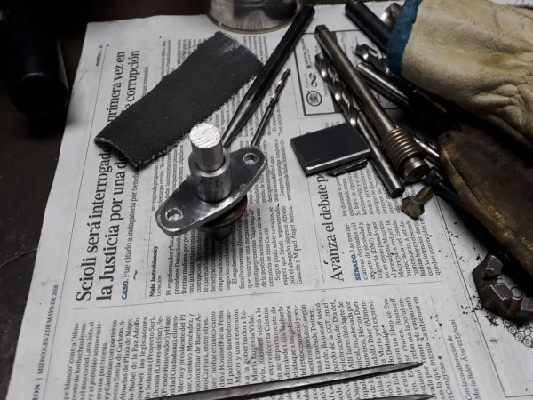

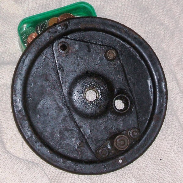

Posts: 5564
There's no bush as such. The cam turns in the floating "bracket" P/n 4130-32 held in place with two 1/4" bolts P/n 0531, 2 stepped nuts P/n 4132-29 and two Thackery washers . The holes at each end are elongated to allow movement for the shoes to centre when the brake is applied. It's fabricated by welding but you could make it from solid mild steel (or even bronze).. Nev

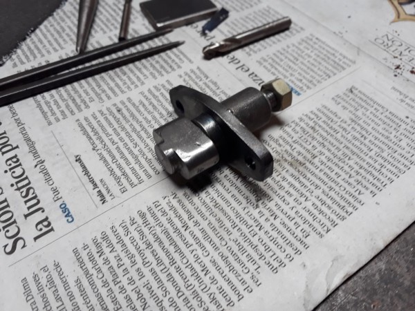

Post by LuisPaz »
Some work today...

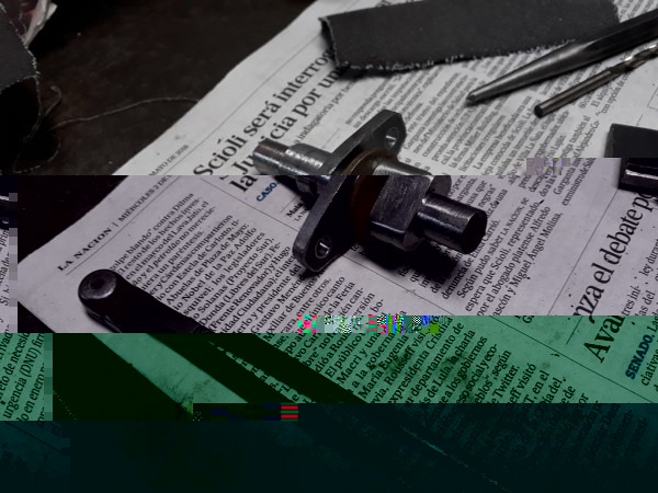

Post by LuisPaz »
I keep moving slowly, adapting parts that have to be twinned, it takes time.
