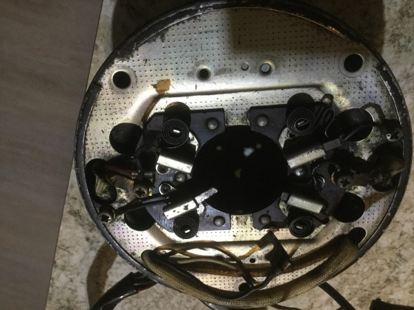

That is useful information and your link for regulators was exactly what I was looking for, thank you.
Swapping over of the brush units on my dynastart may not be straightforward, it seems not to be in its original configuration as you may be able to see in the photo of what I am working with.
Regards
Ivor

Hi Ivor
The earth brush terminal looks to be in a different position to mine but you could always tap another hole for them as it only connects to the main body, just be careful to miss the field coils inside!!
Regards
Peter
Regards
Peter
