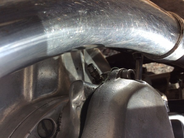

I have stripped the Threads on my 1945 NH 350 oil feed stud (see pics). What would you recommend as the best way to repair? I believe the stud is 1/4". Drill it out? Weld in a replacement 5/16"? Suggestions?
david.anderson
Posts: 1618
Re: Rocker feed stud
Post by david.anderson »
Satchison
the stud screws out. Use a good pair of vice grips and unscrew the stud from the timing cover. New studs are available from drags. Fit 2 nuts to the outer end of the new stud and lock together then and use the locknuts to screw the new stud in.
David
satchison
Posts: 39
Joined: Sat May 30, 2015 6:00 am
Post by satchison »
Thanks David. I was hoping that was the case. I have found the parts on Drags and will order them up. Cheers!
