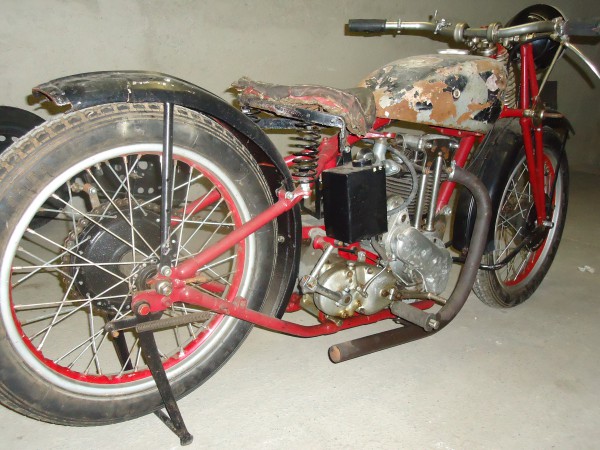

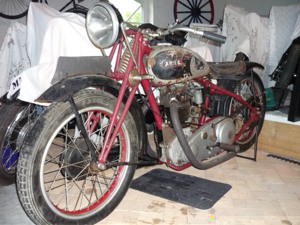

Enclosed a few pictures:

OK Roland,
the tank is wrong, the front engineplates are homemade, the swing connecters of the frontforks are not Ariel, battery holder wrong, footrest wrong, brake paddle wrong, carb wrong and that's one side.
It could be a 250 barrel.

Hi Roland,
There is a good basis for a bike there - and it looks like plenty of experience is sitting under those sheets in your photo.
The primaries are rare, as are the pressed steel brake hubs.
The correct tank is the same as for all panel rank 350's, but has high set mounting bolts for the kneepads.
Your rear brake setup is correct, but missing the pedal part.
The correct seat has a flat back edge - no rib to stop you sliding back.
I think the handlebar levers (mag) should be the long type.
Carb should be a type 75 (or similar), with holes along the bottom of the jet block, and 11 degree angled float bowl.
One of the professional magneto people should be able to help you. This depends on where you live.
As Adrie notes, it would be good to see the other side.

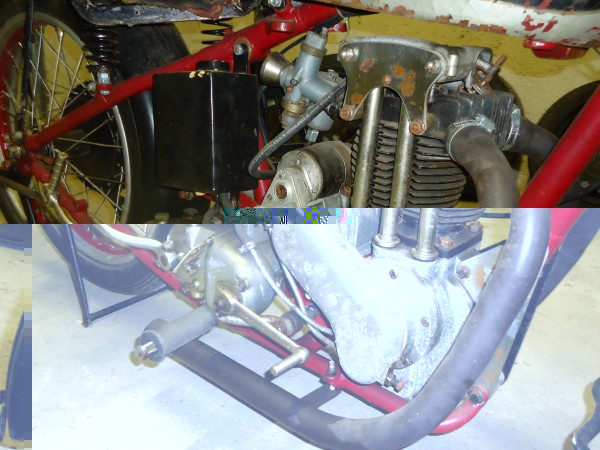

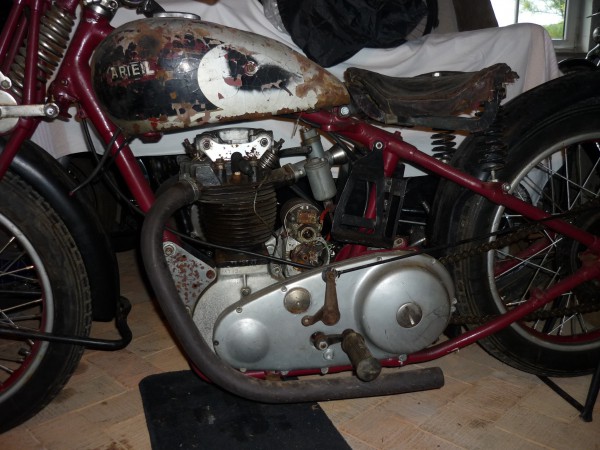

Here a few more pictures. Maybe some more wrong parts
thank you all for your fast replies.

Hi Roland, I think the mudguards are right, as are both hubs.
Love the oil tank!
Your timing cover is from a later bike, as is the kick start lever.
You have some of the hard to get parts, including twist grip, primaries and hubs and are missing the tank panel and its fittings, electrics and some tinware.
It always helps to get the factory records, so you know what model and specs you are dealing with.
Brenton
Love the oil tank!
Brenton
[/quote]
The footrest and his supports, the clutchlever and his supports.
Engine and frame could belong together.
Here the best I can find, http://www.yesterdays.nl/ariel-1934-hun ... -2227.html
