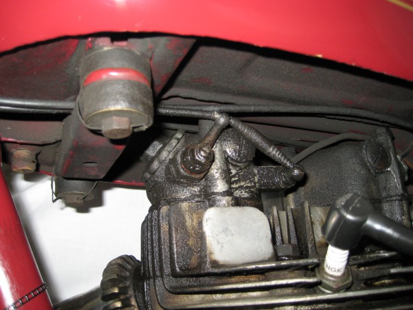

Sorry Ocho, its not the pic you wanted
The lever on the valve lifter is on a taper and when the cable is pulled the lever swings towards the front of the bike. The converluted spring returns the lever back . The trick is getting the lever fitted in the right position so that theres a little play and not pushing down on the rocker at rest. I'll get a picture organised.
Steve
Steve

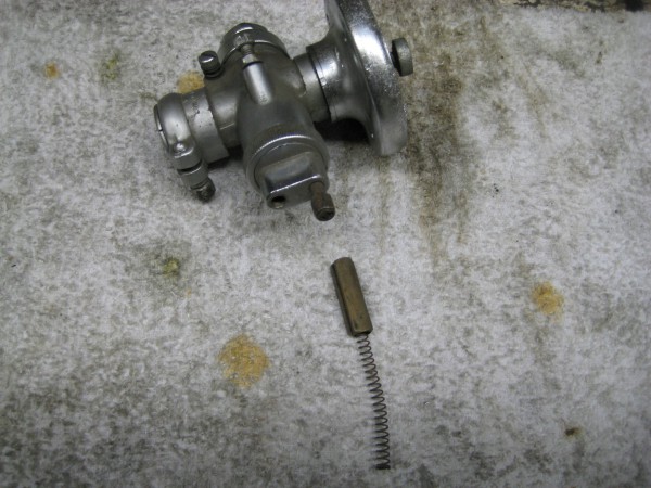

If you have no choke cable and lever fitted the actual choke slide may also be missing inside the Carb. My guess is the bike will run fine without a choke slide but if your choke slide is still in the Carb without the cable fitted your bike will try to run with the choke on all the time, not good.

Is this what your looking for
There should be a small cilinder end to your cable not a bal.

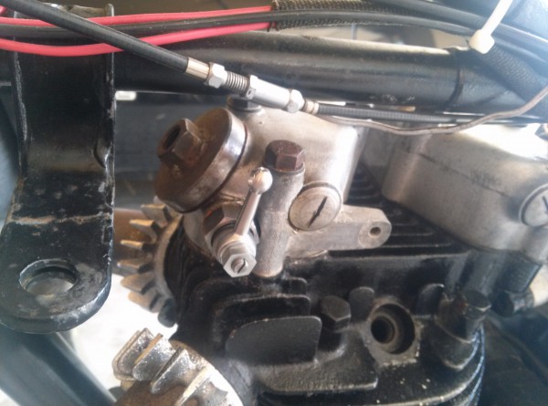

Thanks for the pics. As i thought, I'm missing the bracket that bolts to the cylinder head and hooks the end off the funky spring. Here's what i have!
Ill try to put some pics up of my current configuration

Heres my current setup. Im missing the bracket that attaches to the cylinder head. But, my trusty friend Steve has the bit for me. Thanks again steve!! Pints are on me!!
