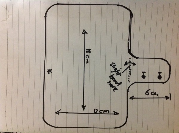

Well, one weekend...
It's just cut from thin plate steel.
All three bolts are to the guard. The top two bolt through the carrier bracket.
