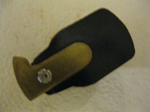

I have a question about rotor arm. In my SQ4 I have a distributor cap 400135 and rotor arm 404923 (on the picture).
I would like to know, which rotor arm do you use on your motorcycle and how important is the shape? I was told that for distribur cap 400135 I should use rotor arm 400052. As you can see on the picture, I have to find a new one.
There are many shapes of rotor arm, like 403866, 403865... and I'm not sure which one to use.

Hello Andrej,
All of the Lucas information I have states the DKX4A uses the 400052 and I can confirm that all three distributors I have, one is on my '51 (40124) the other on my '56 (40486), have the 400052 rotor.
Frank
Frank
- Posts: 5255
My '51 has a rotor arm like that 400052 as well.

I must tell you that this Red Rotor arm is the same I get from Draganfly, but it’s too small. You can see that from the picture in enclosure.
