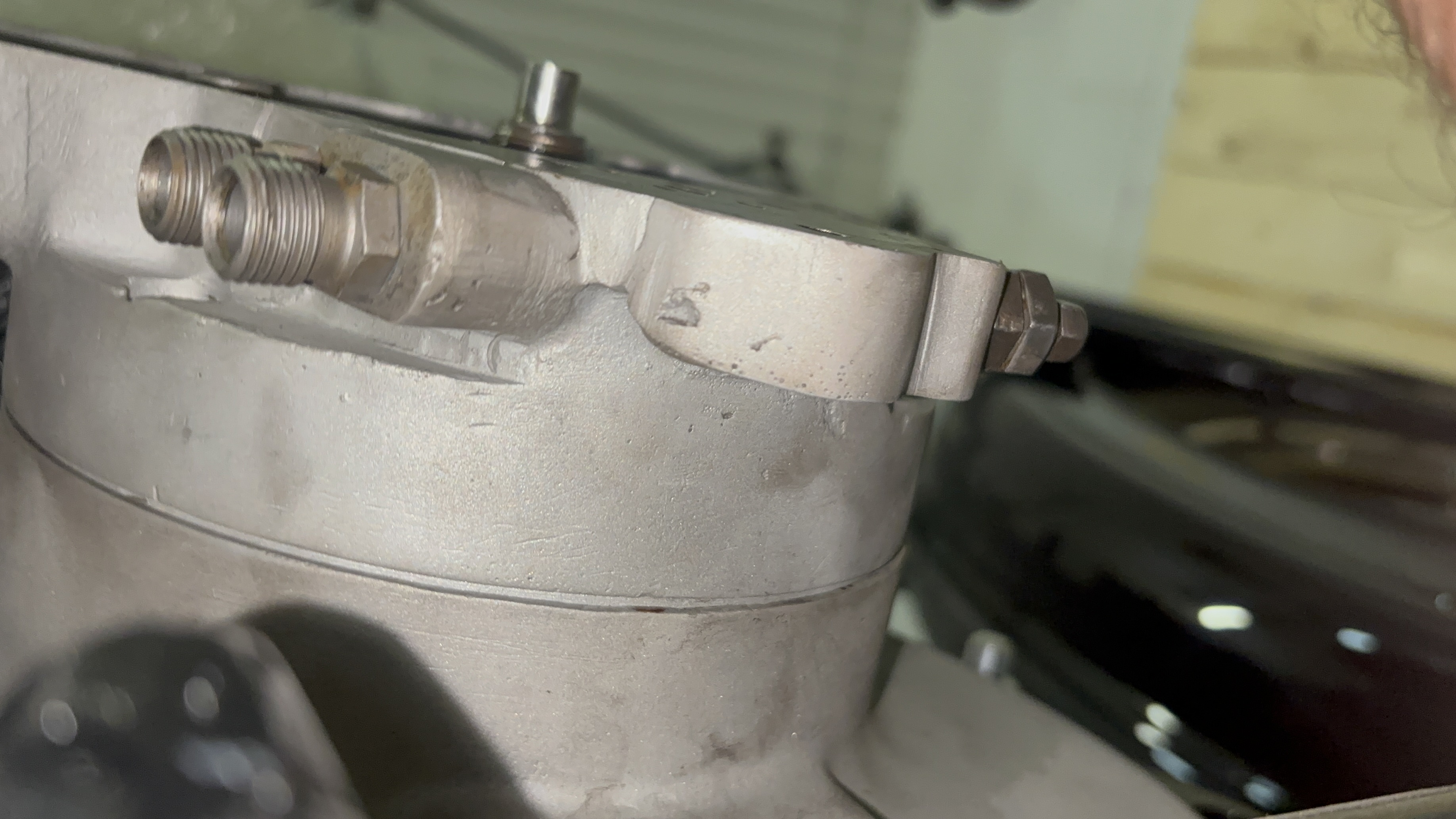

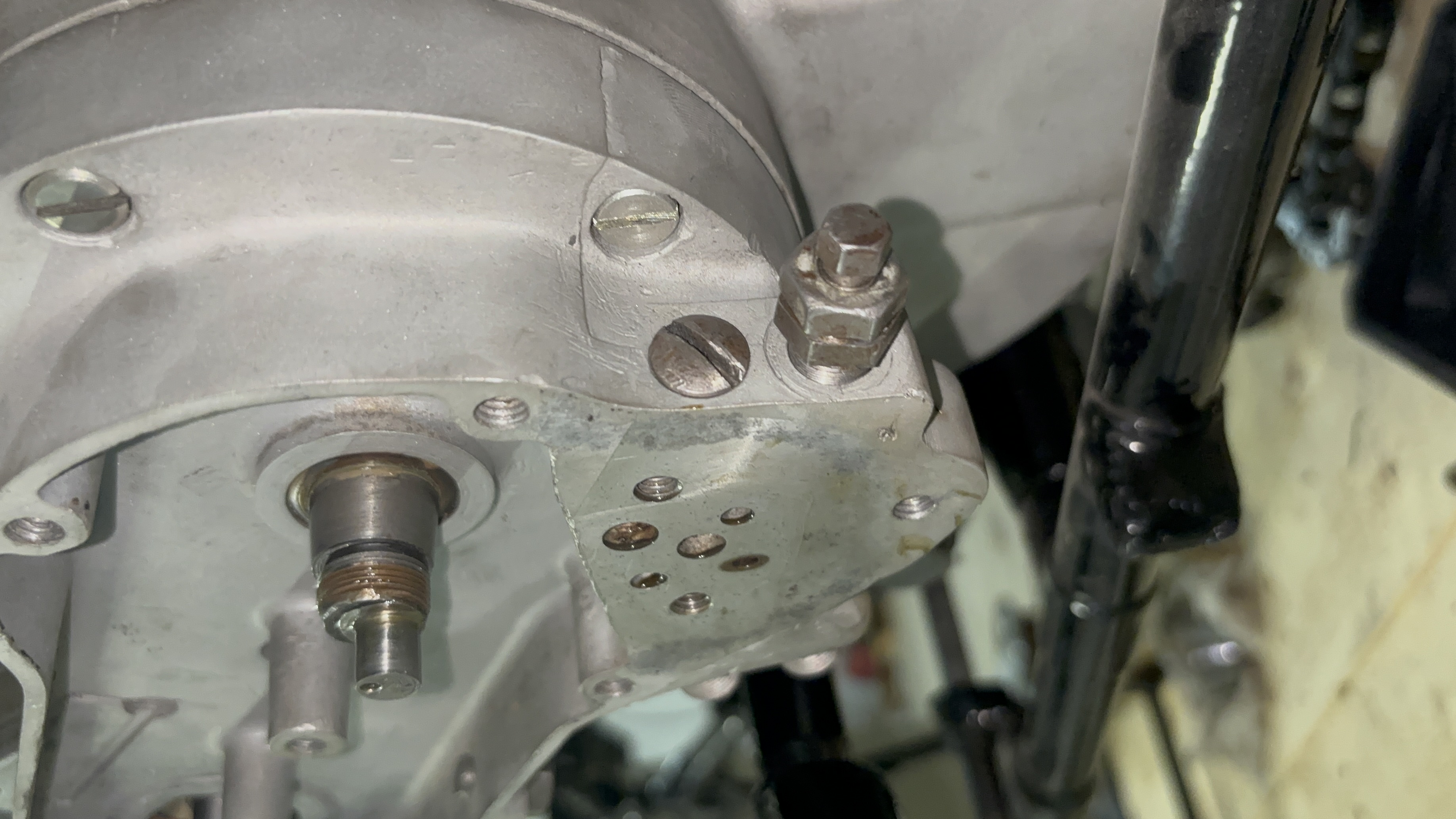

Hello, could you please advise about the oil pressure gauge?
I see no fitting for the tubing, even though in a picture i found before the restoration there was a pressure gauge, how did they connect it (if they ever did?

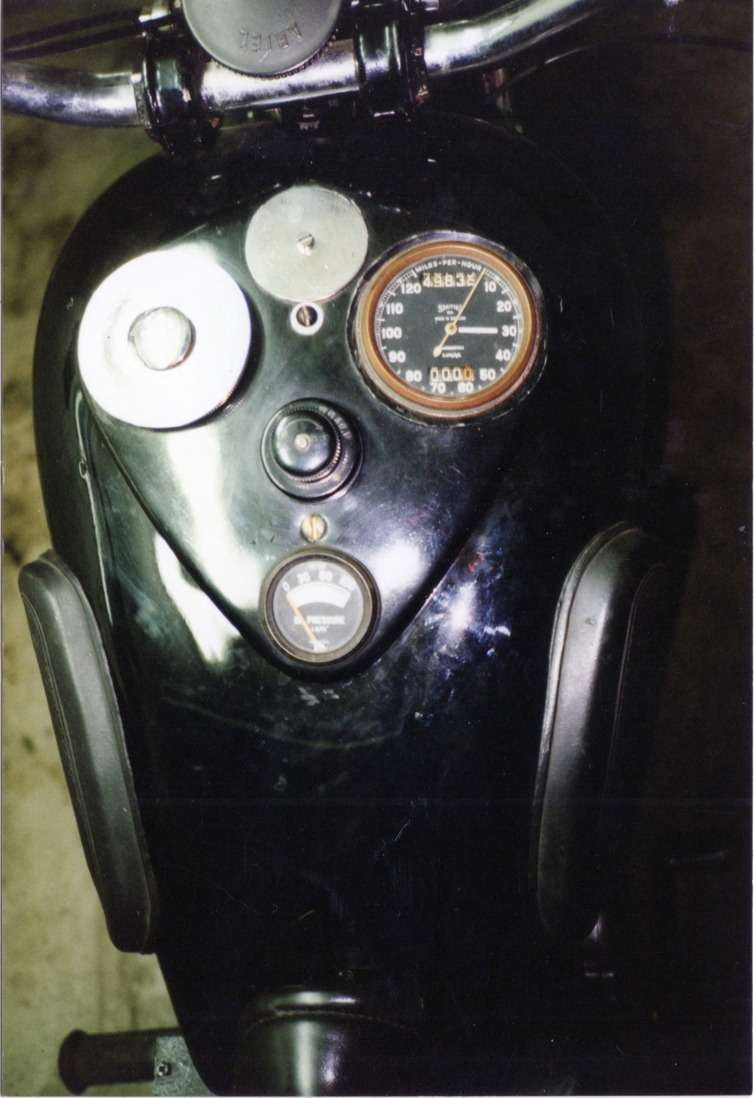

And the picture before the restoration
- Posts: 3212
Re: Project 1934 VG 500
Your timing chest appears to be missing the drilling for the pipe to the oil gauge. This may be because it has come from a W/NG model which lacked the oil gauge.

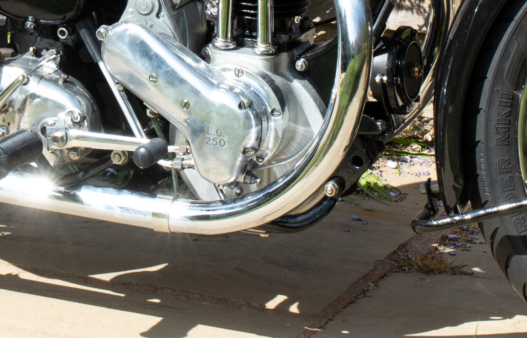

If you look at the detail photo of my 1936 LG250 you will see the location of the banjo union of the oil pipe, on the next flat below the oil pressure regulator. Whilst it is just possible such a drilling exists on your timing chest, it looks unlikely from your photos.
Thank you. I’m wondering if it’s easier and more sensible to drill and tap it, or to try to look for the right case and give mine to someone who might need it…
paul.jameson wrote: Sat Oct 31, 2026 8:45 am Your timing chest appears to be missing the drilling for the pipe to the oil gauge. This may be because it has come from a W/NG model which lacked the oil gauge.
