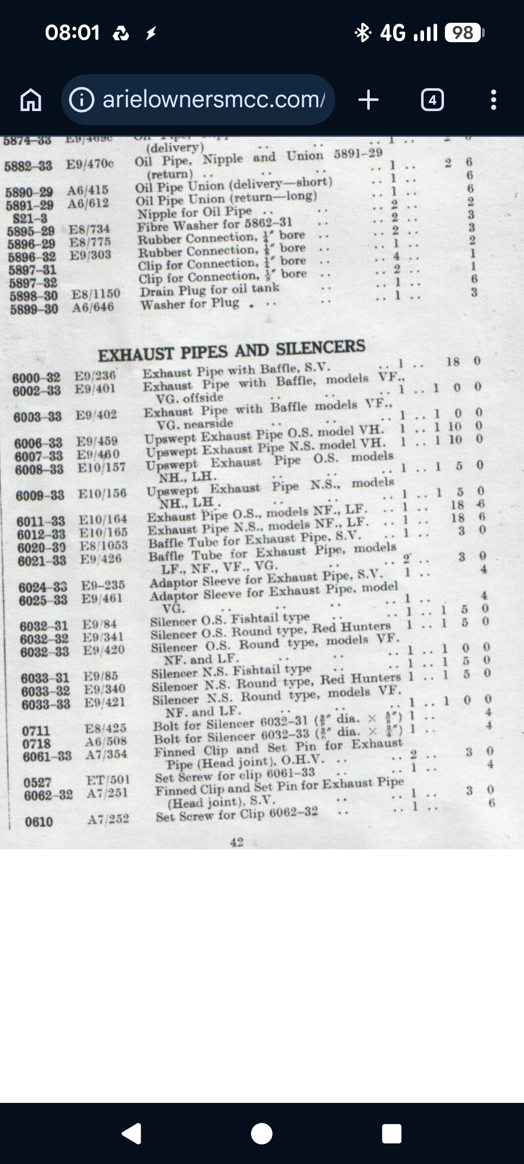

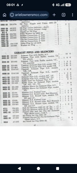

See the parts book for whatever year your bike is. It will either show ex pipes with baffles, sometimes as a separate part, in which case the silencers are empty. If no baffles are shown the silencers will or should be baffled.

6032-32 would seem to be the part number.
