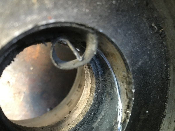

Re: Centre crank oil seal removal - help!!!
Post by Ivor Collins »
Center seal
Seal removal in progress!
Posts: 2120
I seem to remember that I used a small screwdriver blade hammered in between the outer casing and the case that effectively reduced the diameter of the outer so that something bigger could be used to collapse it.
