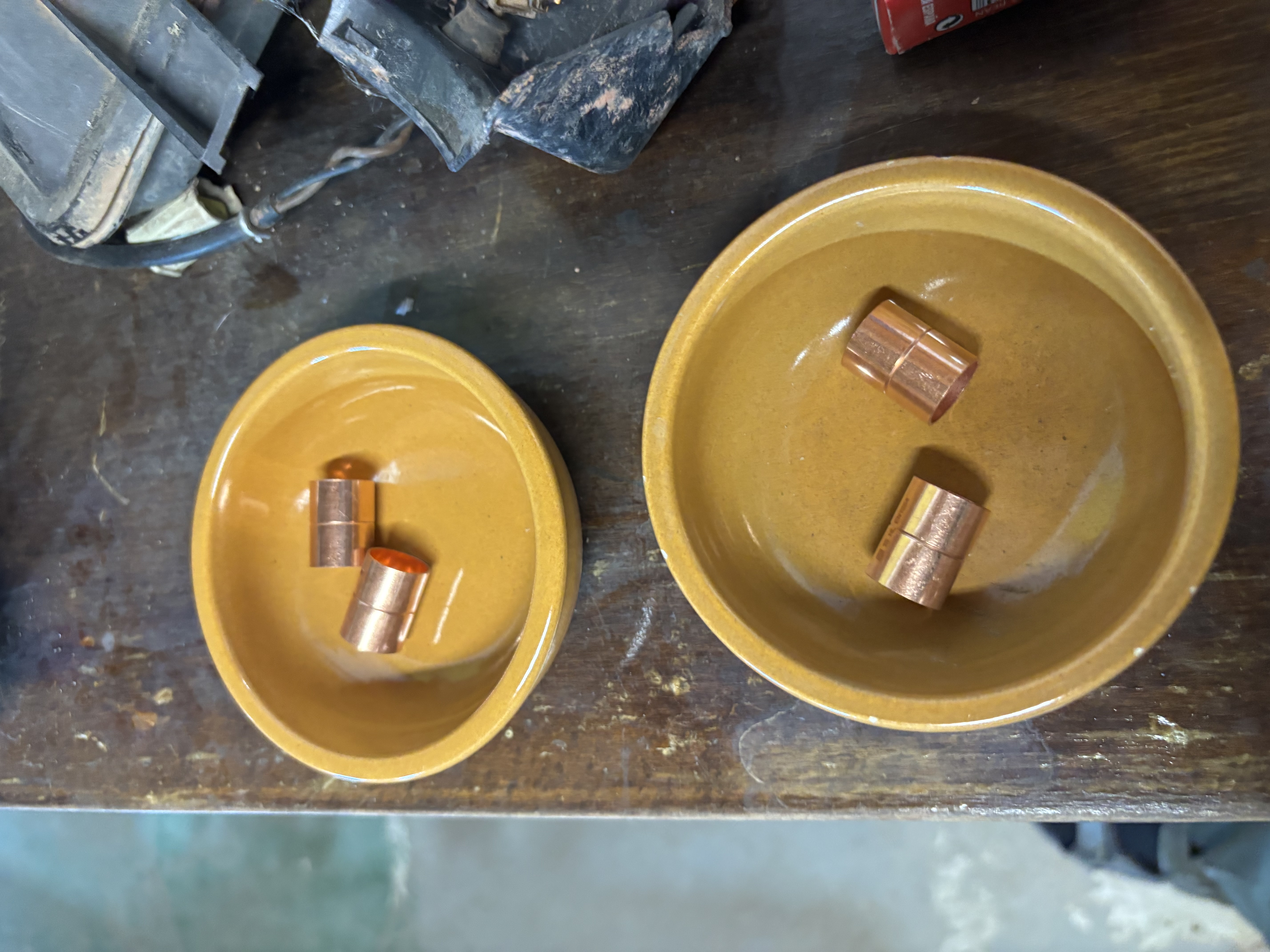

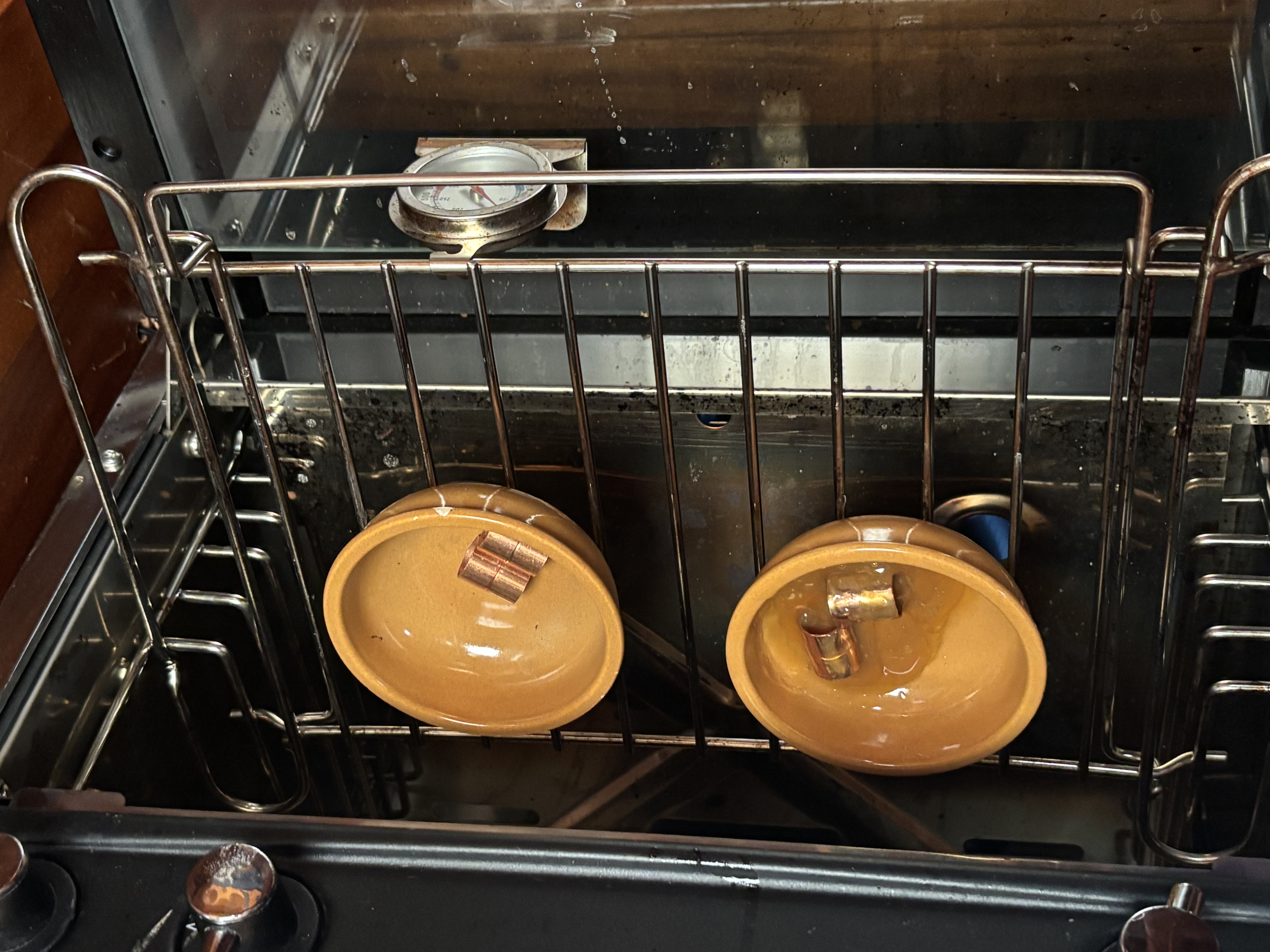

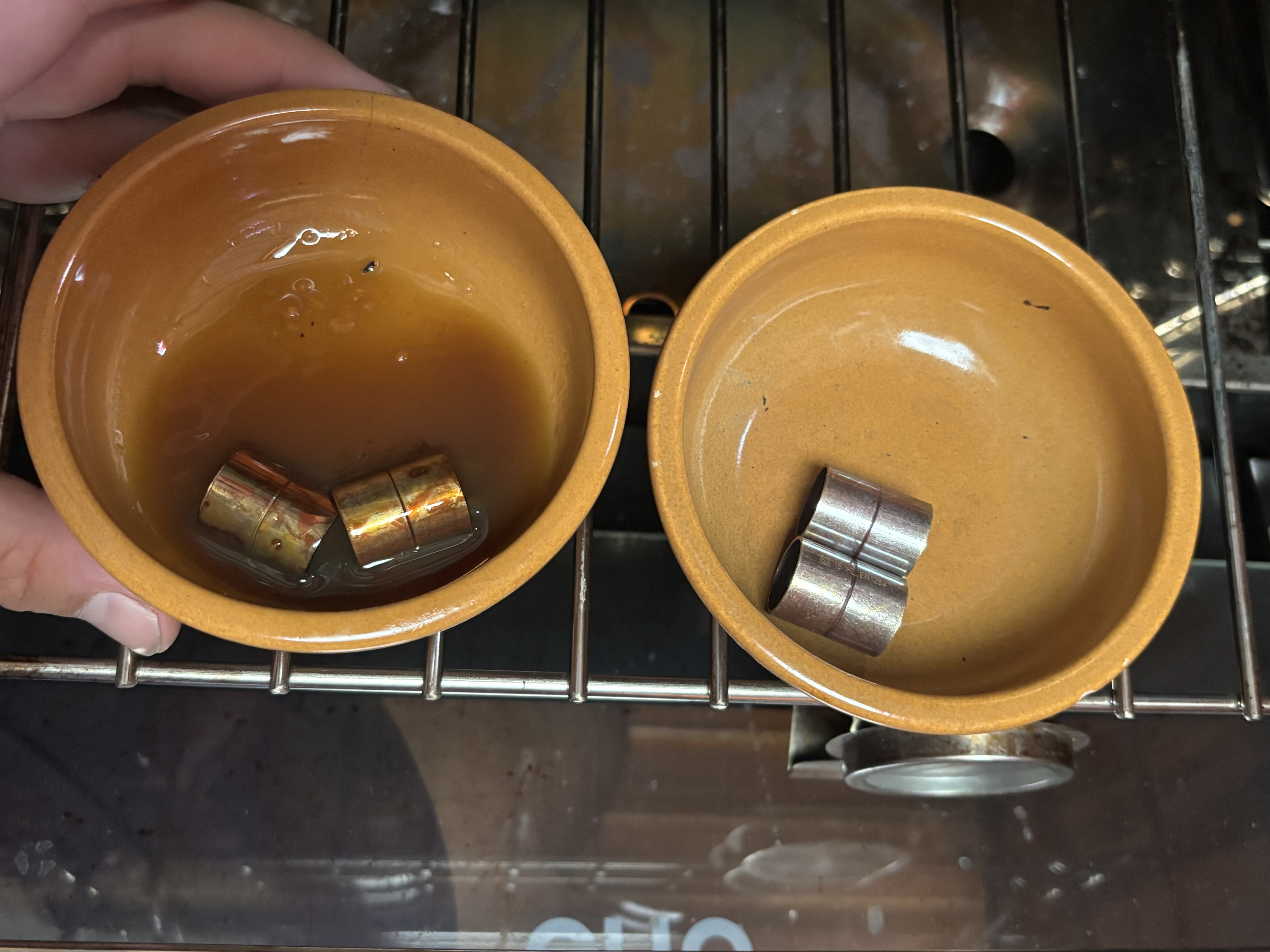

So, the corrosion experiment is officially under way.
However, the idea of putting grease and bits of metal in the kitchen oven at 100°C for several days was received at home with a rather ironic smile, so I took the hint and moved the operation to the sailboat, where i have a gas oven.
What I’m trying to imitate is the basic principle of the ASTM D4048 copper corrosion test for lubricating greases. In the proper test, a clean polished copper strip is immersed in or completely surrounded by the grease and kept at an elevated temperature for a defined period. Afterwards the strip is cleaned and its colour and surface condition are compared with a standard corrosion scale.
The point is to see whether the grease contains additives (particularly certain active sulphur compounds) that react with copper. A good result leaves the copper more or less unchanged or only lightly stained; a bad result can produce strong darkening, black or grey films, staining, and eventually more obvious surface attack.
I’ve used a piece of plumbing copper, which should be reasonably pure, and put it in the SIL GREASE L-EP 00 at around 100°C. The manufacturer actually states a copper corrosion result of Class 1 max. after 24 hours at 100°C, so in theory it should behave well.
The only slight flaw in the plan is that, being a gas oven on a boat, I’m not particularly keen on leaving it running unattended for 24 hours… so this may turn into a rather more hands-on ASTM D4048 than the standard probably intended.
I’ll keep heating it for as long as practical and see whether the copper shows any staining, darkening or obvious attack.
My partner remains unconvinced.

Interesting Albert. I wonder whether doing the experiment with Bronze instead of copper might get you a better result since Bronze sleeves and maybe shims are what is found in BA gearboxes?
Better result as in closer to real world use.

Hi Gary, yes, I had exactly the same thought. I actually tried to find the old gearbox bushes so I could test a piece of the actual material, but unfortunately I couldn’t find them.As far as I understand, the BA gearbox bushes were some form of phosphor bronze.
The reason I started with copper is that this is what the standard grease corrosion test uses. ASTM D4048 deliberately uses a polished copper strip as a sensitive indicator of whether the grease contains chemistry capable of attacking copper-bearing materials. If an EP additive contains sufficiently reactive sulphur to aggressively attack the copper component of a bronze, pure copper is actually quite a useful “worst-case detector”, because the copper surface is very sensitive to sulphur compounds. That is presumably one of the reasons the standard uses copper rather than trying to specify one particular bronze alloy.
So my plan now is to use the copper test as the first screening test, and if I can get hold of a suitable piece of phosphor bronze I will put that in the same grease under the same conditions as well. It will not make it a proper ASTM test, but for deciding whether I want this grease anywhere near an 1934 BA gearbox it should be a useful comparison.
For now i'll leave it there soaking for a few days.

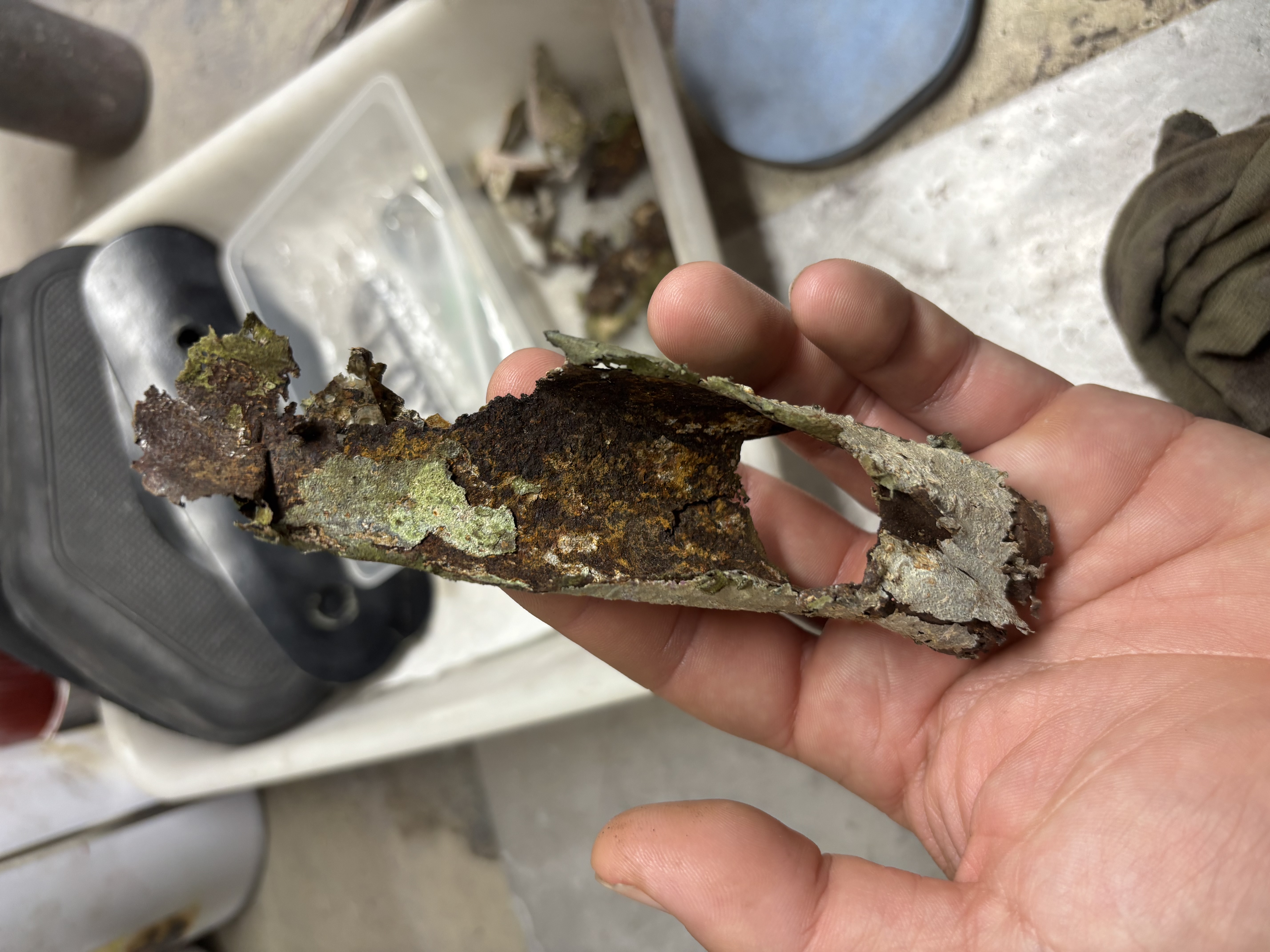

Sharing some more progress on the fuel tank, a HELL of a job. I managed to clean the tank inside with a cocktail of chemical chelants and weak acids. The tank was covered inside with some terrible pastes and some kind of tar.
I couldnt find anyone that would TIG weld a new tube in. Nobody wanted to risk with the level of corrosion and thinness of the metal.
So i went ahead with epoxy. Some will say it's a botch job but I swear that tube is not going anywhere.
Next step is to apply epoxy inside the tank.

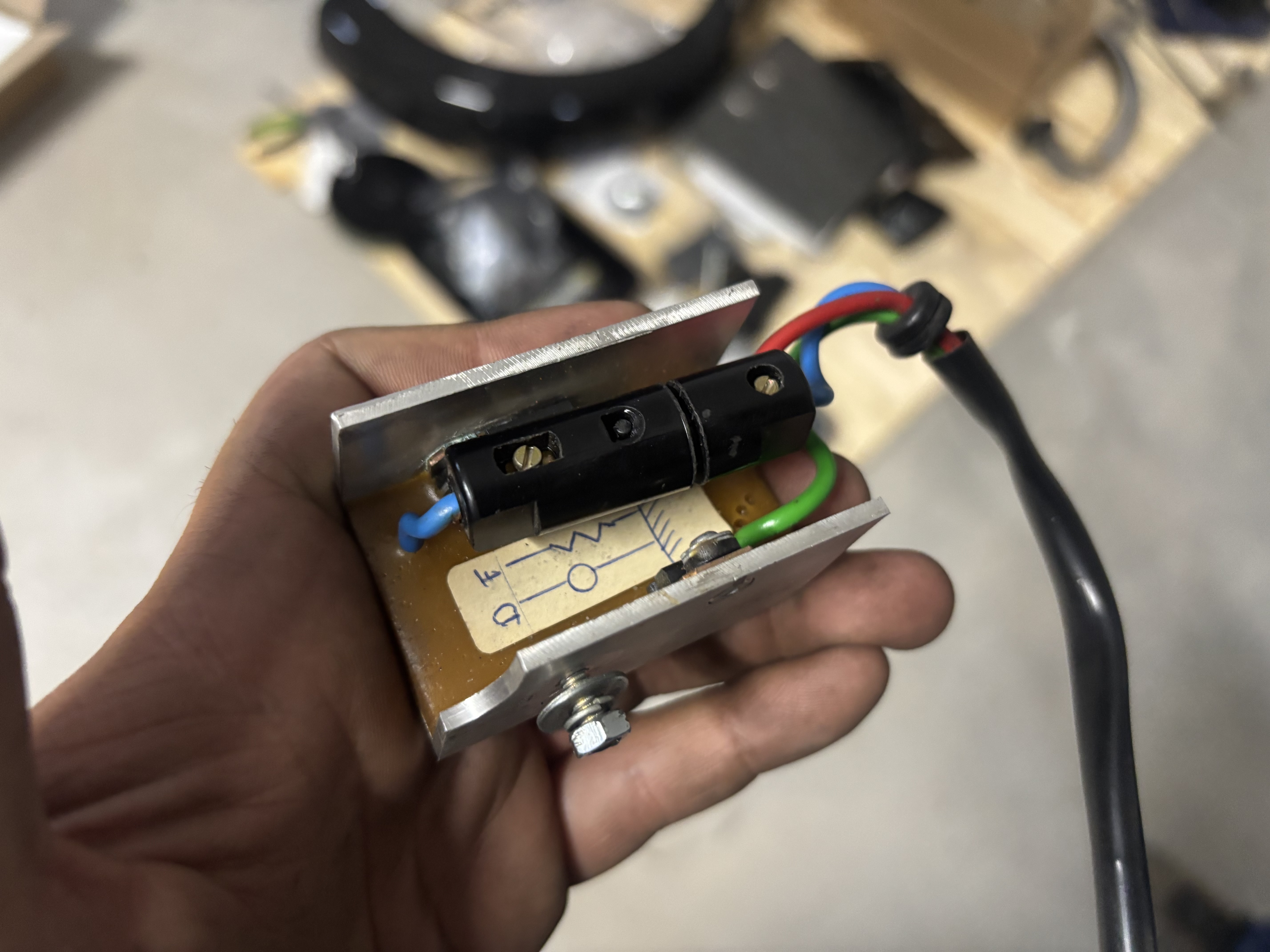

I found around the spares what seems to be an electronic charge controller. I don't like that as then could mean that the mechanical regulator is not working properly... so that will need some attention and adjustment too, when the time comes.
I'd like to keep the mechanical, Austin has a very similar one and after some tweaking and adjustments it works perfectly.
