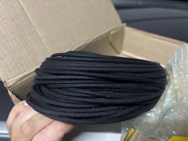

I also received already the cotton-braided cable.
So my plan now is to have a look at the gearbox, i need to strip it down to check if everything is okay (it should have new spares in there according to the previous owner) mount it back to the bike, and then get the magdymo timed up and prepare for starting the engine for the first time. It has been rebuilt, so i want to make sure there's plenty of oil in the system before attempting any startup
