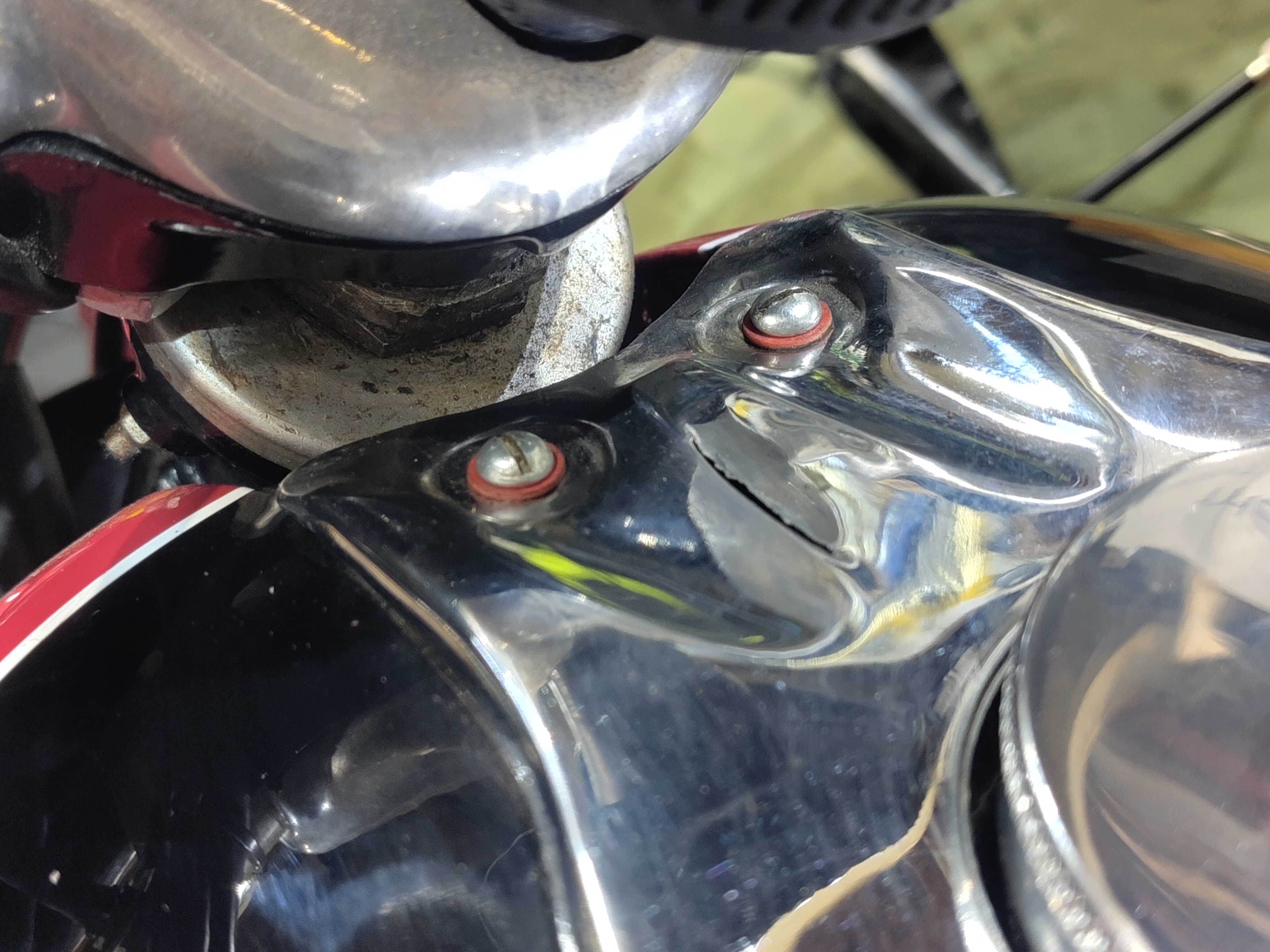

I'm at the Shere hill climb tomorrow, I'll be screwing the strip on properly today. Should've bought a new pair of the spire nuts, it will take a little bit of fiddling, but I shall take a picture later.

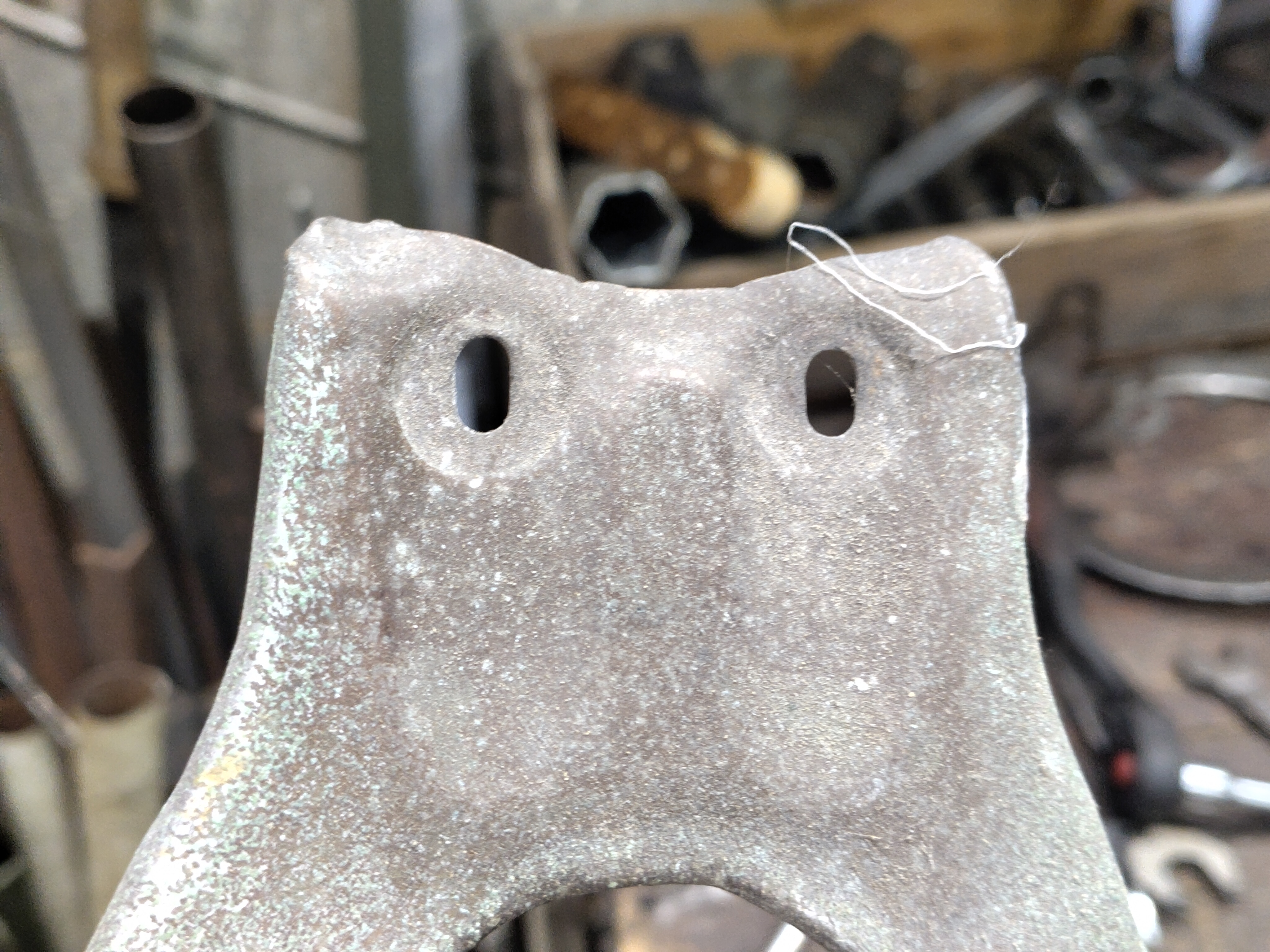

Two pictures as promised.
I've always thought the grotty one was original, but considering that the shiny one has been polished through, presumably for replating, perhaps they both are?
The holes are identical on both of them.

I would certainly use a washer of some description. Ariel did mention somewhere that to 'avoid needless repetition nuts and washers are not usually mentioned. Also with sheet metal items like this some allowance tends to be made to allow for a less than precision fit by the use of slotted holes etc. The recess around the screw hole in the strip is correct and does look rather odd as though there should be a washer with a large OD.
