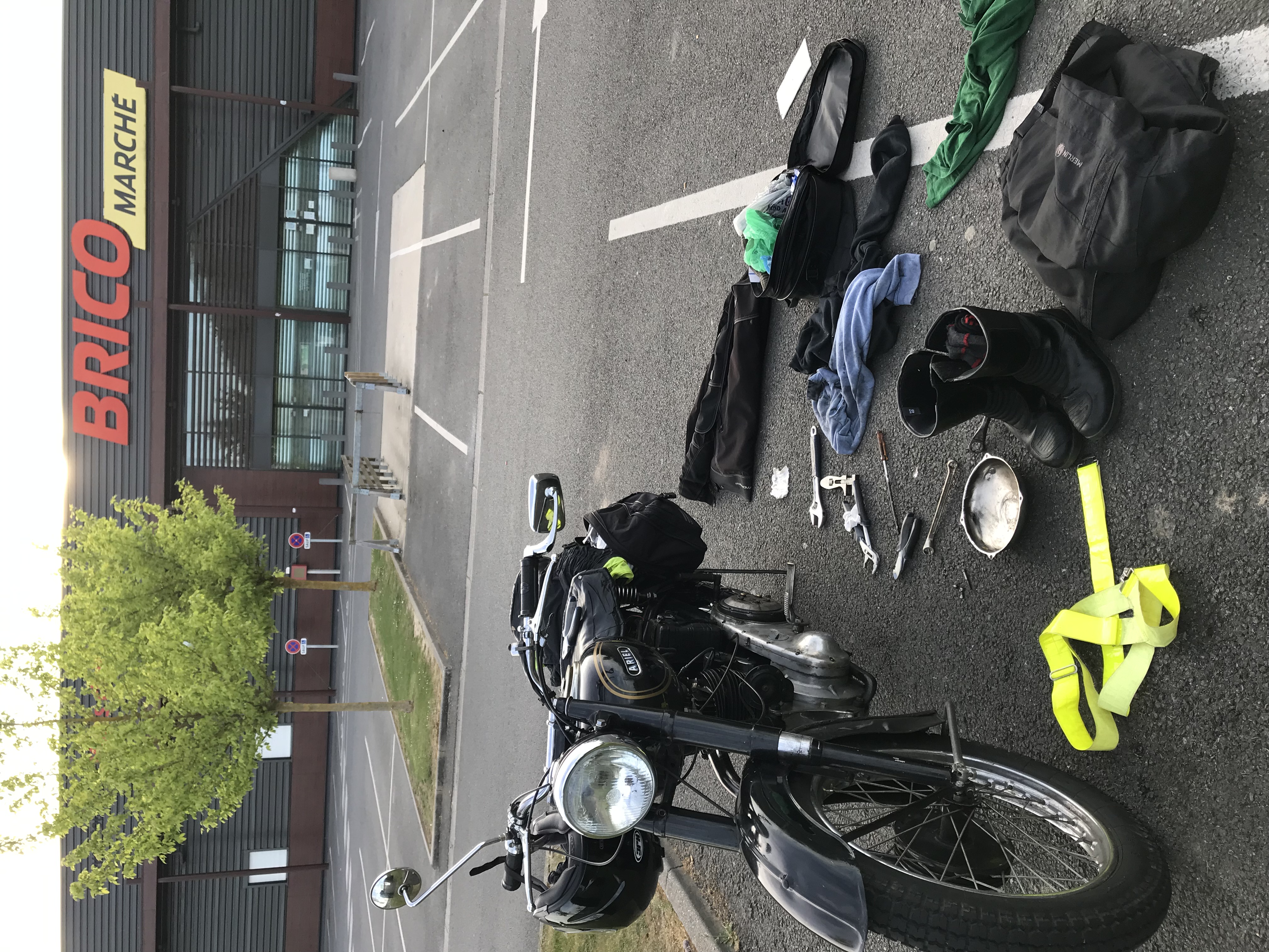

That was me in 2022 riding to Paris for Vintage Revival Montlhery that year. Ended up with the primary in bits on the floor after the bolt holding the inner to the engine came loose. Picture is just as I had got it all back together again. Took another four hours to get there, arrived midnight after a hairy no-lights blast along the motorwayMick D wrote: Fri Aug 21, 2026 8:41 am Hi
There is a tab washer that locks that bolt normally, I suggest you fit one if you are going to blank it with a bolt, last thing you want is a loose bolt in the chain case.
Regards Mick
