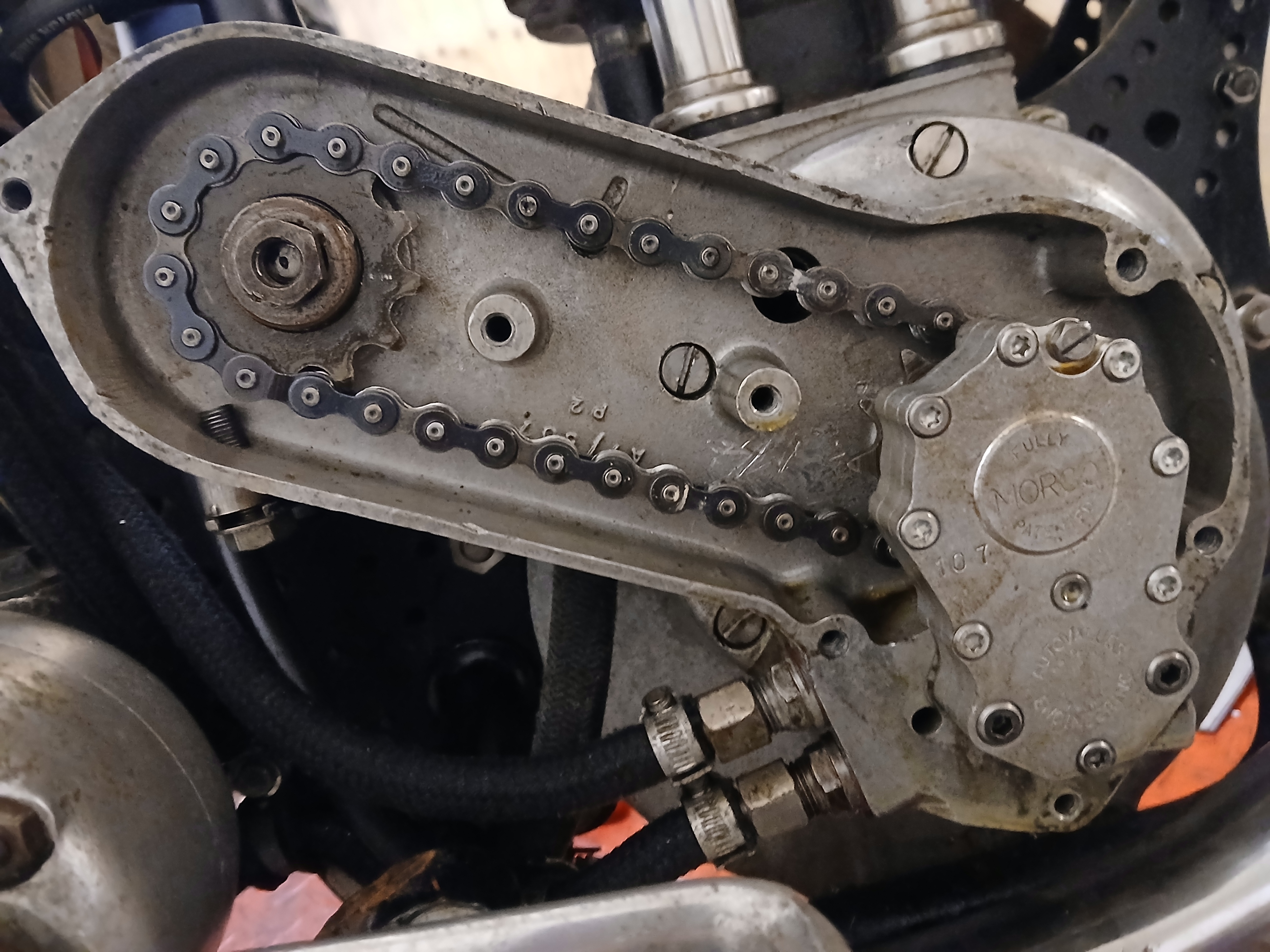

One item which escaped me earlier is that your cam has been modified by removal of the pin on the outer end which drives the oil pump. That tells me that you have a non-original oil pump with higher flow than the original Ariel item. This can be a good thing or a bad thing, depending upon the type of riding you intend to do on the bike.

Hello its another question. Iv never seen this bike running and iv since found the previous owner had not either, even though he told me he had.
With the thought he had ran for a short time with a squirt of bradex. As he had told me. I had assumed it was set up correct. So I went through the cam timing and point settings. With the excellent pdf files on here ..thank you
Im now ready to attempt to try to fire it up
It has at the moment no decompression fitted so Iv tied a string to the spark plug cap to stop it if I get lucky ..
It has this rather big looking oil pump instead of the pictures iv seen on here. Im very worried that the pump will work.
Is there a way of checking it works by perhaps taking the plug out and spinning the double nut on the end of the crank with a wizzy gun. Or is that silly
Im just very nervous about this potential start

As the label says, this is a Morgo pump that requires the eccentric on the end of the cam to be removed so not many pumps were sold. Also it is rather overkill on a single that will happily run for a few minutes with no oil circulating, providing there is some oil in the engine. As it has stood for some time it would be advisable to pour 1/4 pint into the sump via the rocker box cap. The pump may need priming but I am not sure as this is the first I have seen. The hex plug at the top could be to bleed air from the pump.
- Posts: 5229
Re: More questions than answers
I don't have Morgo pumps on my singles, but I do have one on the Mk1. As Roger says, I would suggest that the hex screw at the top is the bleed - it's in a similar position on the four and there is certainly no mounting point up there. With the engine stopped, just take it out, and if you have oil in the tank it will come out of there naturally. When it does, put it back in and the pump will work.Roger Gwynn wrote: Sun Aug 16, 2026 3:17 pm As the label says, this is a Morgo pump that requires the eccentric on the end of the cam to be removed so not many pumps were sold. Also it is rather overkill on a single that will happily run for a few minutes with no oil circulating, providing there is some oil in the engine. As it has stood for some time it would be advisable to pour 1/4 pint into the sump via the rocker box cap. The pump may need priming but I am not sure as this is the first I have seen. The hex plug at the top could be to bleed air from the pump.

It seems the top flat headed screw was the bleed screw I had a little fibre washer on ,I pulled it out and let the oil flow for a couple of mins

Ah yes, a Morgo rotary pump made for the Ariel single, somewhere in the late eighties if I remember correctly.
Been there , done that and learned about it....
The Rotary pump made before Morgo made a larger version of the plunger pump.
That later larger plunger pump ( I believe still on sale ) also still delivers to much oil, stick with the standard Ariel plunger pump.
Waste of time, money and with that rotary pump, it destroyes a good cam .
It may look like a worthwile modification but on a roller/ball bearing engine you dont need much oil or pressure as Roger already wrote.
It deliveres way to much oil in to the engine causing it to drag, take it off and find a standard cam.
