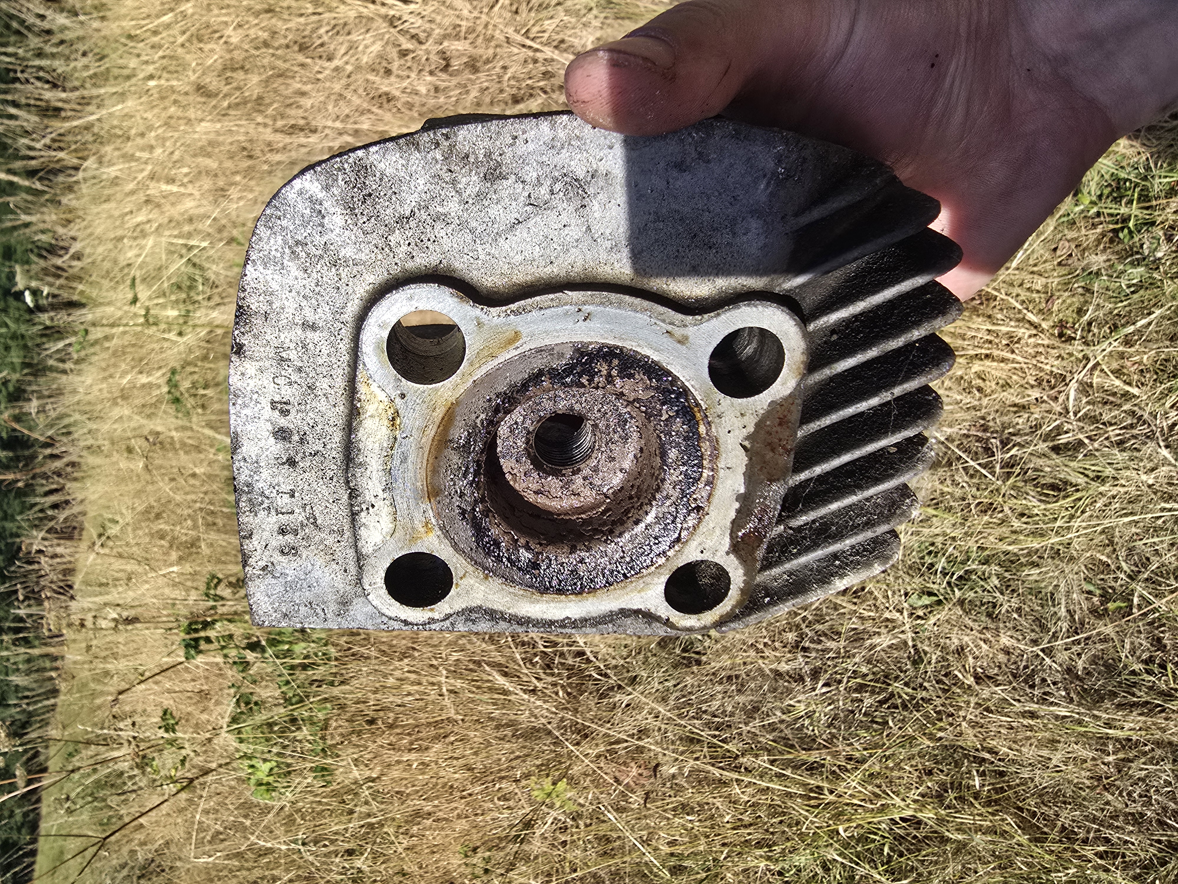

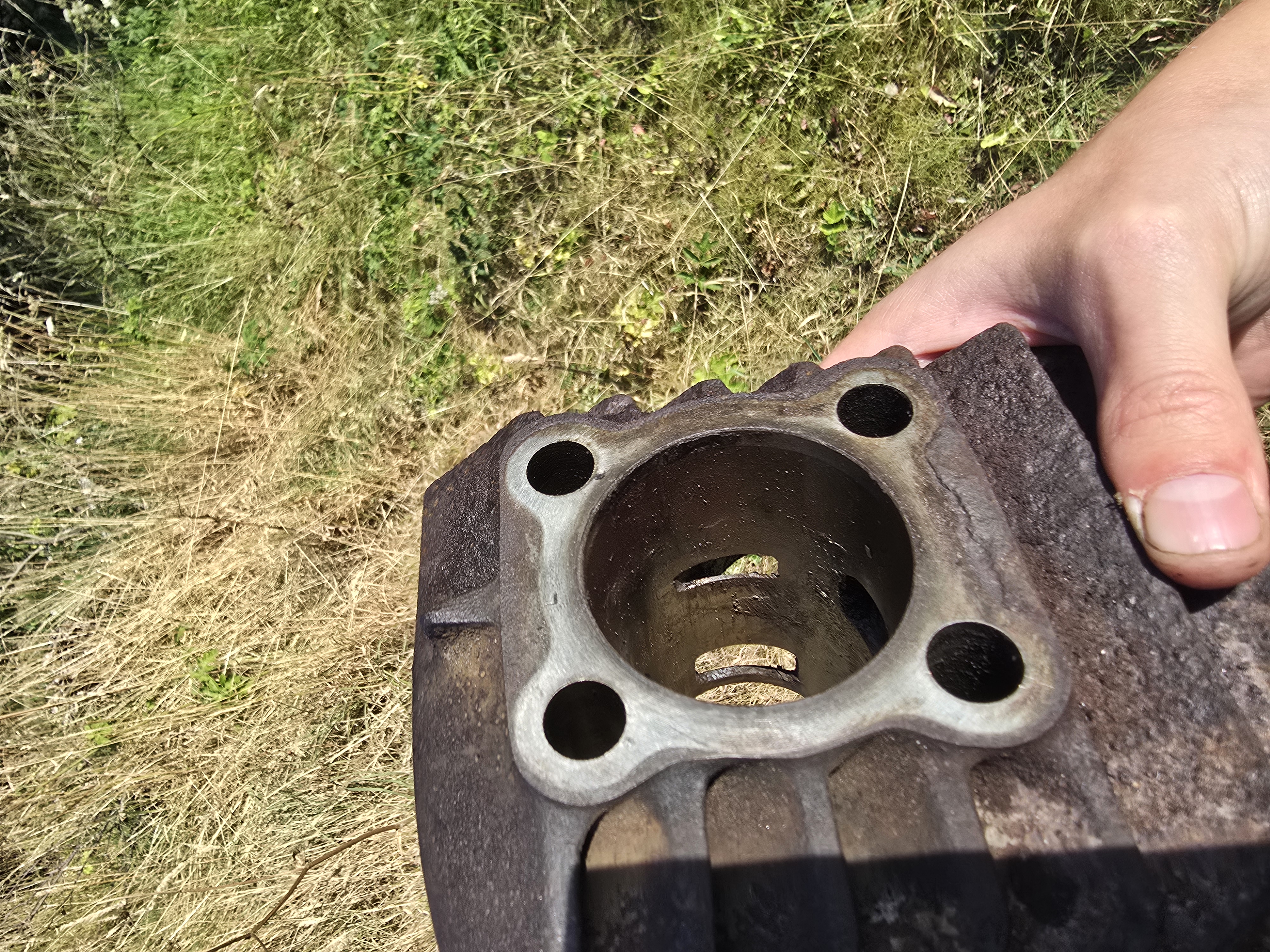

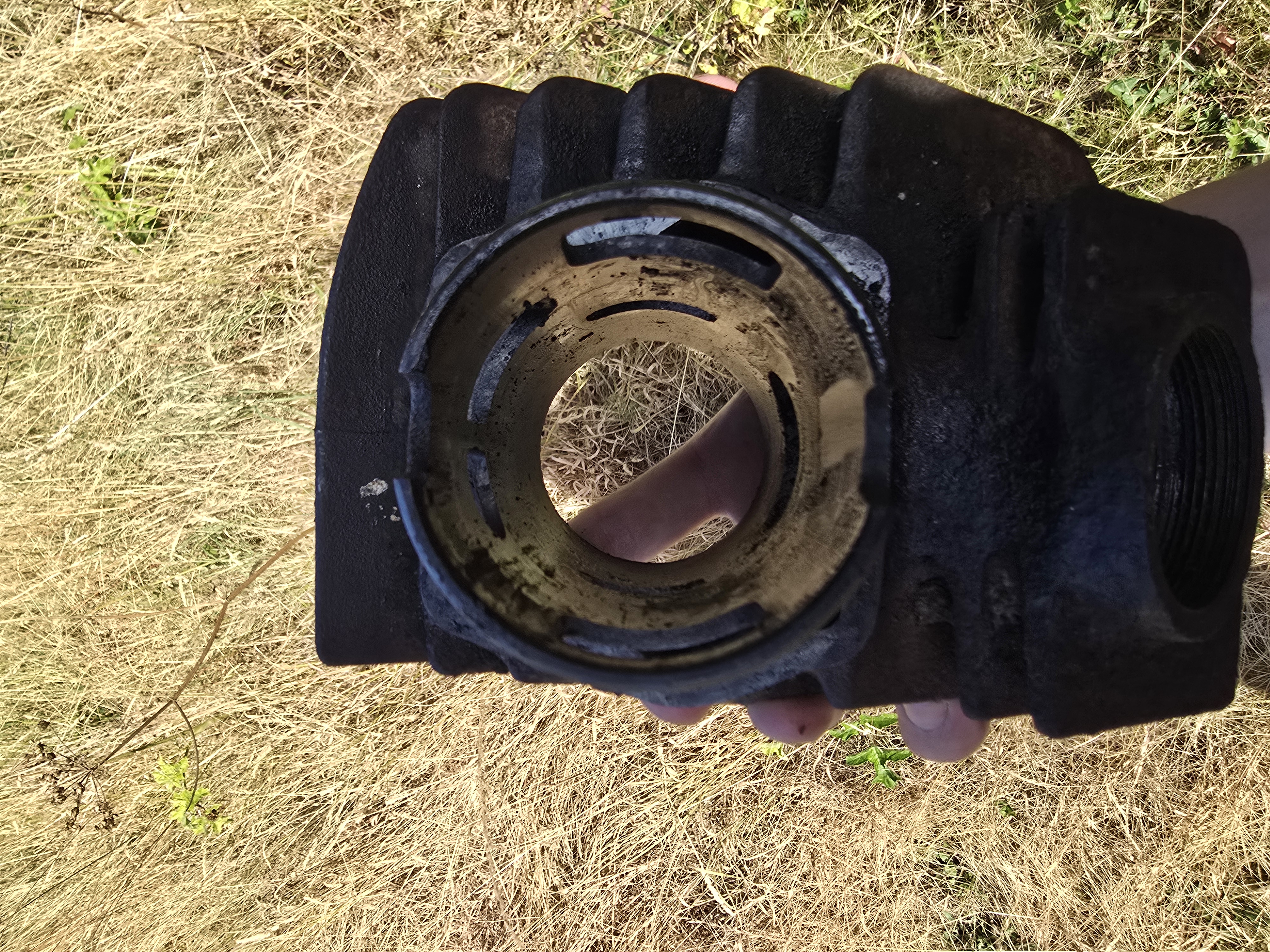

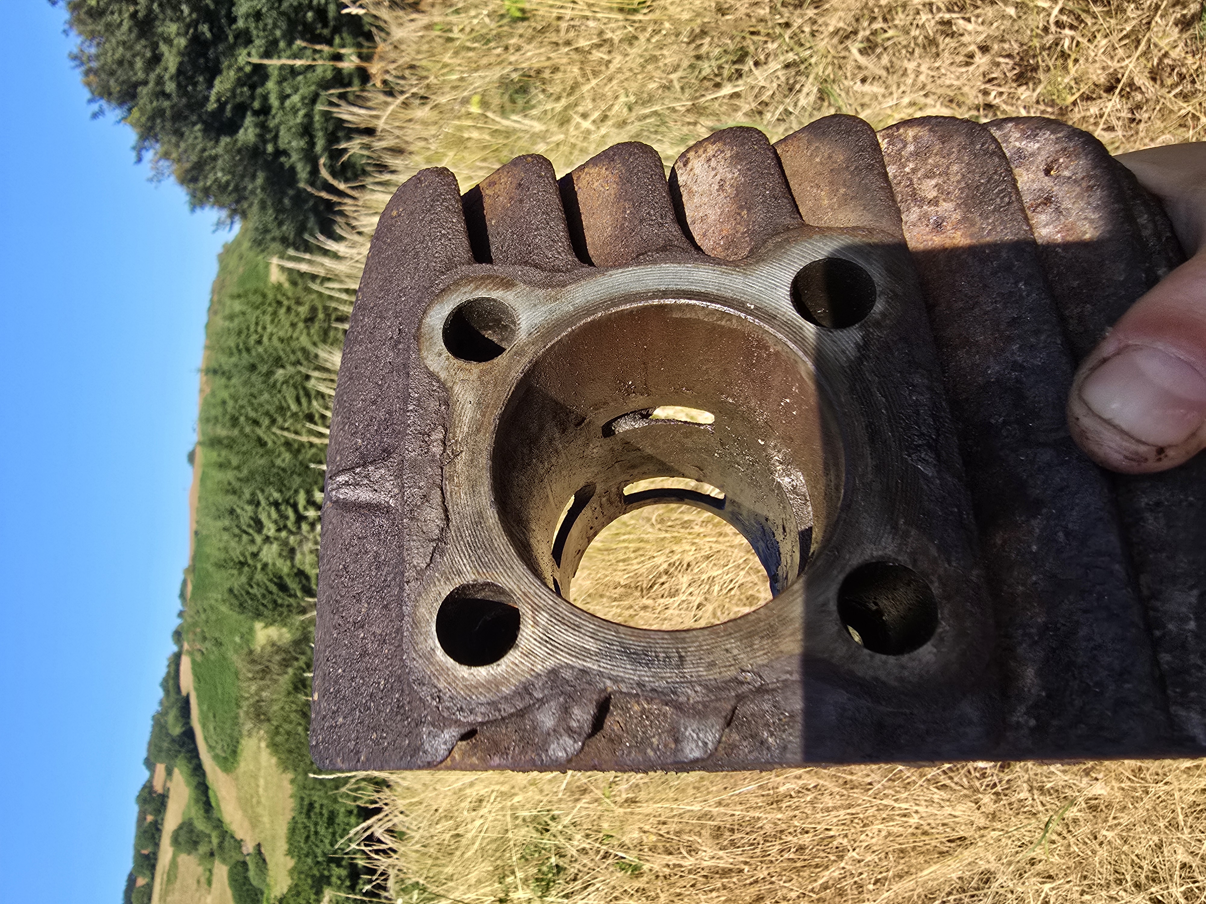

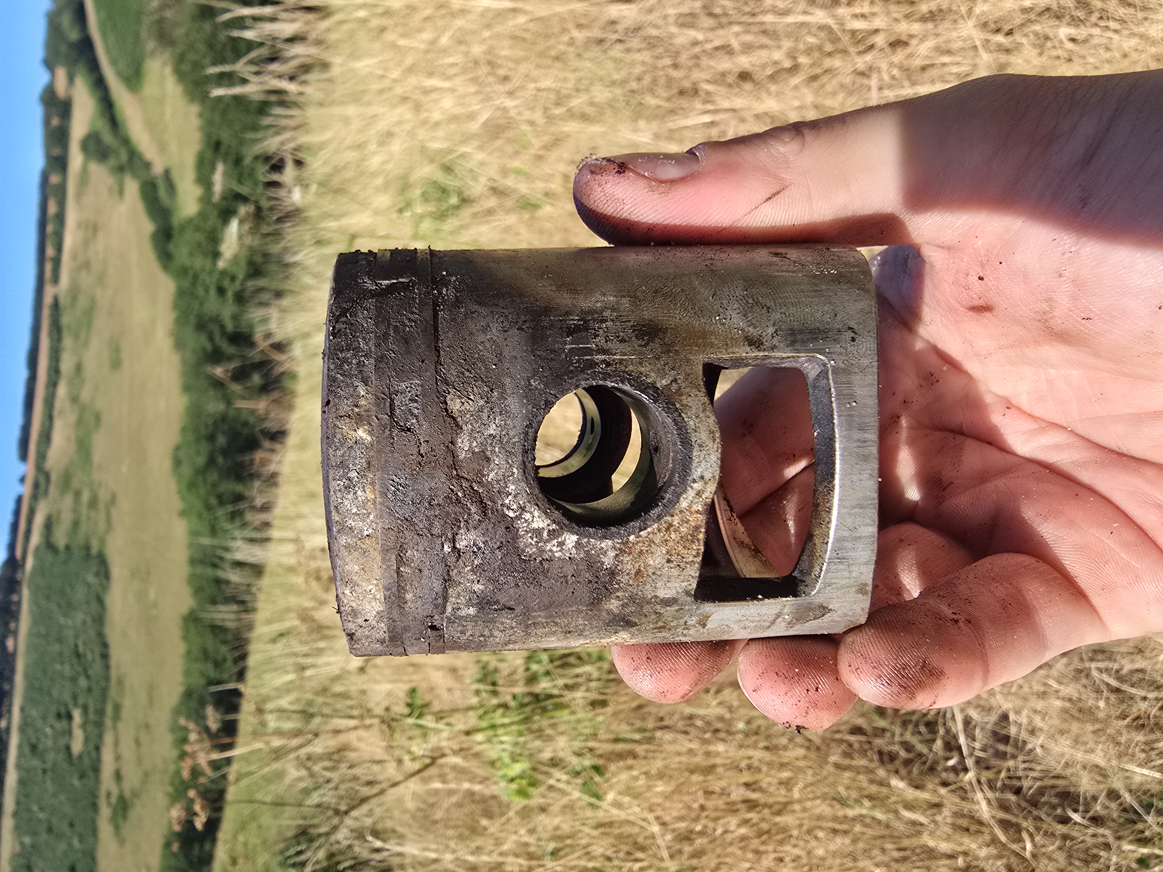

Anyway, i would like to ask for some advice to someone whose not worked on these bikes before. I have pulled the barrels off and removed the pistons with some effort. I have attached some photos below. Is is possible to just rehone these barrels as there isnt anything to catch a nail on, just surface rust and dirt? Or should I just get them bored. Measuring them, they are within spec. There is also a little section missing on the right intake of the right barrel, i believe its just a void in the casting but would this be an issue. Also, the pistons, are they salvageable. From my work on 4 strokes previously these would be manageable with some elbow grease but i understand tolerances are tighter for 2 strokes.

Difficult to tell from a photo but the cylinder appear to be badly rusted. The pistons do not look bad and if the rings can be freed off should be OK. First step would be to give all the bits a good clean!

I think they look salvageable, start by cleaning the bores gently with wire wool and solvent/petrol, if they come back the rest should follow.
Don't be too critical of wear and finish, it's very easy, (and expensive), to go down the restore everything to as new rabbit hole.
Good luck Mick

Fit old spark plugs into the heads, turn upside down, support to get heads level, fill combustion chamber with white spirit & leave to soften carbon deposits. Ditto pistons. When cleaning the barrel bore, work in a round & round motion, not an up & down motion which could leave an escape path for compression

I concur with the advice you’ve had to salvage without rebore and to reuse pistons.
You’ll probably have some piston slap noise when cold, don’t be alarmed by it, the sound reduces when warm and at least it won’t seize up as many newly rebored engines do
. And, if at a later date you decide to go ‘the whole hog’ and do the rebore, it’s no big job to revisit.
The difficult job will be unsticking the piston rings. You’ll probably end up with some broken rings with which to scrape the ring grooves clear of corrosion before fitting the new ones

Those rings look like they have partially moved when they came out of the bores, if so, soaking in a good penetrating fluid, (I use ATF mixed 50:50 with acetone), whilst gently exercising the rings by compressing them with your fingers will get them moving. I wouldn't expect to break them.

' You cant realistically resleeve barrels like those. Two stroke pistons are not oval . Usually just tapered about .003" Three thou smaller where the rings are. Never bore unless you have to. Scrape the hard carbon where the rings stop and measure the wear. 2 strokes are only marginally Oiled and iron barrels don't cool as well as alloy with Nikasil coating on the bores on later stuff. Silicon in the Piston material reduces expansion rate. Forged pistons need more clearance to prevent seizure, which you certainly do not want. Remove ALL carbon in the ring grooves carefully so as to not damage the ring lands.. Nev

Thank you all very much for the useful replies. I have been working on the pistons and barrels on and off for a few weeks now. The pistons have cleaned up really nice, rings grooves are clear and nice shiny aluminium all over and then coated with ACF50 to prevent corrosion. Removing the rings i discovered that i have a dykes ring piston, personally i see nothing wrong with this but am interested to see others opinions.
The bores have also come up quite nicely. All the rust has come off and no pitting is seen inside the cylinders. The sealing faces are clean and still have the original grooves. I did find that the pistons showed a +20 thou on them that i believe was done by my dad.
I have rehoned the cylinders also to put a light hatching on and remove a couple of burs i found on some of the ports and even out a small nick in the bore, it no longer catches on a fingernail.
