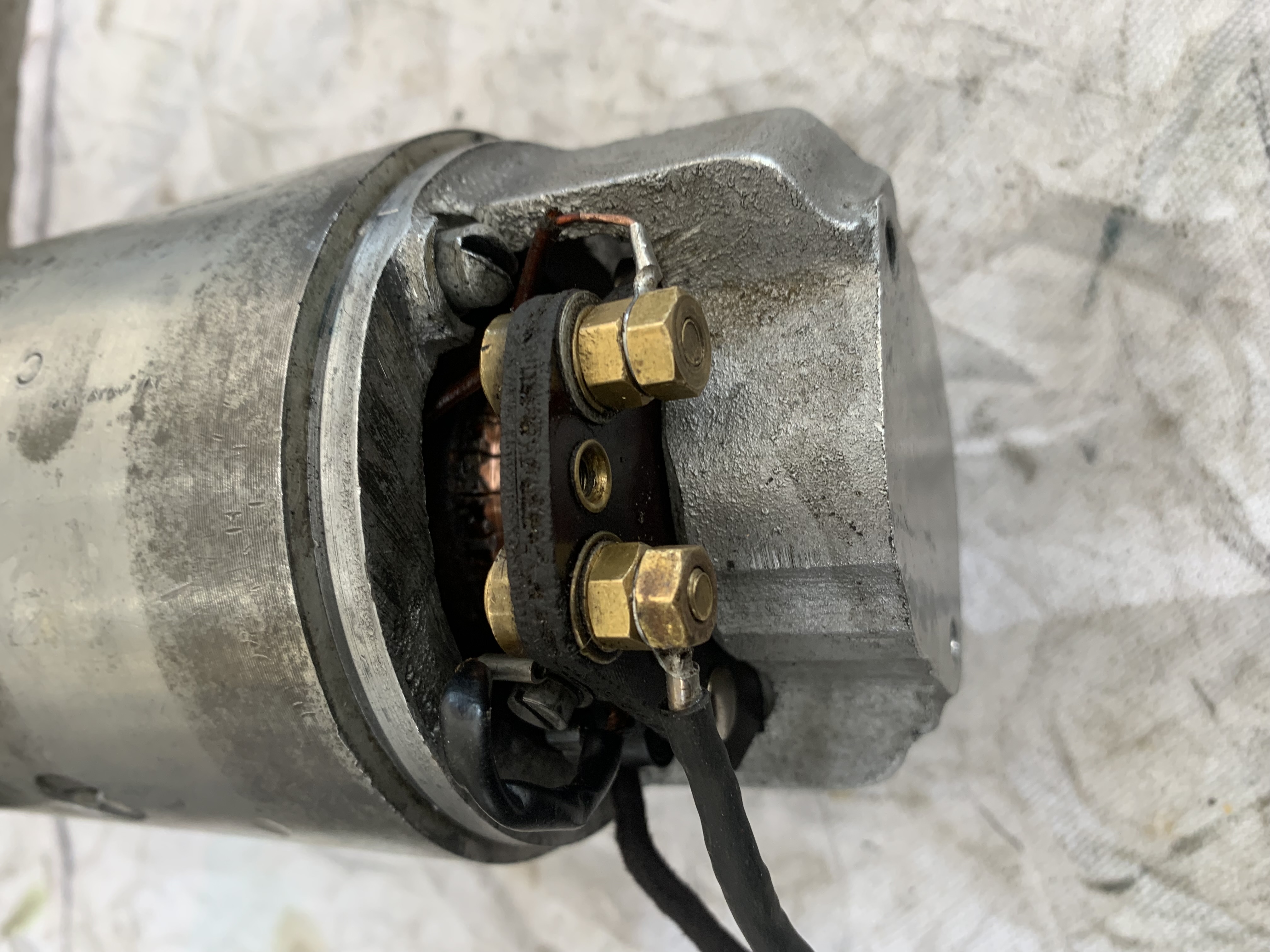

Sincere thanks to all that have offered advice. Having just dismantled the generator ( again!) I think the internal wiring may be the issue. I have posted photos but to clarify, The F terminal wire goes directly to the coil, the other end of this coil is connected to the second coil. The wire exciting the second coil is the wire going to the D terminal. One brush is connected to ground, the second brush is also connected to the D terminal. This is how I got the bike, the only item I have changed is to convert the 2 bullet type connectors to nut and bolt terminals, rather than solder/unsolder the F terminal every time it is dismantled. This does not match the advice from Simon, so I am assuming this is wired incorrectly? Hopefully this is the answer. Thanks.

Have a close look at this...
Re: S35 generator
I would try connecting the wire from the coil, (not the F wire), to ground or to the other brush, (not the one connected directly to D)
Regards Mick
Regards Mick
Chris Sealy
- Posts: 165
- Location: Warwickshire
Re: S35 generator
As Mick says, The Field coil wire; which looks to have been extended; should not be connected to the D terminal. It must be connected to the body of the dynamo. I believe that this is your only problem.
One of the brushes is earthed. You could connect The Field wire to the same point.
