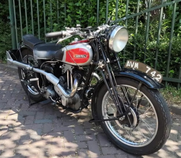

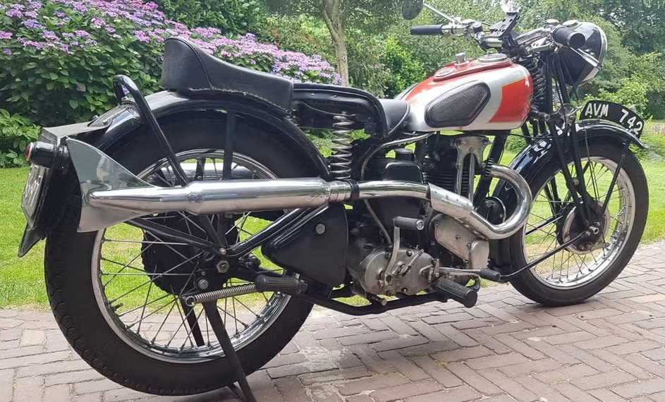

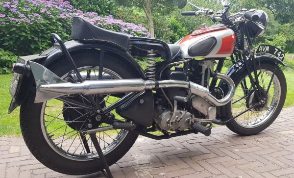

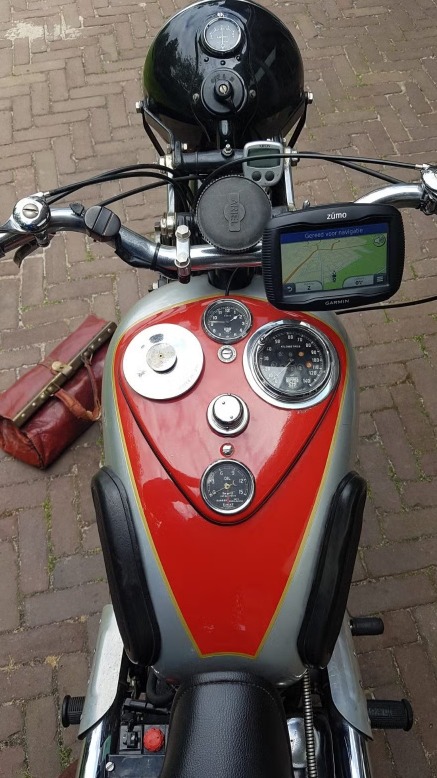

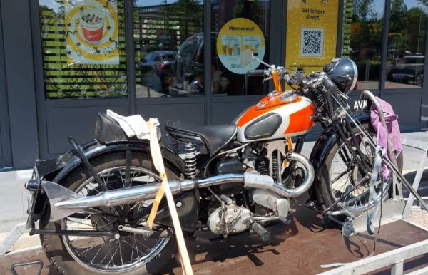

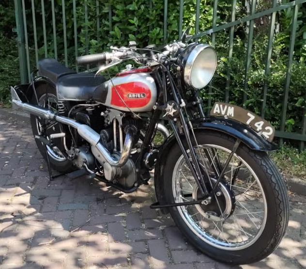

Painted tank instead of chrome - missing lower rear chain guard - Altette bracket :lol: - 19" frontwheel should that be a 20" ? - toolbox Ariel ? - some of the mudguard stays look DIY - folded handlebar levers - looks like a earlier tin prim.chaincase or the alloy one has been painted black - For that asking price: ask for frame & engine numbers to verify.
