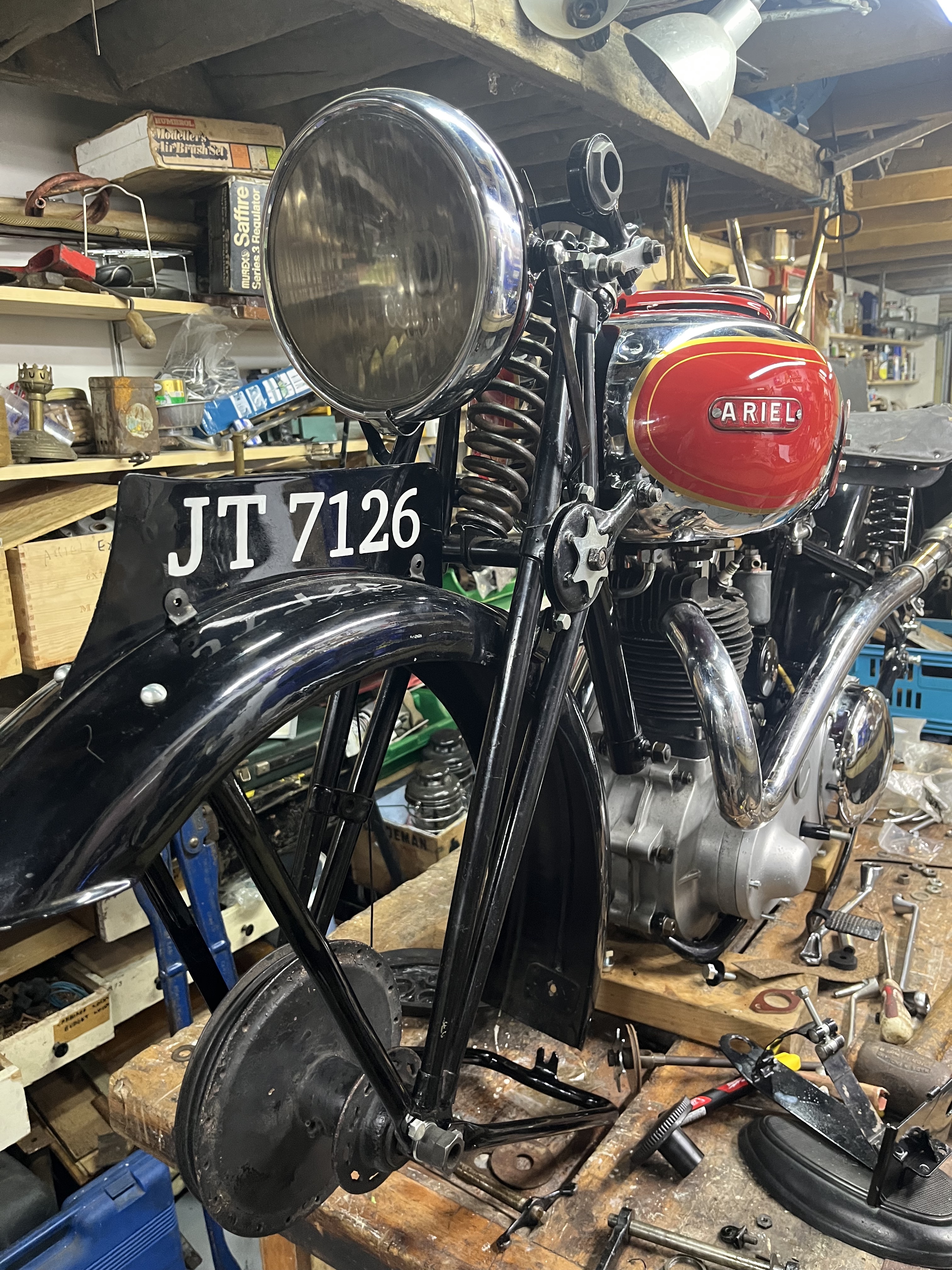

Could be that the tank rubbers under it are a bit to thick.
Or/and you need to make a small half moon cutout where the stem/steering damper meets the handlebar bracket.
Is it a original bracket or one from Karol ?
see pic :

Hi Vincent, i have the short tank rubbers now. I tried without but still touches. The bracket is from Karol.

Apparently when you reverse it, it gives enough clearance..

That is looking splendid ! Congratulations !
