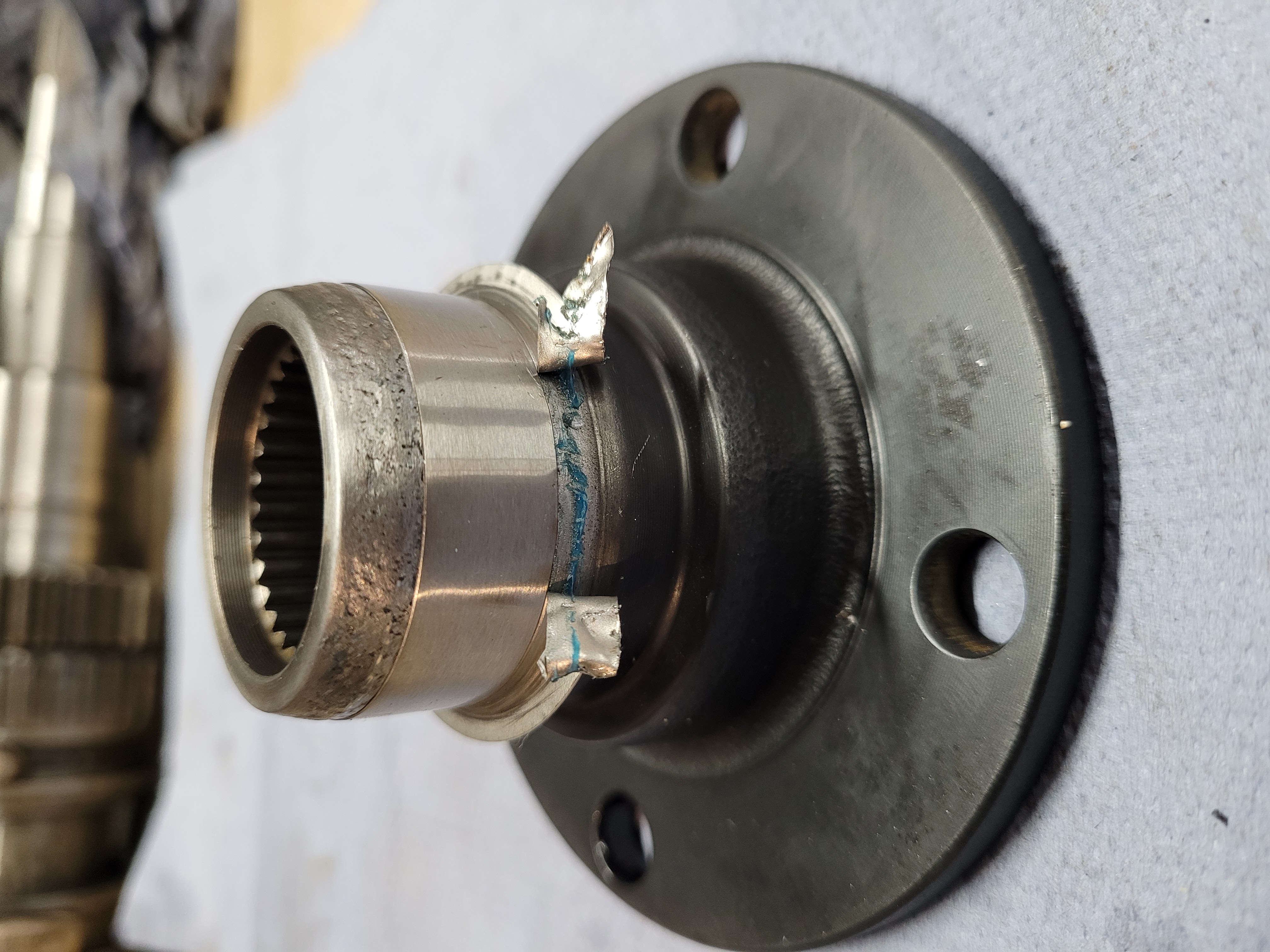

Did you make the crank bushing yourself ?
I have recently repaired a pair of drive flanges from a Toyota Landcruiser where the oil seal had worn a deep Groove in the bearing surface (the oil had escaped and mud had got in !).
I used SKF Speedisleeves, they seem to work well but are not recommended for engine components. What material are your bushings made of ?

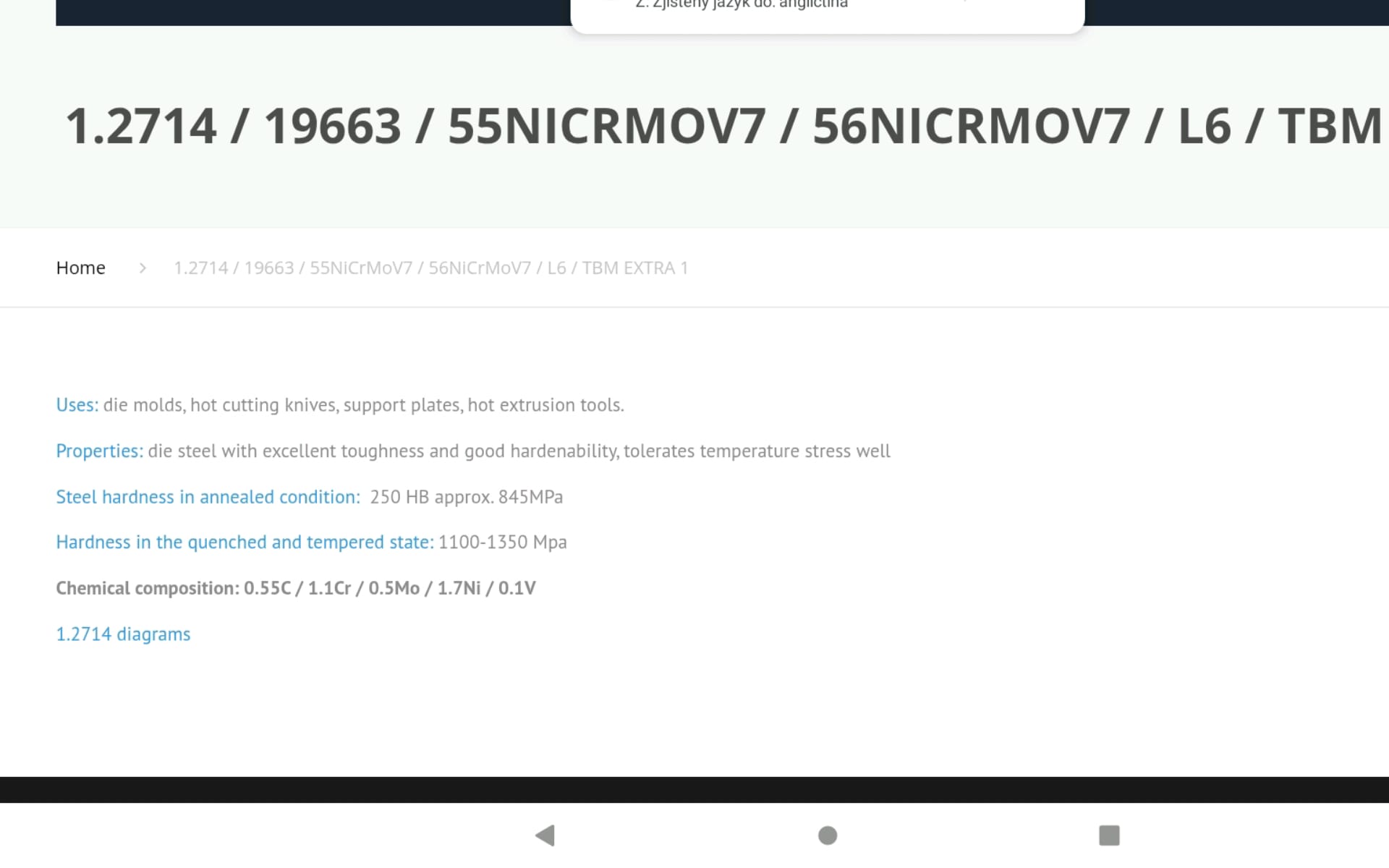

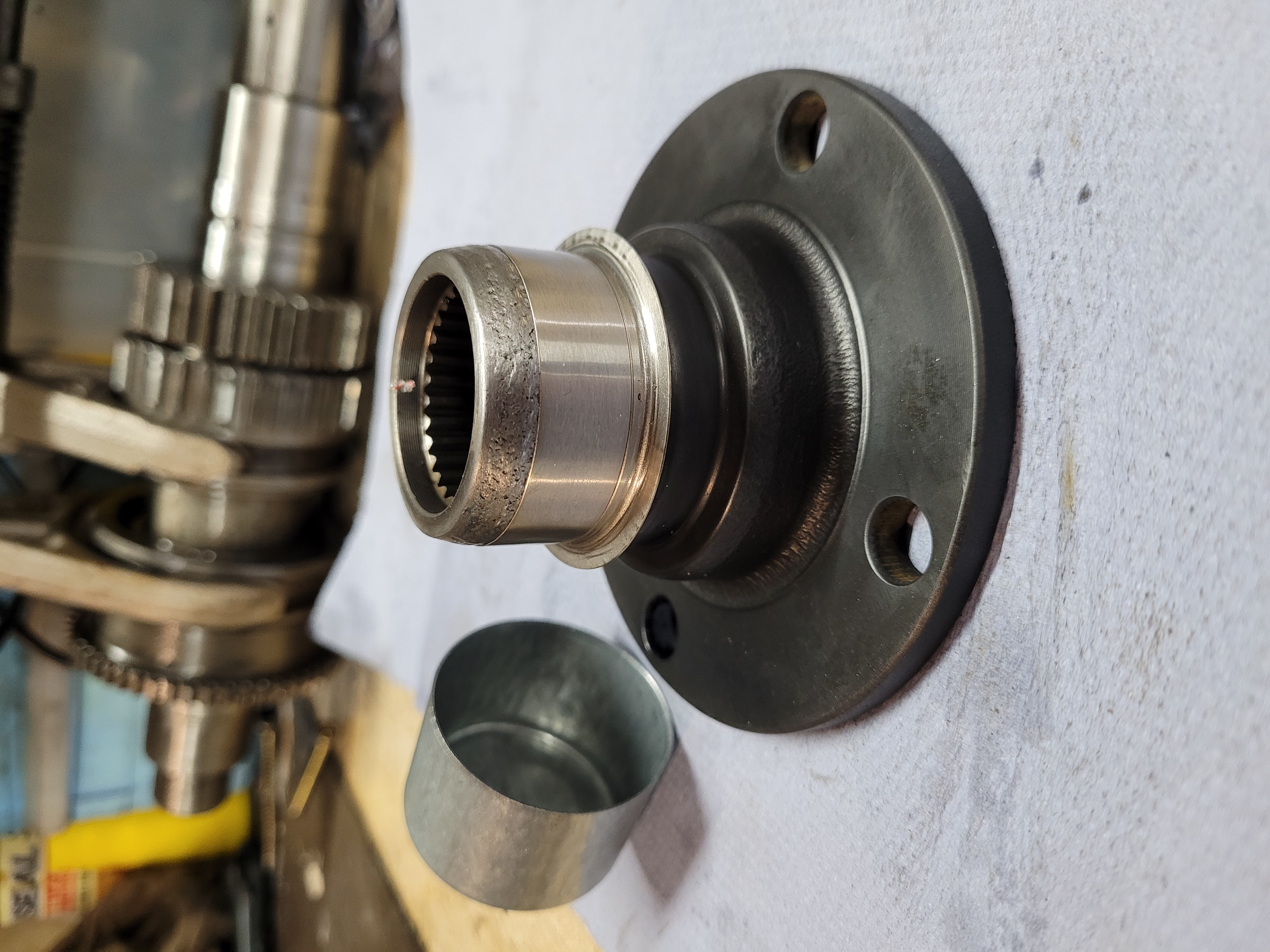

I asked for more information about the repair and they sent me this. + selected material 19663

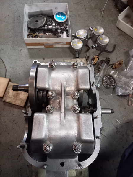

We are slowly moving forward with our 4F6/1934 project. However, I am quite sure that we will save it and it will run again. During the renovation we found that we had a large number of parts left and there were also interested parties who would like the same motorcycle. We are missing the engine from 1933 - 36, do you happen to have any remaining engines in your garage? It may also be incomplete

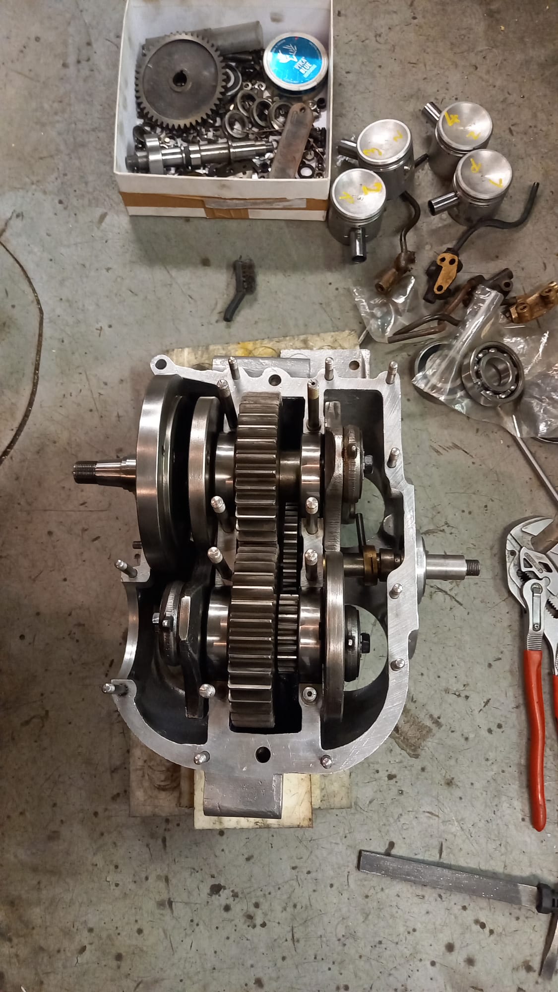

After a long time we returned to our OHC project. I was at the Italian Rally (Sardinia) and I was interested in this machine. I guess I needed a little incentive to get the desire to return to this discussed project. So we at least put the engine together.
