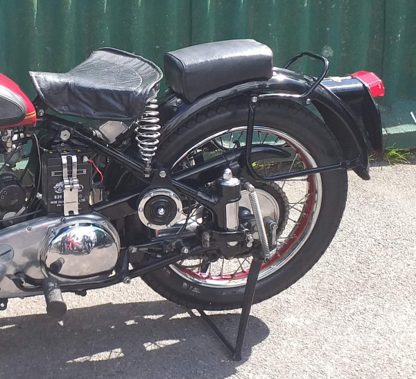

Have you got a downward pointing brake arm (like the first picture)?
If so, then this is a well known problem and can only really be cured by changing to an upward pointing brake arm.
I am fairly sure both the pictures above are of 1953 Anstey Ariels.
Pete

OK, That is interesting! Yes, it is downward pointing. I wonder why changing to upward pointing works?

The combi of the plunger springing and the direction the cam on the lever pushes the shoes makes for a self servo action when the rear brake is applied.
A factory mistake !
Routing the rod with the arm pointing up is a bit difficult, some models used a cable after this was found out and you need abutments for that I think only the later SQ4's had that.
A factory mistake !
