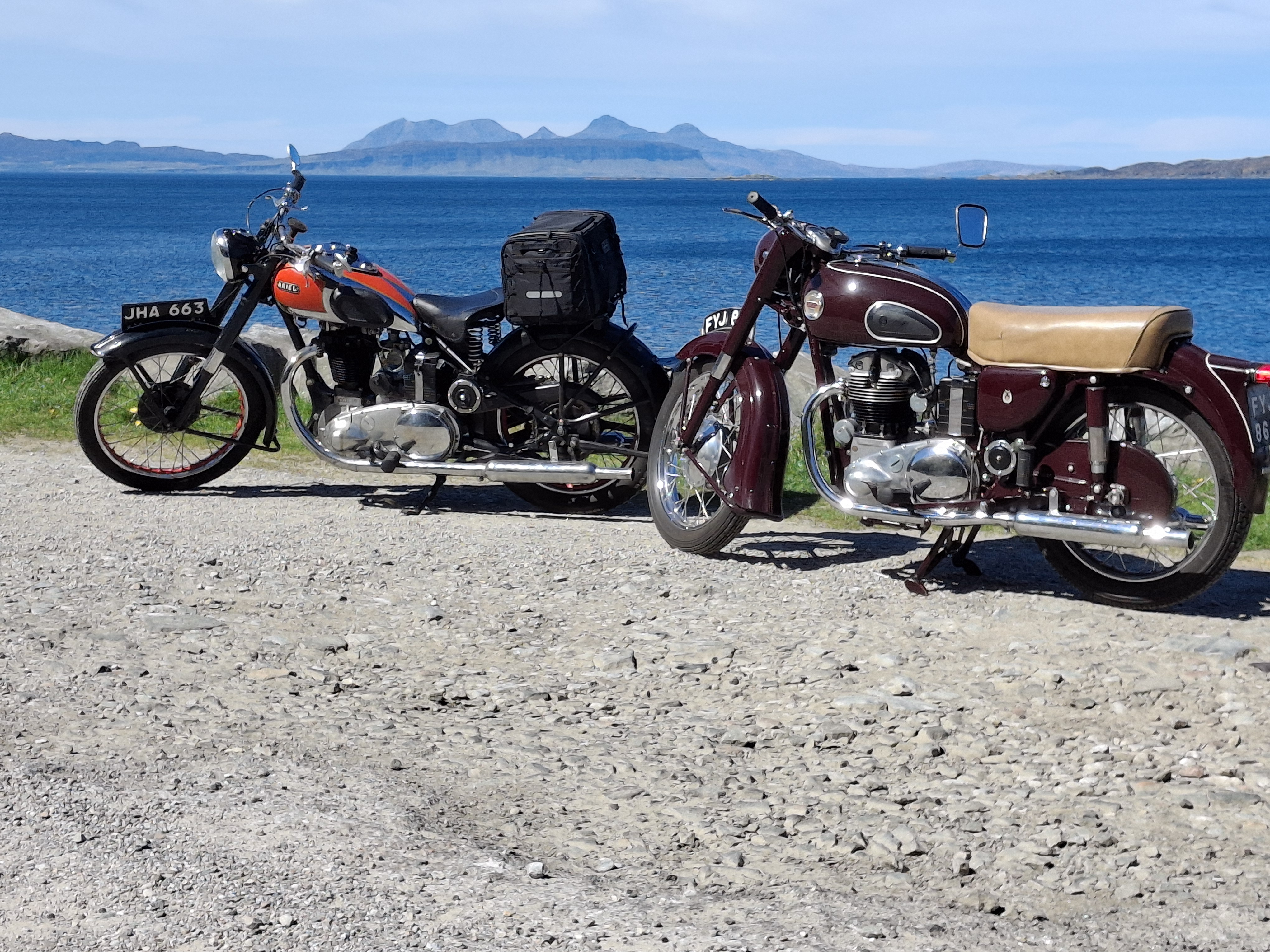

I patched the leaky pipe with some JB weld, and popped an O ring over the valve lifter spindle.
Had a long run over the last few days, 200miles plus on the Moidart Run, and the leaks while obvious are not as bad as I feared. Only topped up the oil tank with maybe 1/8th of a pint after all that. Very relieved- I was carrying a litre and a half with me!
I'll stop worrying about it!
