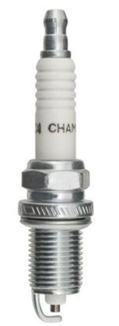

Have just bought Champion D9 spark plug - but the current plug cap (LB05EH) doesn't fit as the spark plug is wider than the old one.
I could use a spade end fitting but would like to know if there's a plug cap that fits?

The plug is missing it's screw-on terminal!

answered my own question:
None of the NGK plugs caps fit the Champion D9’s.
But these do:
Pattern Spark Plug Cap R90 Black Water Resistant Rubber Lodge No Resistor
https://www.gsparkplug.com/1x-pattern-s ... istor.html

Don't use resistor Plugs, caps or leads with Magneto's. Often those screw on ends come Off. Spring clips are safer . A lead coming off can damage a Magneto coil unless it has a safety gap in it somewhere. Nev

Yes, in the end I decided to fit a spade end and thumb nut on the plug - looks right for a 1933 bike :D

18 MM plug thread. That heat range should be about right but it's a BIG Plug. Lucky fellow. Nev
