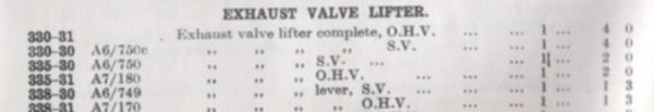

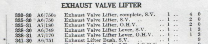

The top one is not correct for 1930-58 models as they all use the same spindle, irrespective of where the valves are. The part number 335-30 indicates that it was first fitted in 1930. Other parts do vary, if all else fails read the b*** parts book, you don't seem to have told us the year of your bike but must be post 1932. Your old spindle appears to be home made.

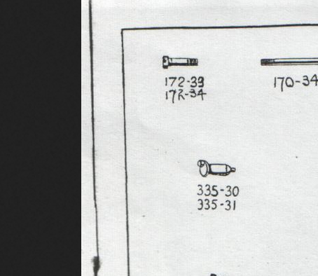

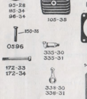

Sorry to be nit-pickey but the b*** parts books for both '33/'34 and '37 list the two varieties of lifter spindle for the SV and OHV
Simon's head is a '33 prior to the aluminium cast box of '34

Posts: 2004
Re: WANTED VH500 valve lifter spindle
That's not being nit-picky that is correcting someone who ought to know better and stands corrected. Still learning...
