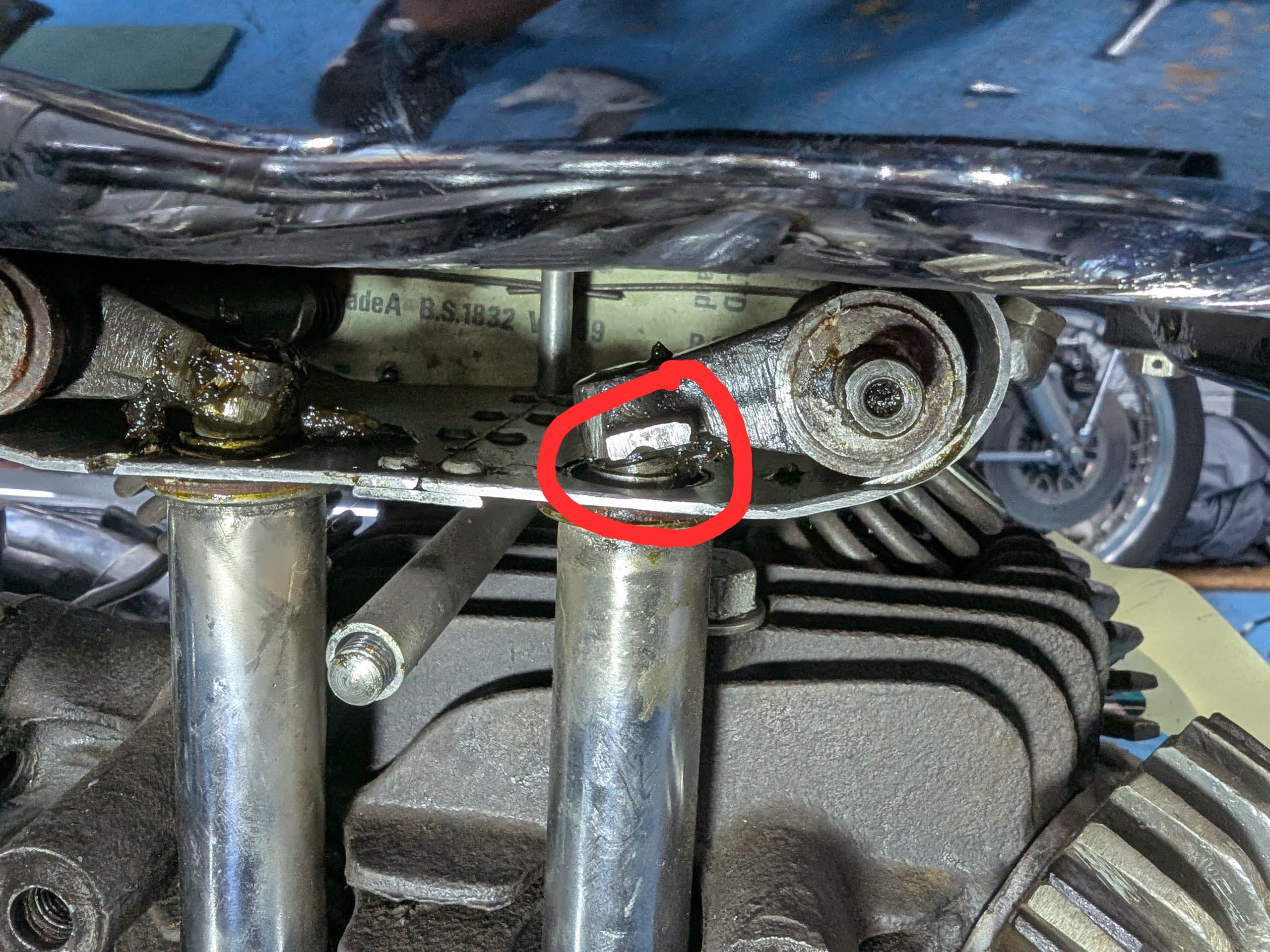

mine looks like this...
Posts: 1955
Re: WANTED VH500 valve lifter spindle
The side valve and ohv arms are for cables entering on opposite sides

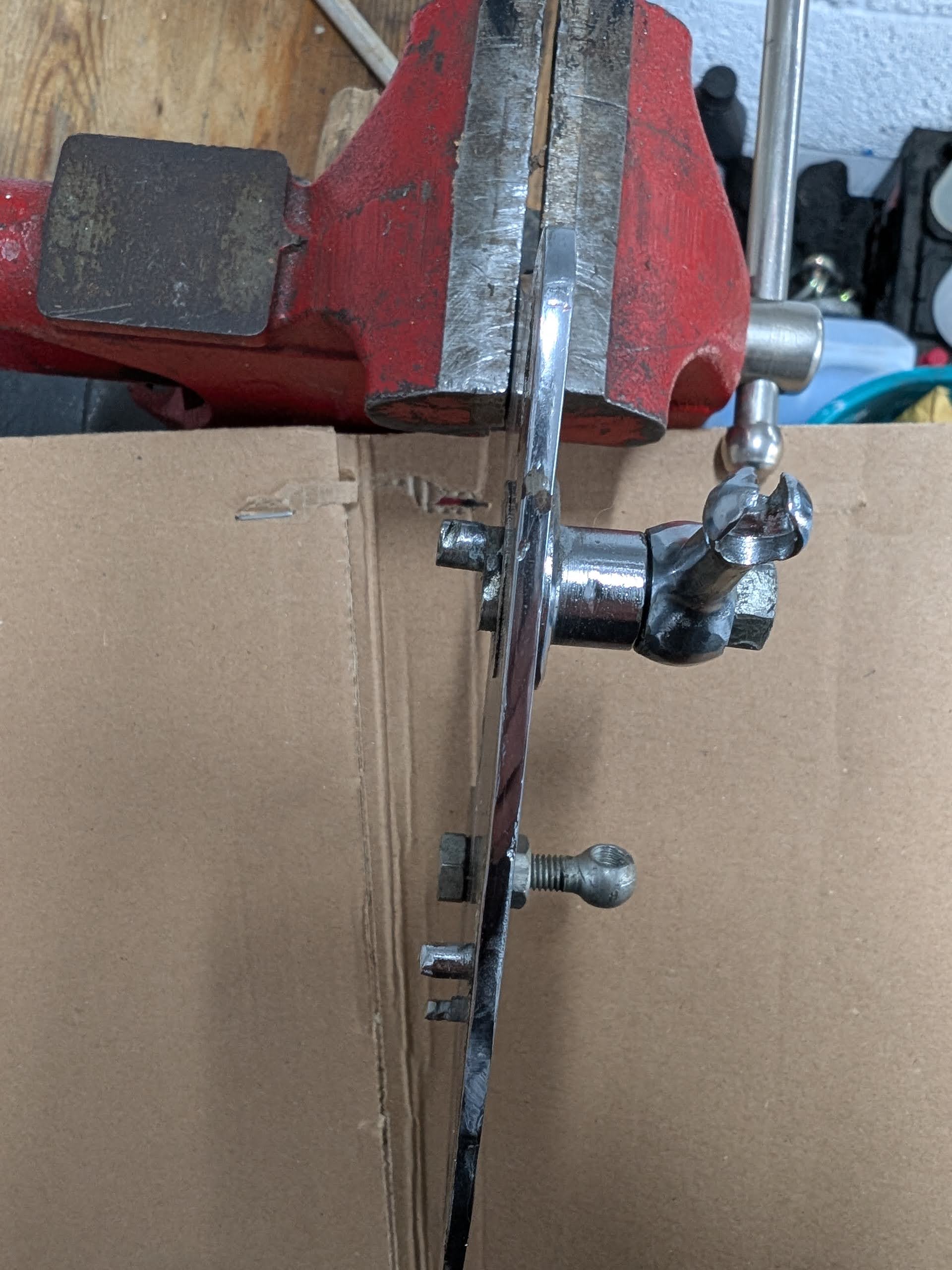

It will be the same spindle part but your rockerbox looks like this with the lifter on the side plate?

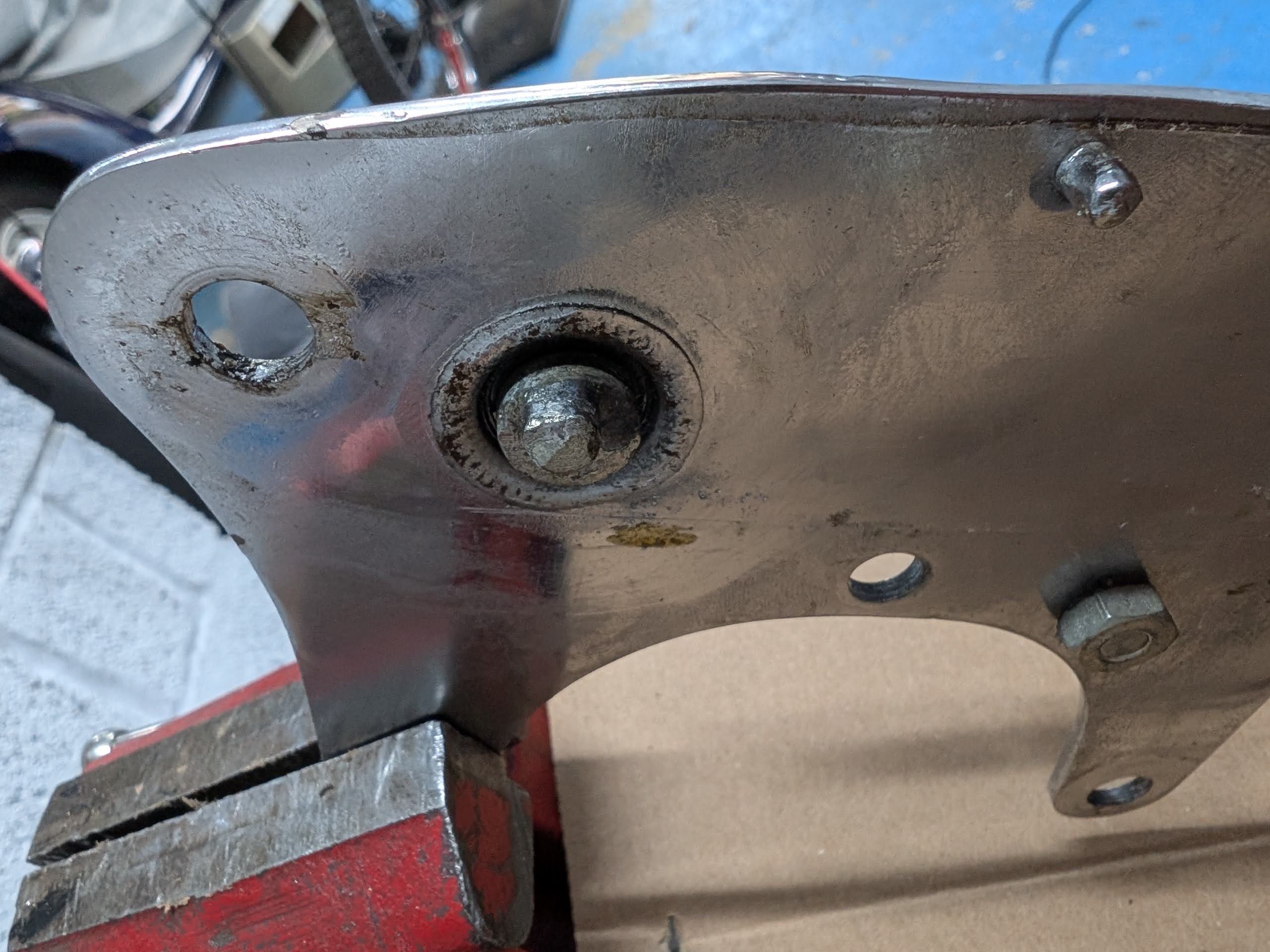

and this will need attention as well:
but I'm not sure how easy to remove it?

In the 33/34 parts book 335-30 is listed for side valves and 335-31 for overhead valves....
mark.prizeman
Posts: 65
Post by mark.prizeman »
I suspect the difference between them is length? Which is crucial for your setup...
Just found another NOS spindle which even though it came with a SV arm (handed) seems identical to the old OHV one. (the repro one is longer)
