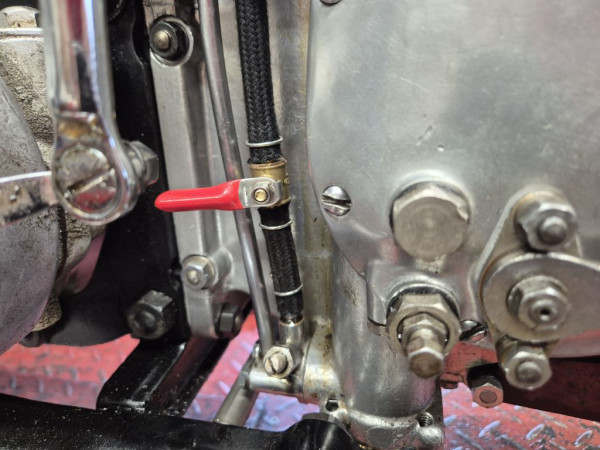

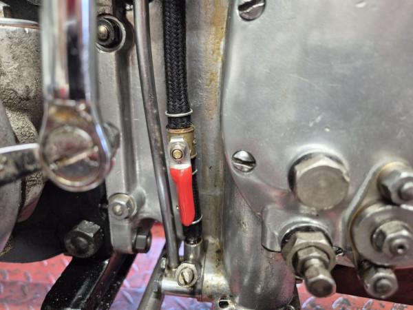

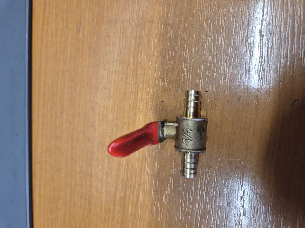

report on the condition of the motorcycle after a short period of time. I had to install an oil shut-off valve because after a long time the oil was leaking into the engine blocks and the motorcycle was smoking a lot when I started it.

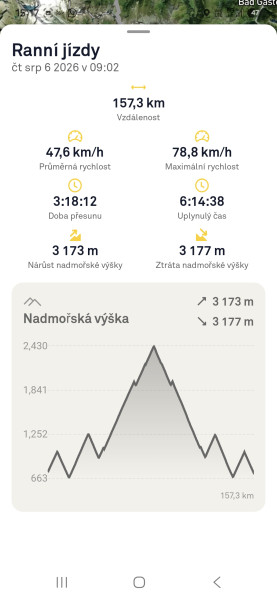

I also bravely tried to participate in the Austrian Rally. However, the hills really took a toll on the bike. Both valves were slightly seated and the valve clearance was lost, which caused them to not seal well and the motorcycle overheated a lot and did not have enough power for the Austrian hills.
