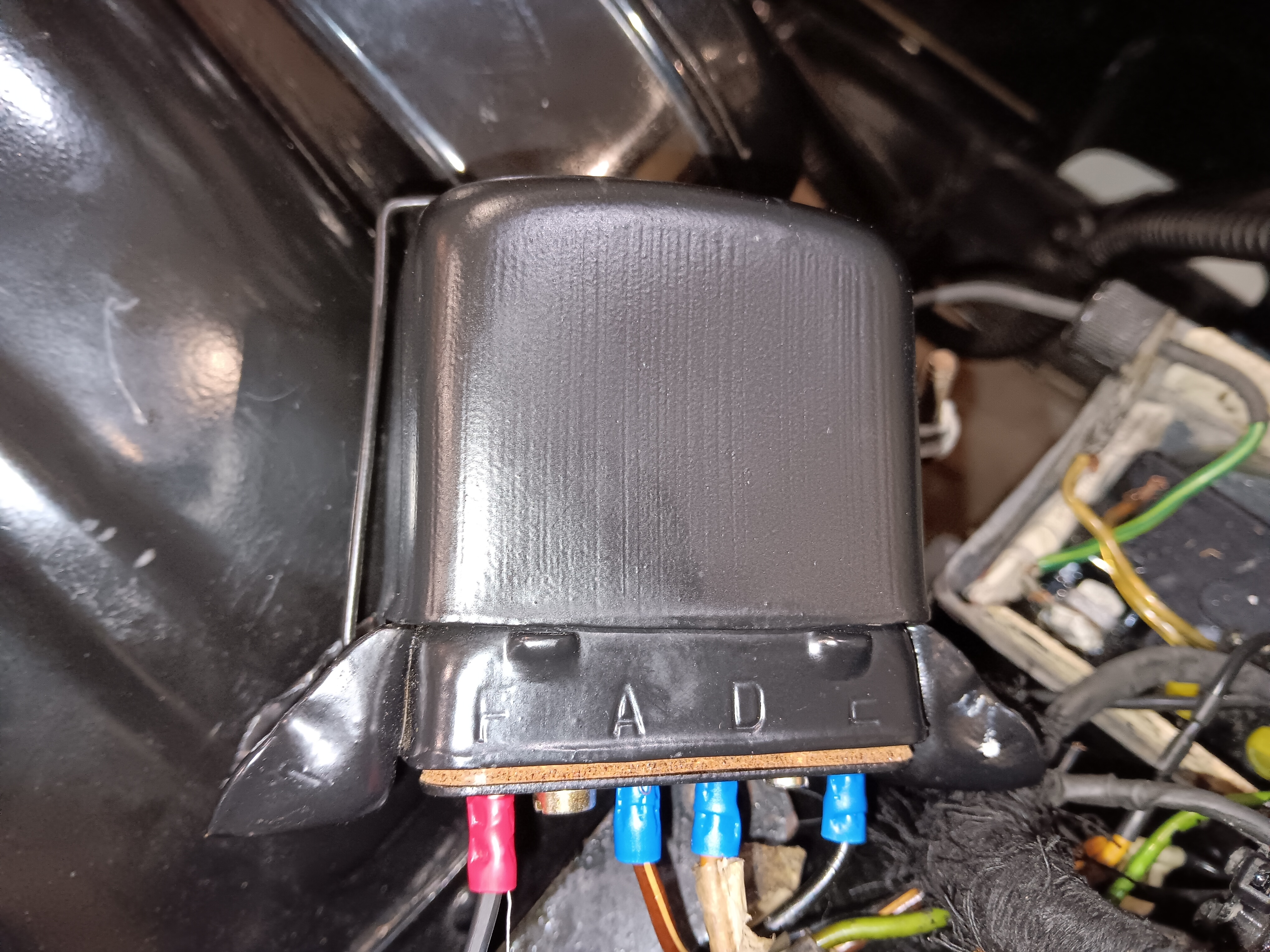

I have replaced to regulator with a "new" one I bought several years ago. It was still in it's box. How can I test it. Making sure that the "F" and "D" wires are well connected, can I test the output from the "A" terminal, which appears to be one one carrying the current to the lighting switch, for distribution to the ammeter and back to the battery?

The voltage on the D wire, which is the lower terminal, is the dynamos output voltage. It splits into two; one wire goes to the bulb in the ammeter, the other goes to the regulator.
Initially D is connected directly to F; which is the upper terminal; by a closed contact, inside the regulator.
If you connect a voltmeter between D or F, and any bare metal on the engine, you should get exactly the same result as connecting a piece of wire between D and F.

in end i got an AO services Vreg and i fitted it inside my old lucas MCR2 box , all the wires were same colour for FADE and i soldered them to the terminals in the mcr2 box , i had already dismantled the coils etc in the box and used the aluminium plate to mount the AO voltage regulator to it inside so it all looks like the original regulator externally .
the dynamo wires all go back into the terminal strip on the regulator using the same RIPAULTS wire terminals which i soldered up and also used the original terminal retaining strip that you have to push the wires through before soldering terminals on and screws on to hold the wires in

I would agree with the above, slave in an electronic regulator and see what happens, if your problems disappear then consider how you want to move forward. Hide the regulator inside the MCR2 box or find a reliable old style regulator, (not easy or cheap), I'd go for electronic.
