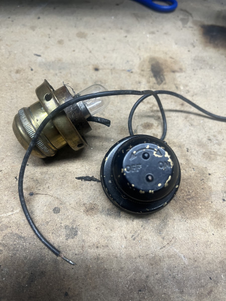

An original and a club copy
Re: 1937 VH Project
Thanks Mark - it appears that I have an original lamp as well.
