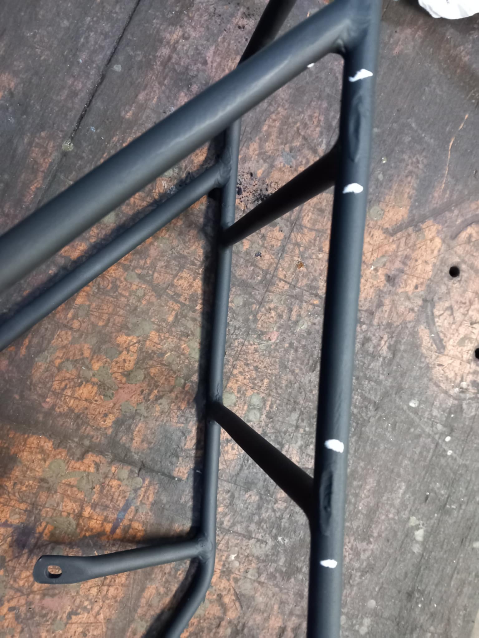

Hello,
Does anyone have the dimensions and/or photos of the brackets that were cut off the luggage rack?
Thanks in advance.

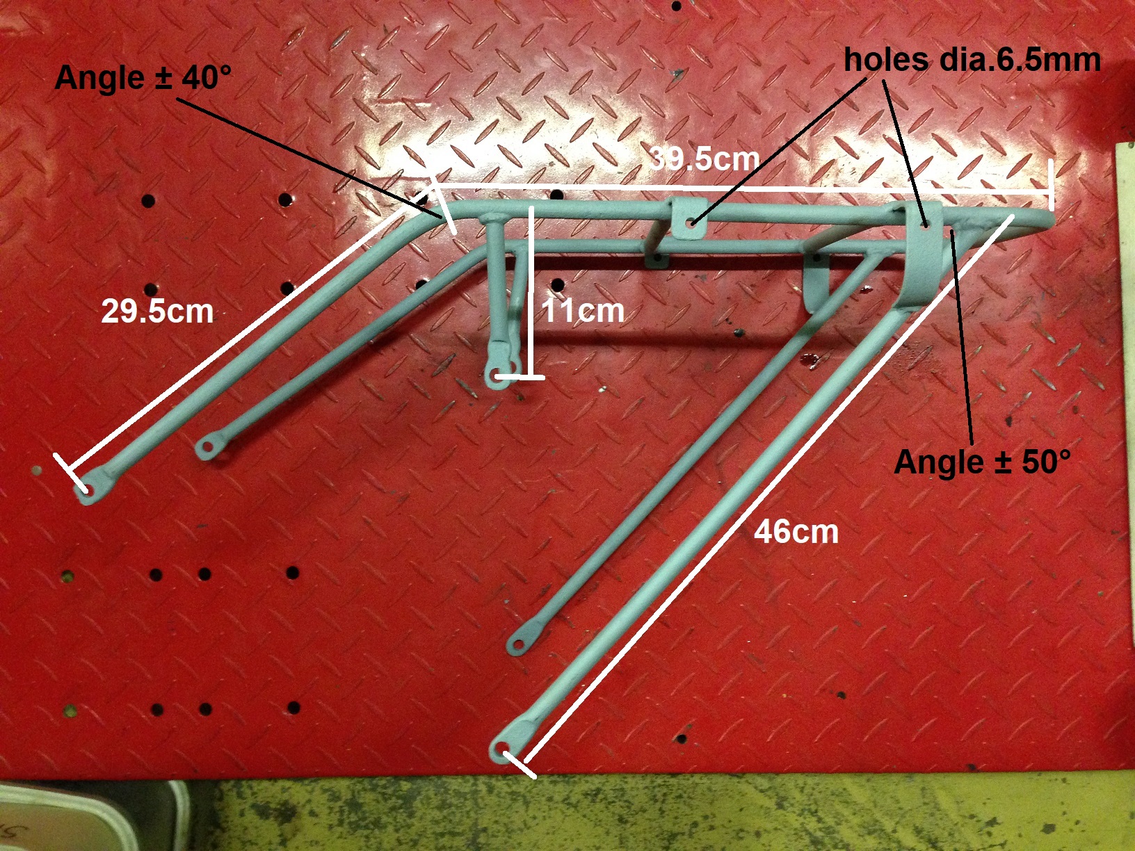

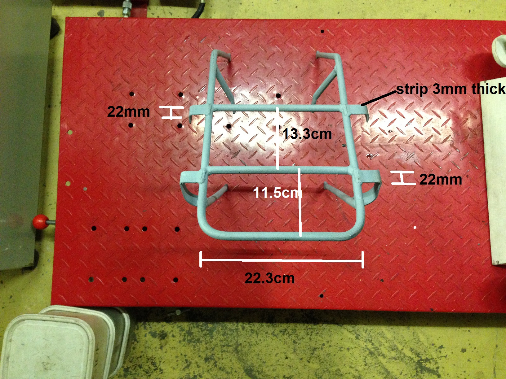

Posts: 5108
Re: New project " Belgium Siren"
Posts: 4777

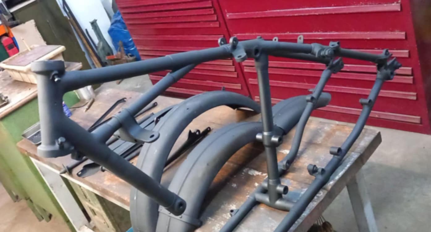

The parts have been sandblasted.
The adventure can now begin.
A name has been found for the Ariel, she will be called "IRENE".
