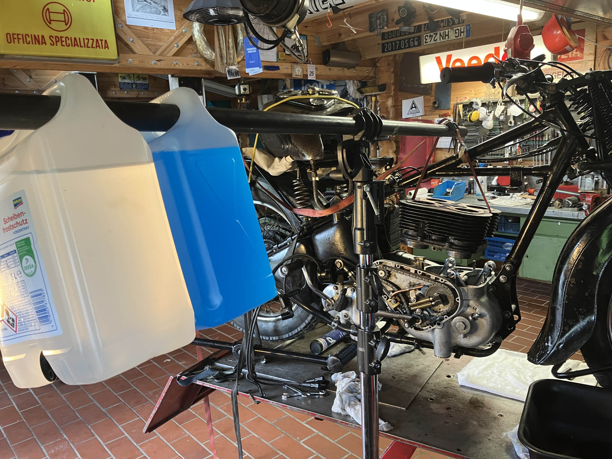

I mount the pistons on the conrods and then hang the cylinder on a stand with an arm. I can easily lower the stand, which makes it easy to insert the pistons. The water canisters serve as counterweights. The pistons are missing in this picture; it was just an assembly test.

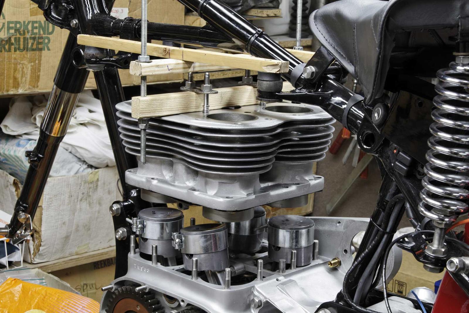

Many roads will take you to Rome. Here is a contribution that was developed by Herman Noord from NL. I have tried it but I went back to the traditional way!
