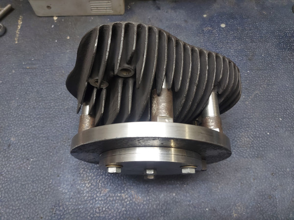

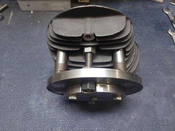

I made up a jig :) .
Lot of work for just a one time use....I must be bonkers :lol:
The cylinderhead is supported level by 4 studs that stick into four of the nine cylinderhead bolt holes.
And held with one bolt through the sparkplug hole and another in the (threaded) TDC hole.

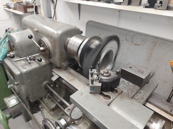

Skimmed the VB head on a nice Schaublin lathe.

Nice lathe 8-)
