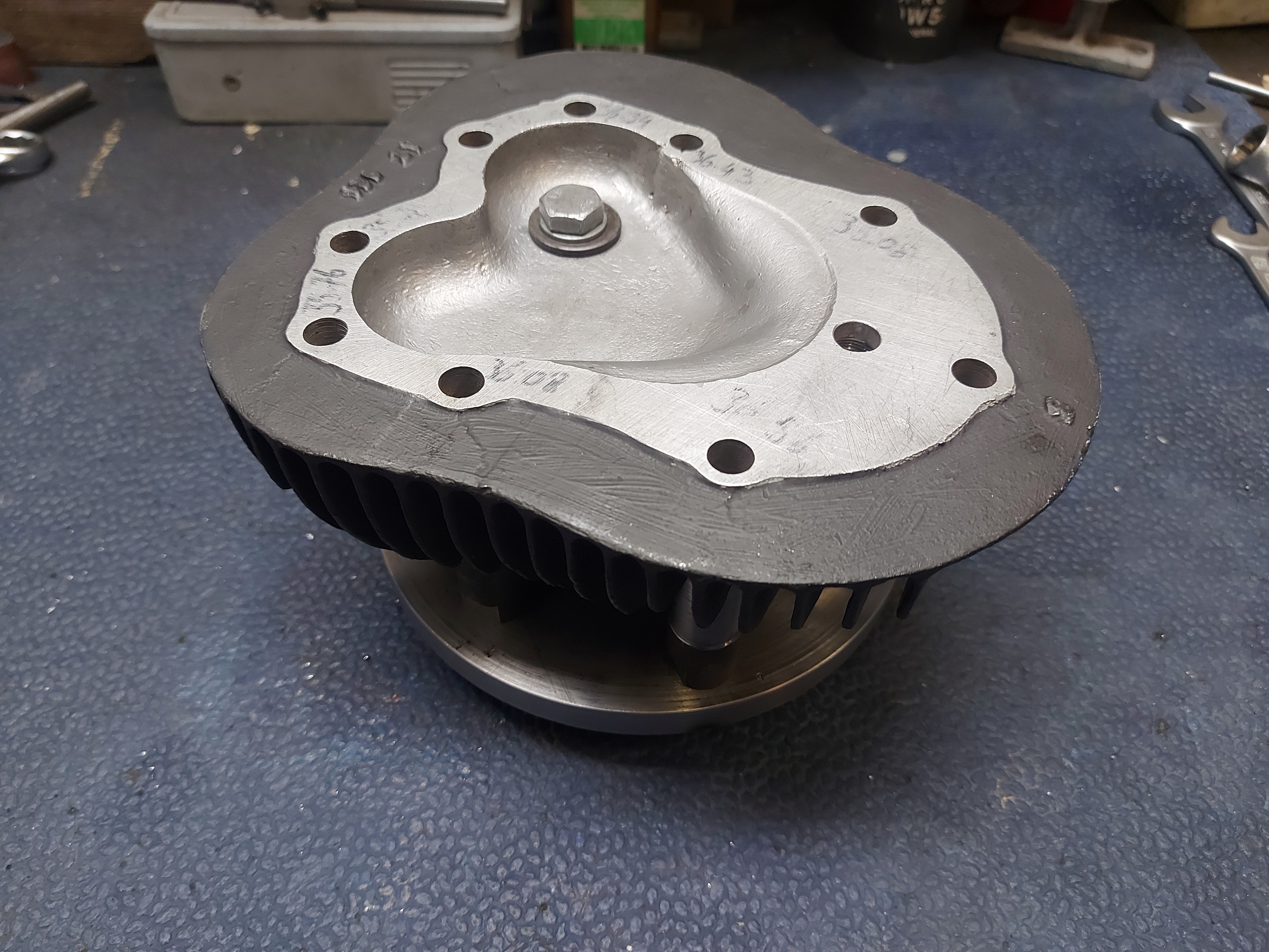

Wanting to skim the cylinderhead.
And who knows.....maybe upp the compression a tiny bit ?
Not for my lathe as that has not enough swing as seen here :
( I have two cylinderheads, above is the 'dummy' one.)

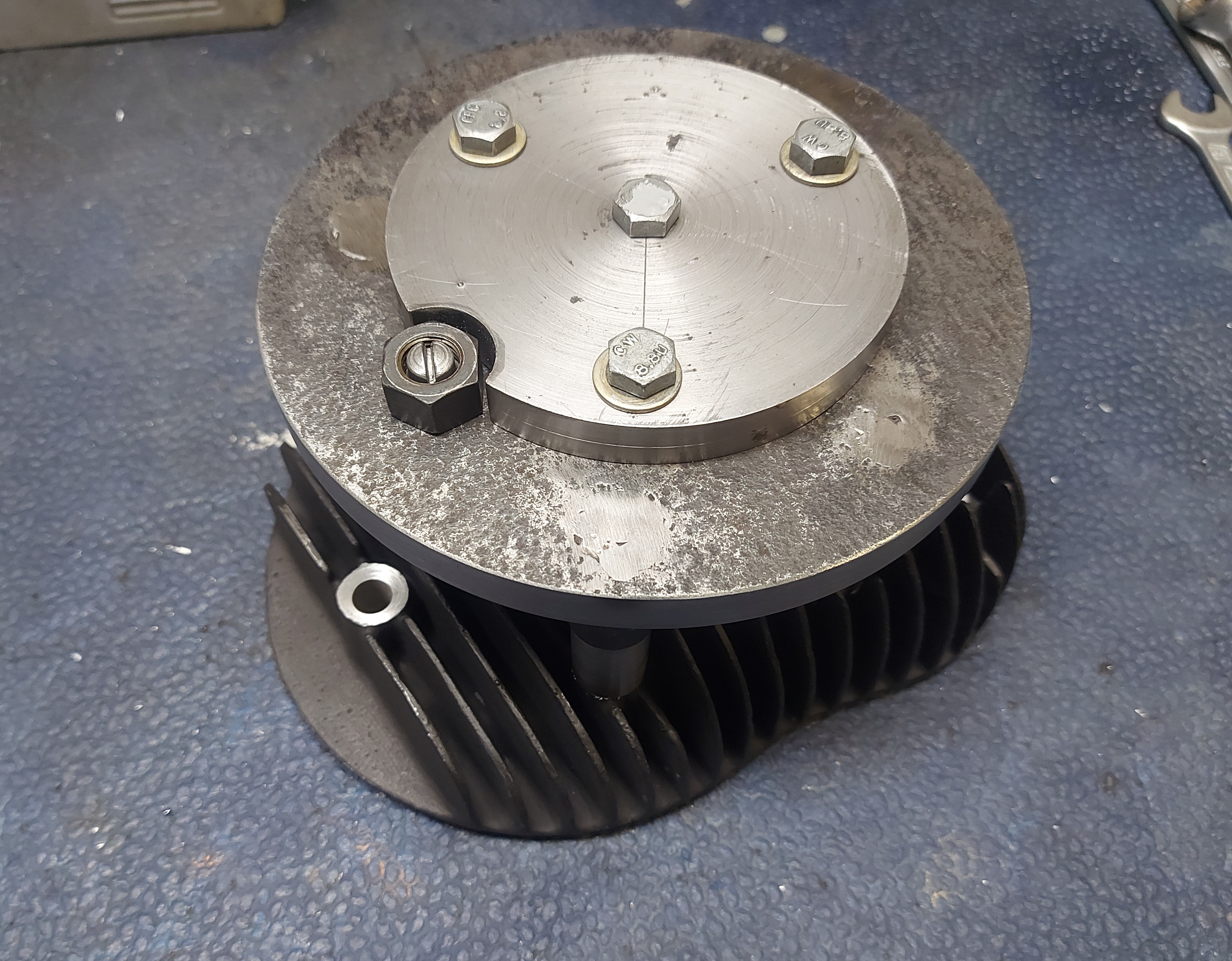

I made up a jig :) .
Lot of work for just a one time use....I must be bonkers :lol:

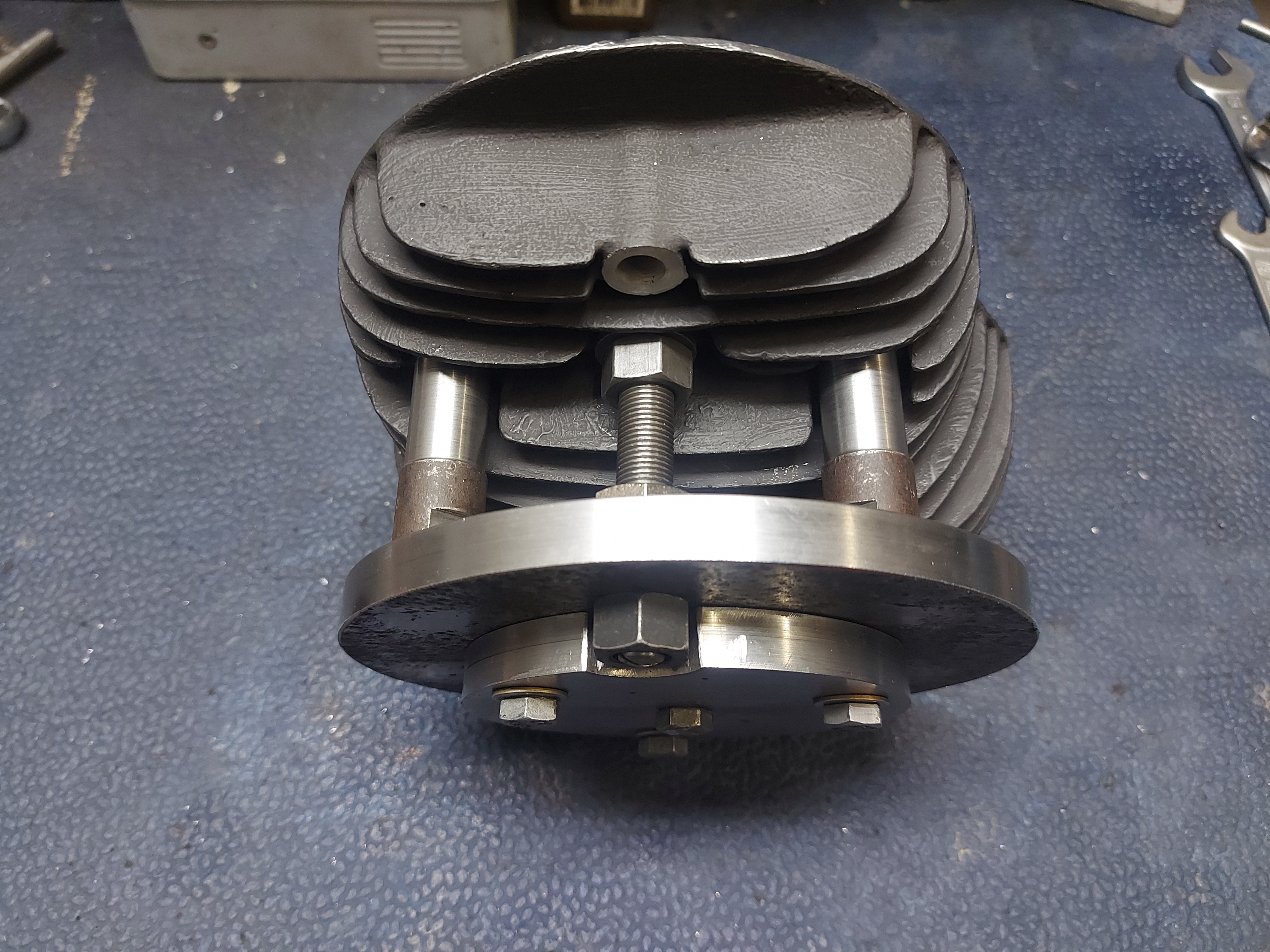

The cylinderhead is supported level by 4 studs that stick into four of the nine cylinderhead bolt holes.
And held with one bolt through the sparkplug hole and another in the (threaded) TDC hole.
