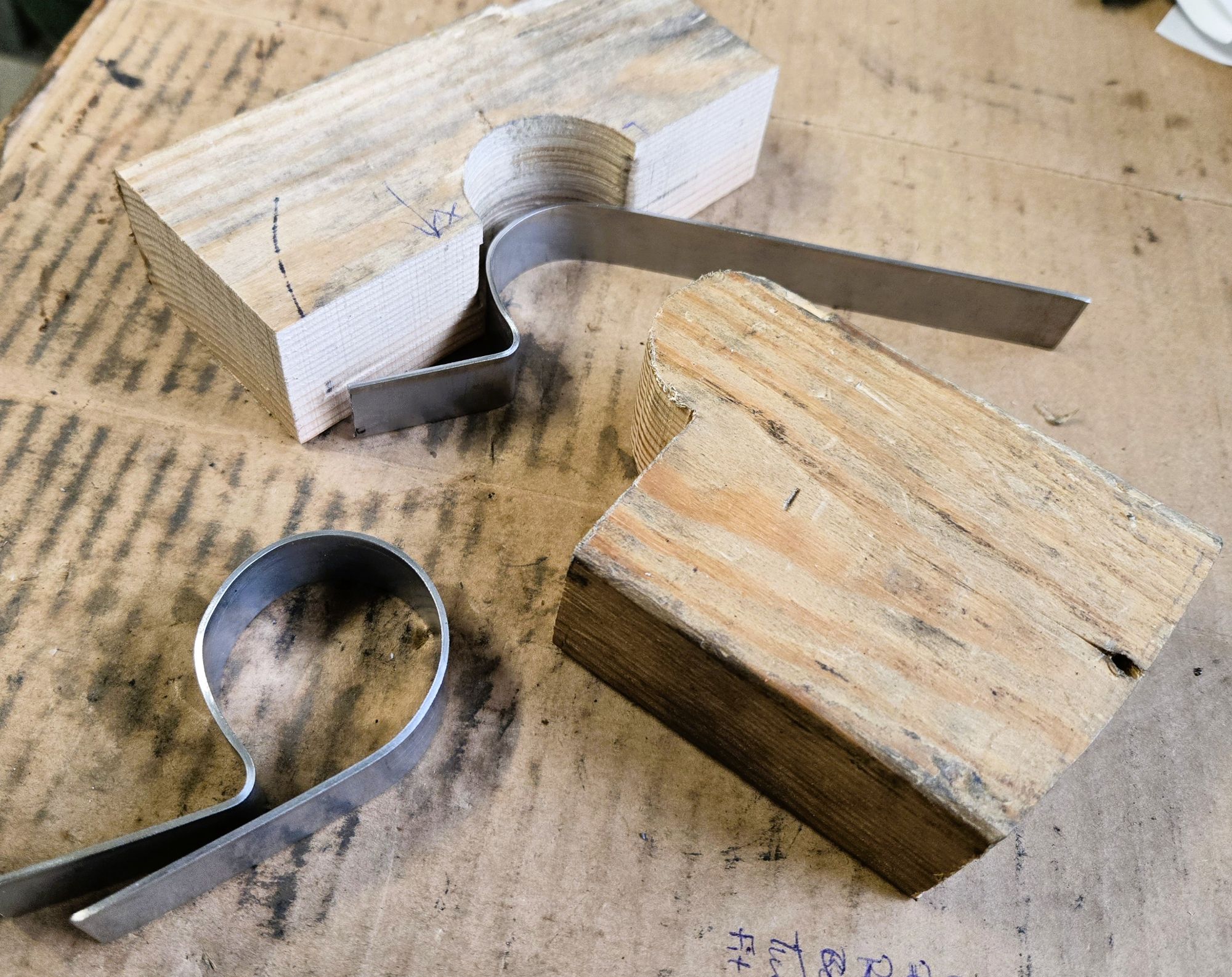

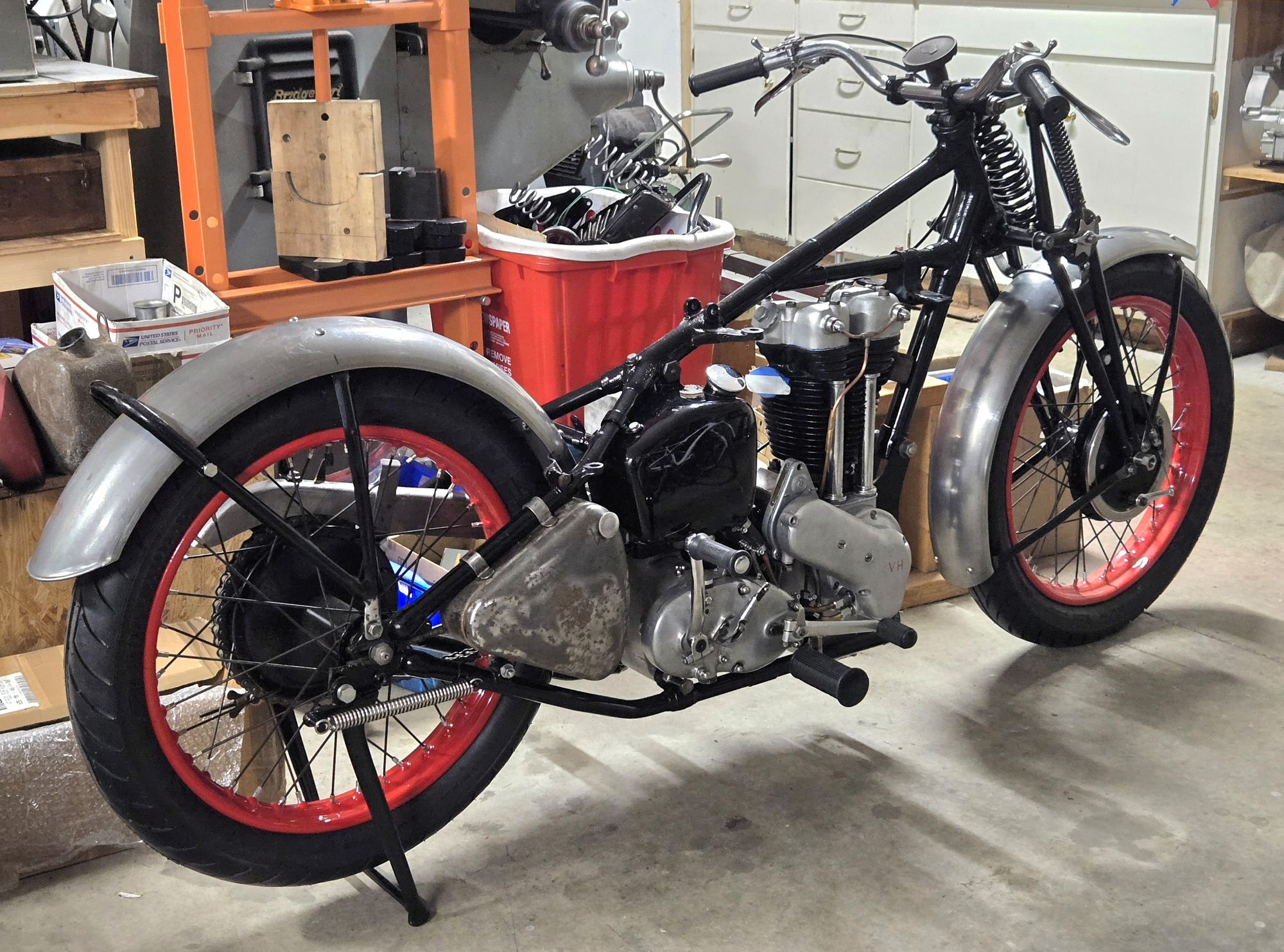

Once the fender was cut to fit the length of the fender stays could be set by taping blocks of wood over the tire and checking the stay length. Next brackets could be made to fix the fender to the frame and stays. The frame and stay brackets both needed similar contour so I made a form to press steel strap into shape. While this was far better than making them individually (as with the toolbox brackets) there were hours of joy getting them to fit centrally in the frame and evenly over the tire.
With the fender sitting nicely over the tire the bracket tying the fender to the engine plate could be made.
The bare steel fenders look so good it's tempting to paint them silver.

Looking good with bare steel mudguards.
Clever job making the brackets using wooden formers in the press.

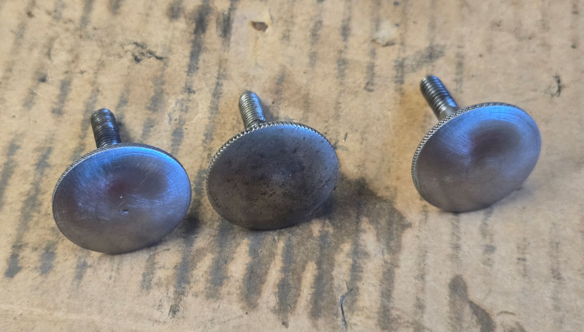

Last week I decided to make some tool box nobs (knobs?). This toolbox had no knob and my '39 had been traveling for years with a knob made from a carriage bolt with a large nut pinched on
Turning the convex surface was more successful than expected. The edge was knurled with some success and a threaded shaft brazed in. So now the '39 has a nob of a knob and so does the '46.

The next step was to fit the exhaust pipes and silencers. I had P-clamps that were slightly too small and though I was able to reshape them somewhat they would have needed an ugly spacer where the seat mounts tie them to the frame. I decided to make new P-clamps from a scrap of stainless sheet sold by the local steel warehouse. Another wooden form was made to press shape.
Polished on the wire wheel the result is not too bad.
