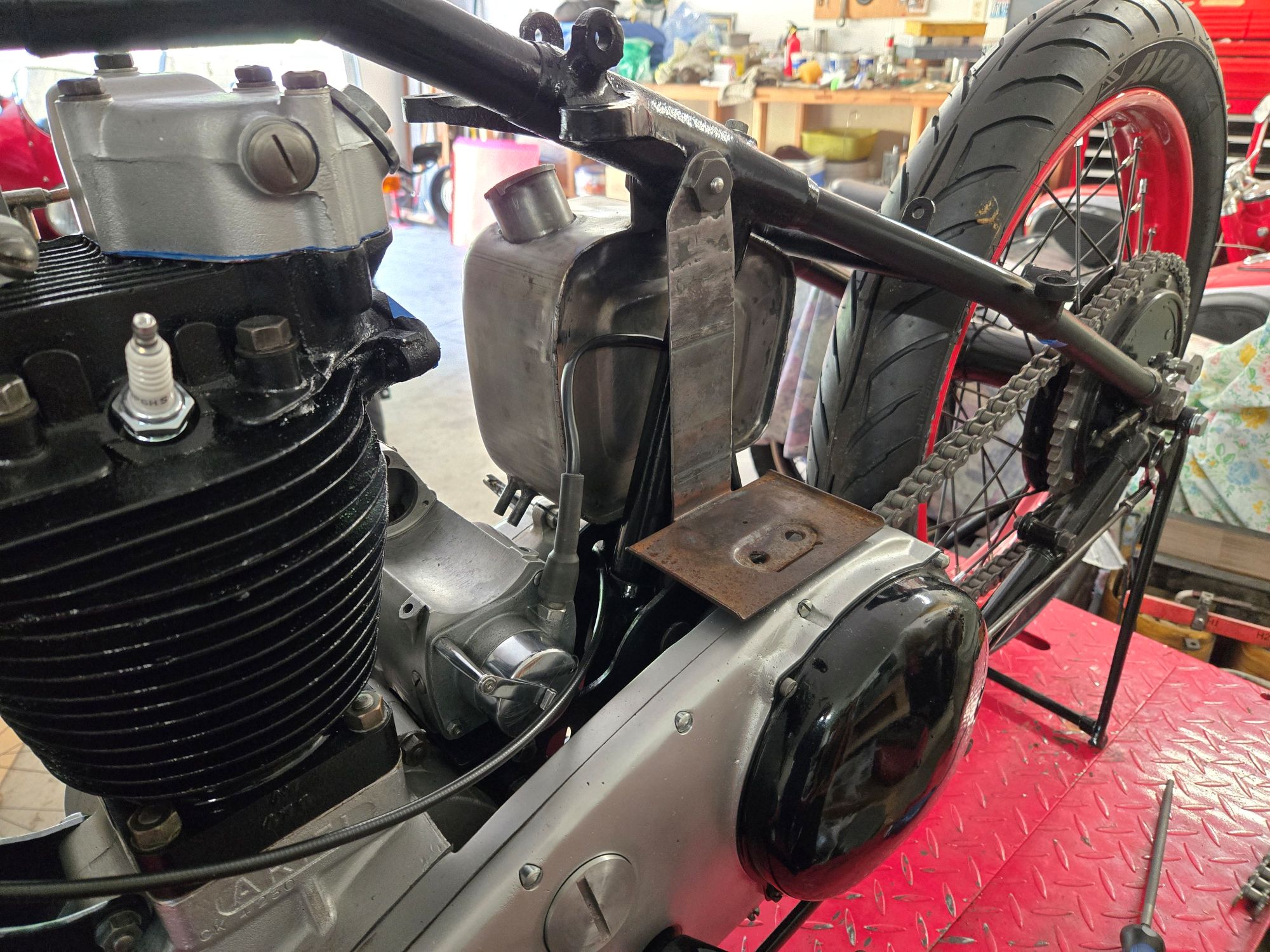

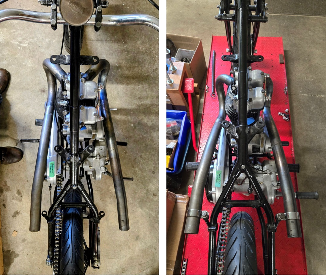

Been having too much fun to post progress reports but the days are getting colder and shorter so here you go - pictures from months past.

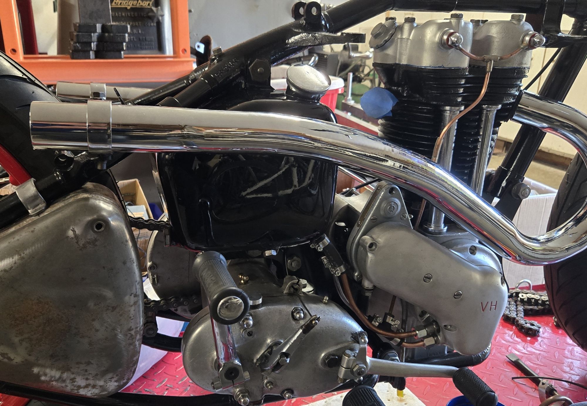

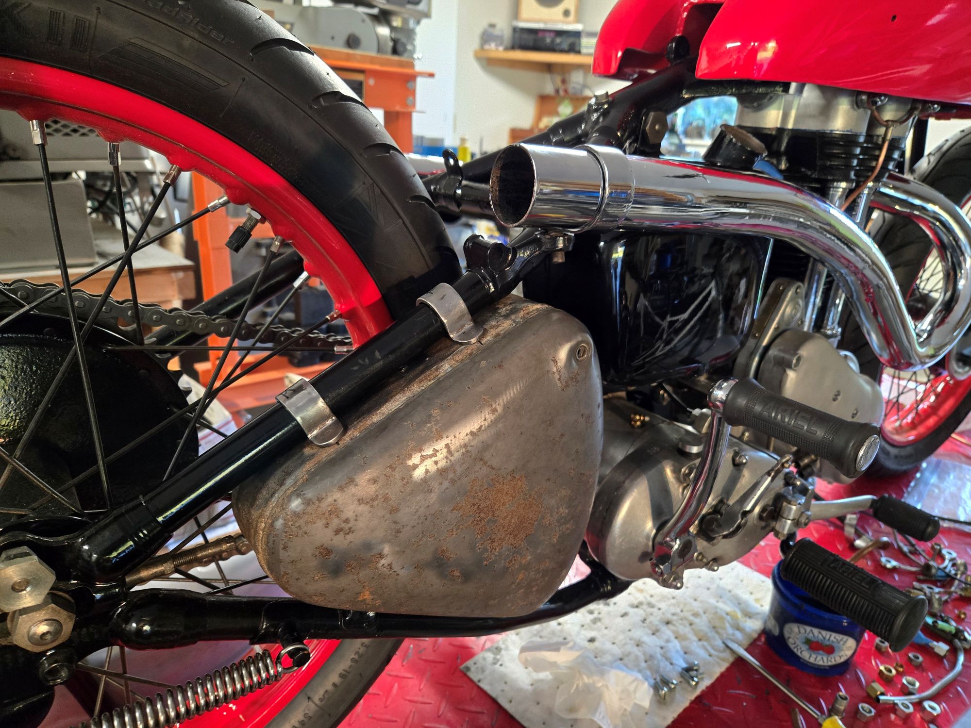

Twin pipes from Armours - but the right side was a little stray so it was straightened with a torch and pressure.
I had 2 previous Armours high right pipes that needed straitening which is why I ordered this one without chrome.

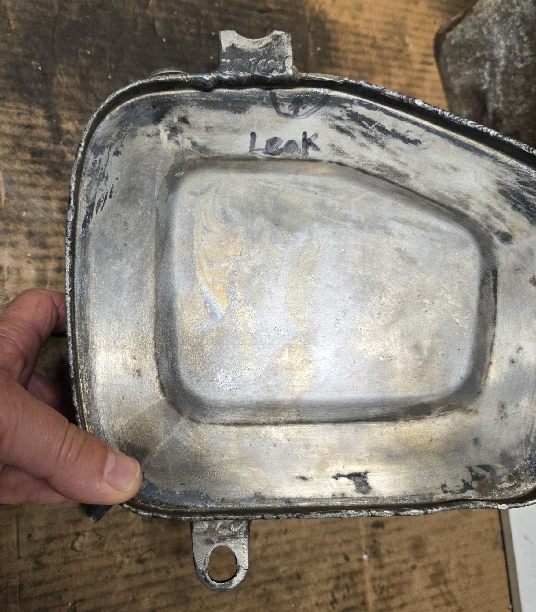

While pipes were getting chromed a friend found for me 6 pint oil tank that needed a little bracket repair and seam welding but was otherwise very nice. Had to reweld the seam several times before I got it to seal - tested with gasoline.

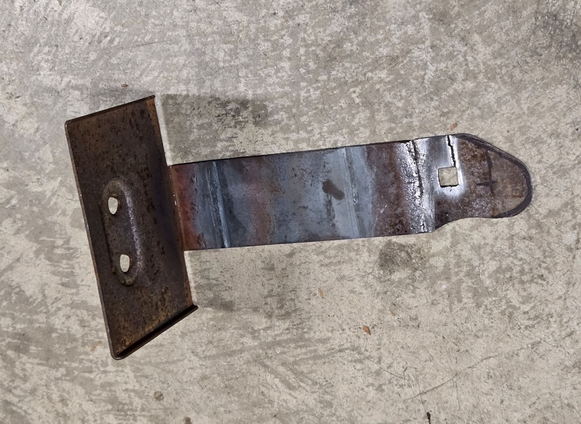

Then there was the remains of a swingarm battery holder that another friend found.
Some hammering, cutting and welding and it fits!
It's important that the right pipe be contoured with the oil tank in place. Wish I'd done that :oops:

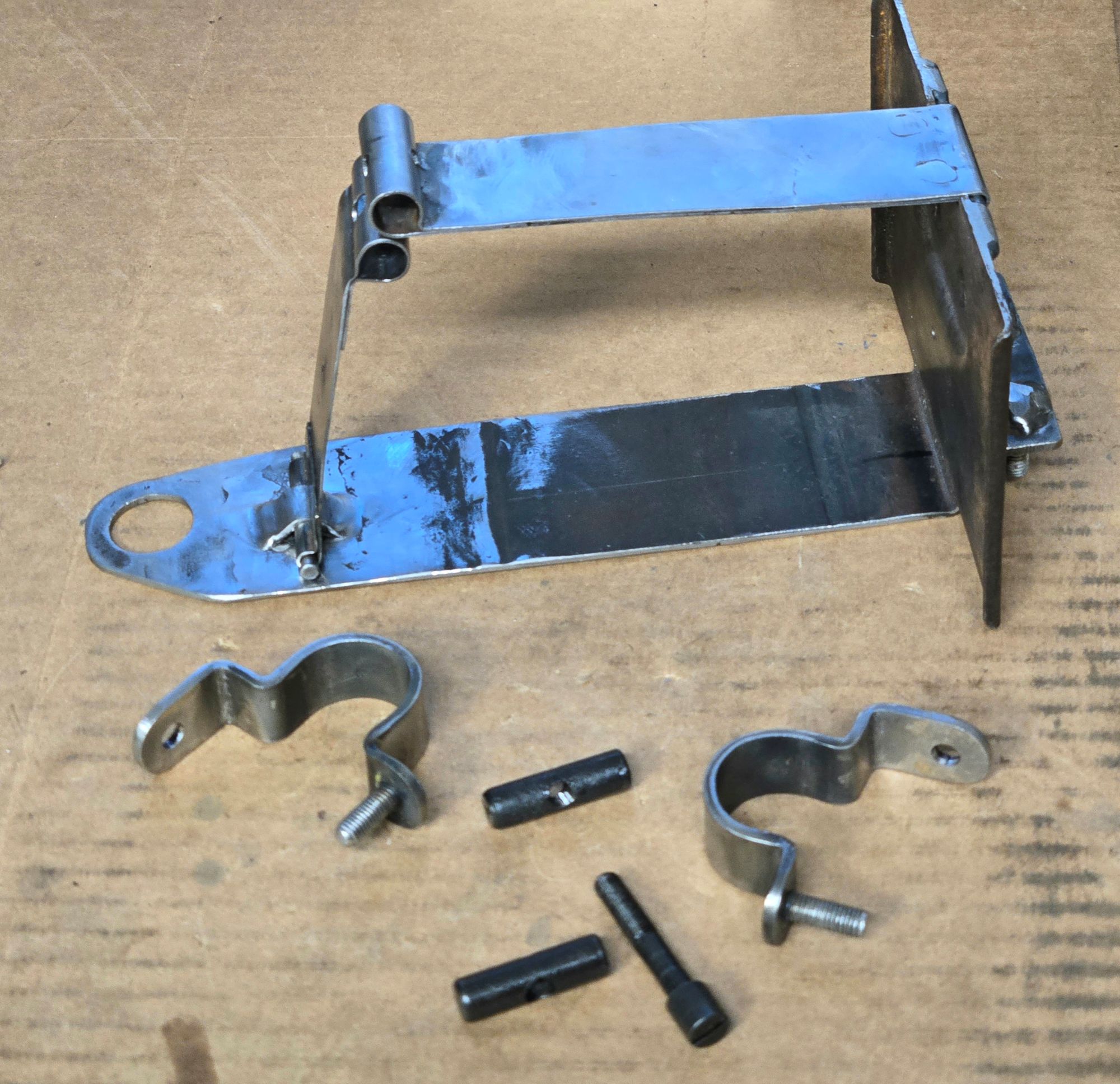

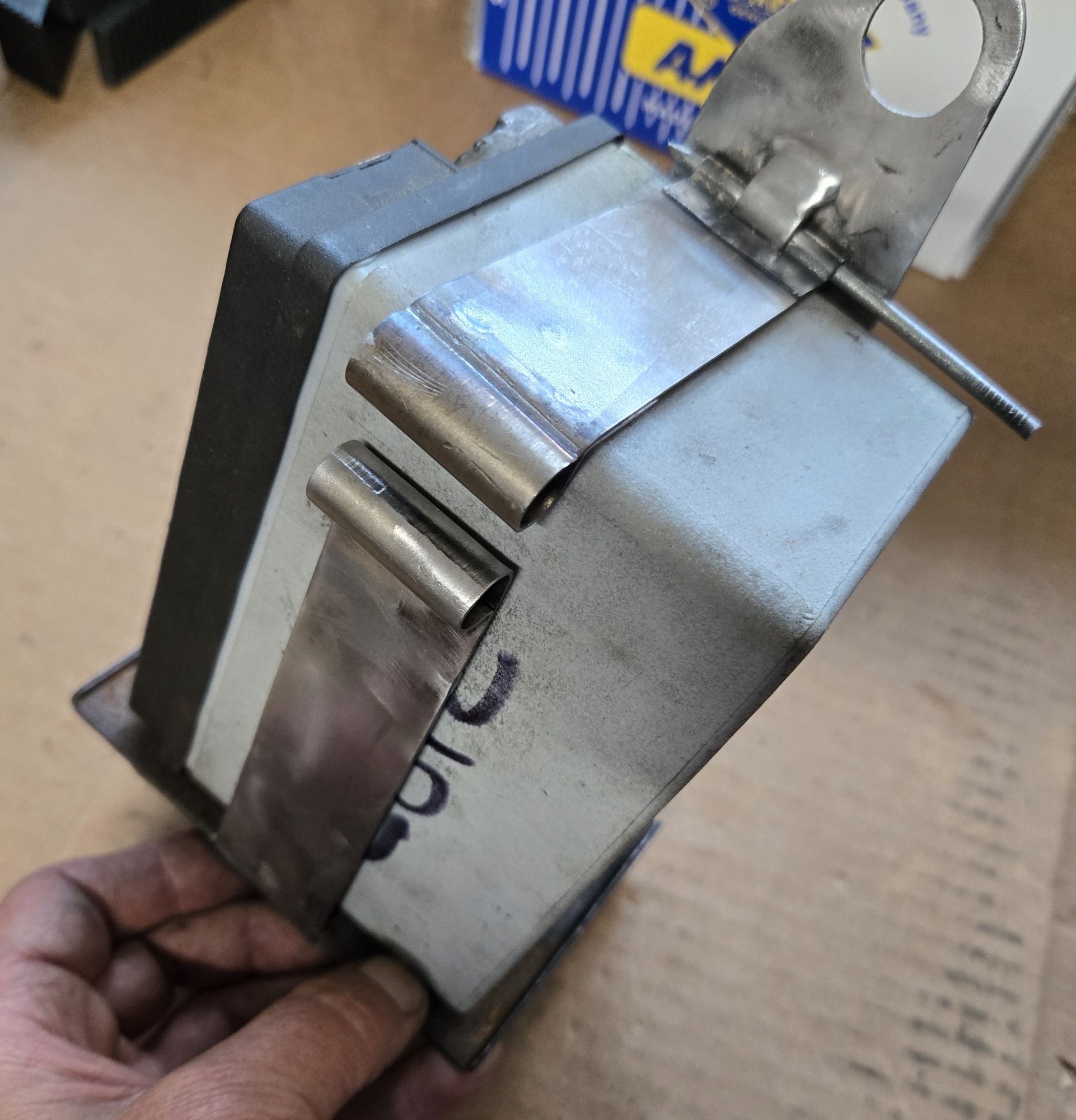

So those last pictures got us through May and not much happened in June and July but then in August I started working on the battery straps and little brackets to hold the oil tank and tool box.

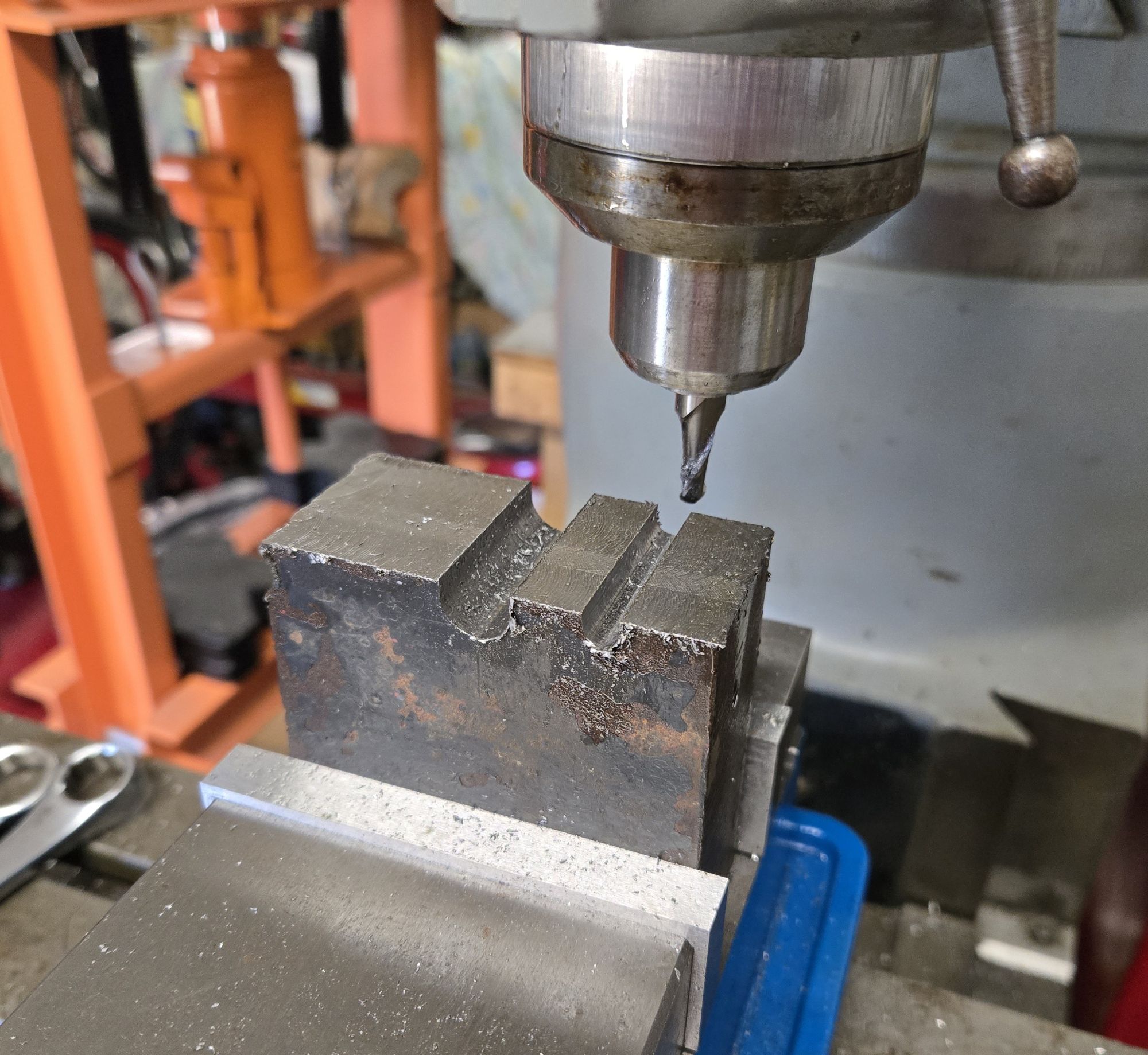

To make the eyes for the battery strap I cut a channel of the correct size in a steel block so that the strap could be pressed in and folded over to form the eye.
I made the trunnions from round stock and turned a suitable pinch-bolt on the lathe.
The toolbox was from a swingarm Ariel or inferior make ;) and had 3 brackets spotwelded to it which were removed. The bottom toolbox bracket was easy to re-weld in the correct position, but it was a real struggle to form 3/4" x 1/8" flat bar into two upper brackets using a vice and a piece of pipe. It wasn't so bad making them individually, but getting them to fit the same was nearly impossible. Spent a day saving myself about 18GBP :roll: The same flat bar was used to for form the frame loop for the oil tank saving myself another 6GBP :ugeek:

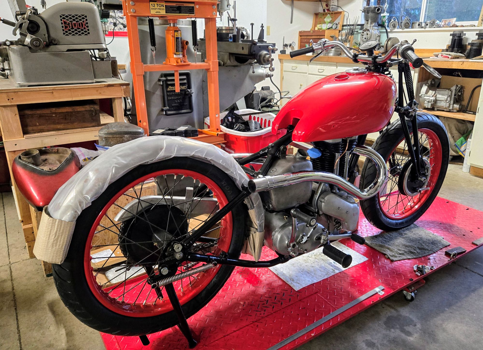

Somewhere in there I got a painter friend to paint the oil tank so then went chasing around for the parts to plumb it. Where I live 5/16" copper tubing is hard to find. Finally the tank got plumbed and filled and a few kicks had oil returning to the tank. Hurray!
