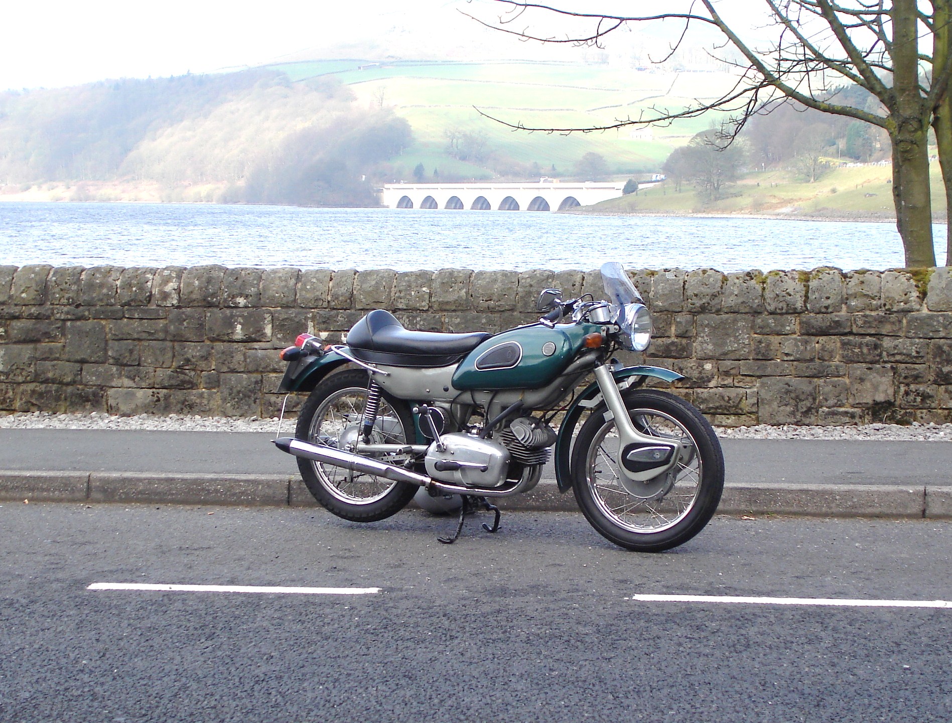

Hello, The engine in the Arrow shown has alloy cyclinders and was mildly tuned by Fahron so uses slightly different jets in the Mikuni carb but I'll check what they should be in a standard engine and get back to you. Brian H.
