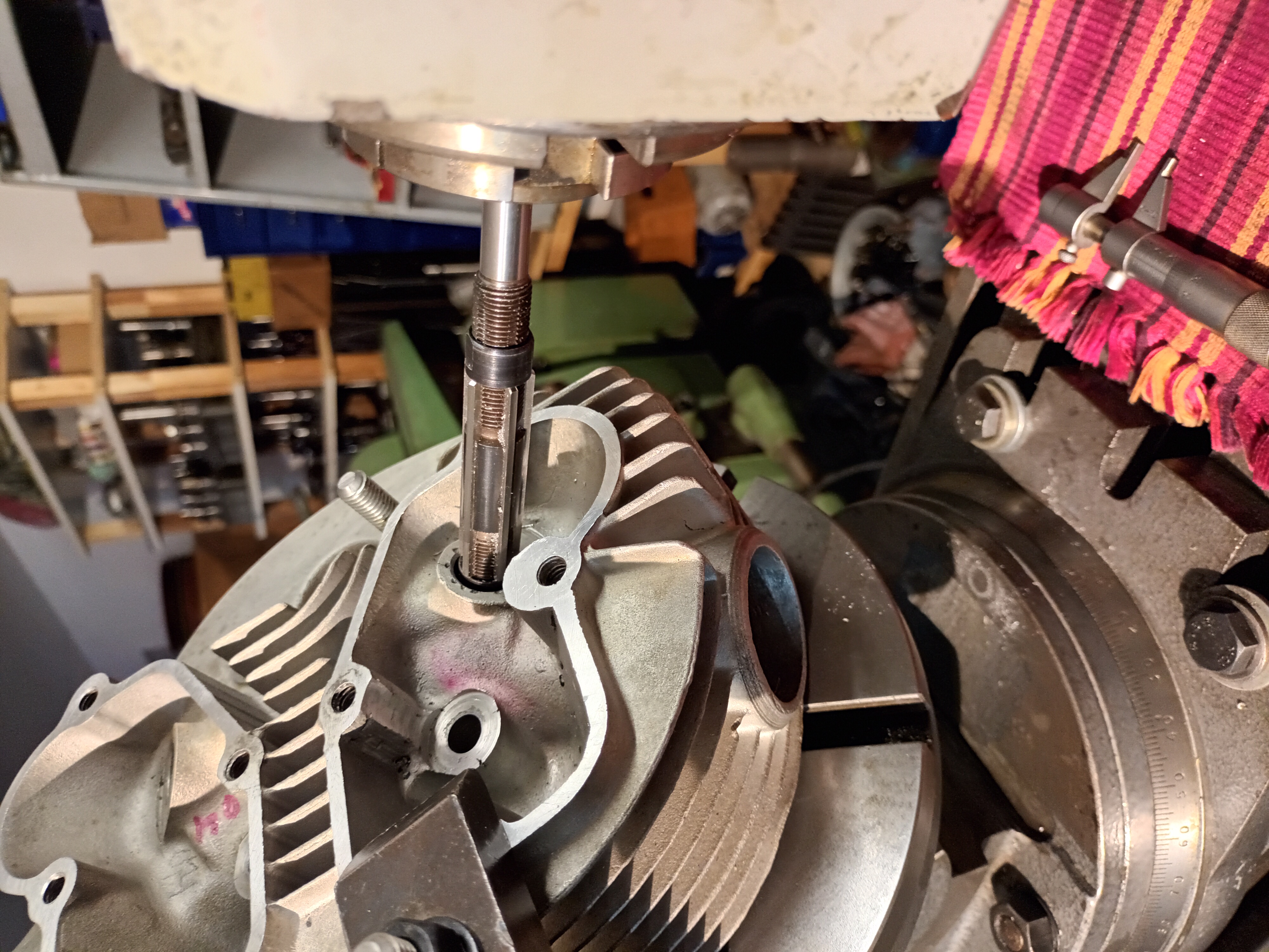

Post by Peter_L »
I hope it works...

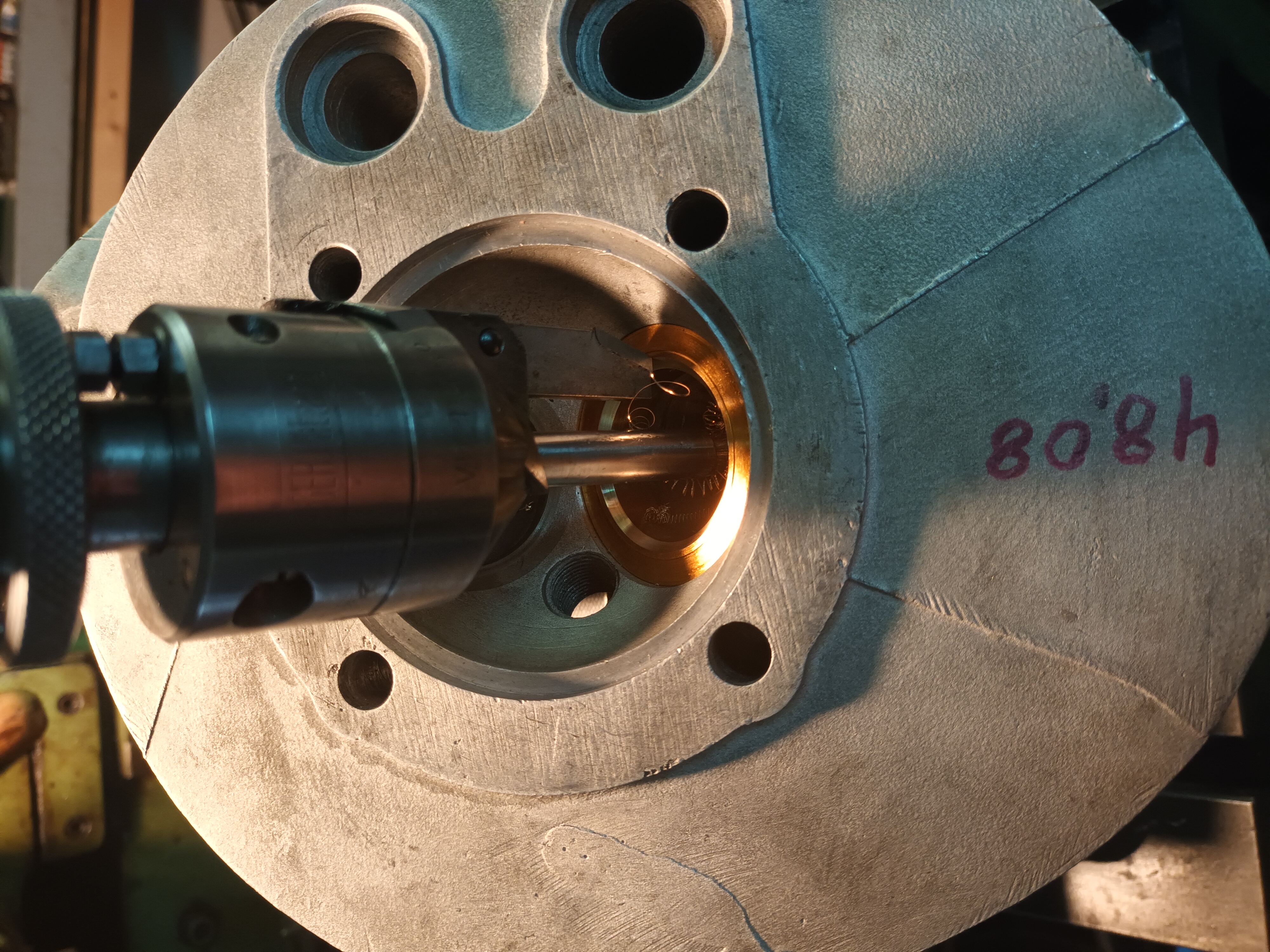

Post by Peter_L »
First cut at the new valve seat.
Interference valv seat to alloy head: 0,05 mm.
I hope it works.
Posts: 5604
Re: Model NH valve angle
MY only comment is you have gotten out to a big diameter on the new seat. Probably unavoidable. That means you don't have much "Give " on the seat. You can always revert to ALL Iron. I'm not a great fan of those heads. Nev
Peter_L
Posts: 5
Joined: Mon Jul 14, 2025 8:36 pm
Post by Peter_L »
You are right. I didn't know that the steel valve seats were casted into the alloy with a interference-angle of about 5°....
And even more, the Ariel 500 cc valve seats were both casted into the alloy as a single spherical cap.
