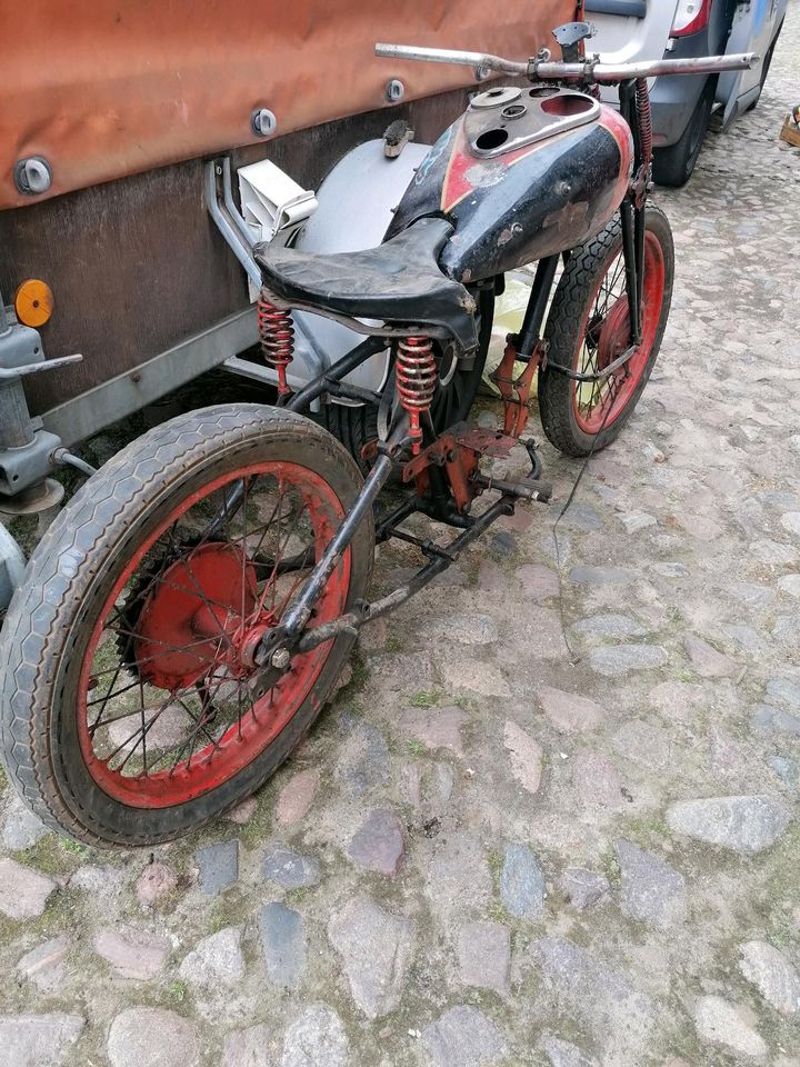

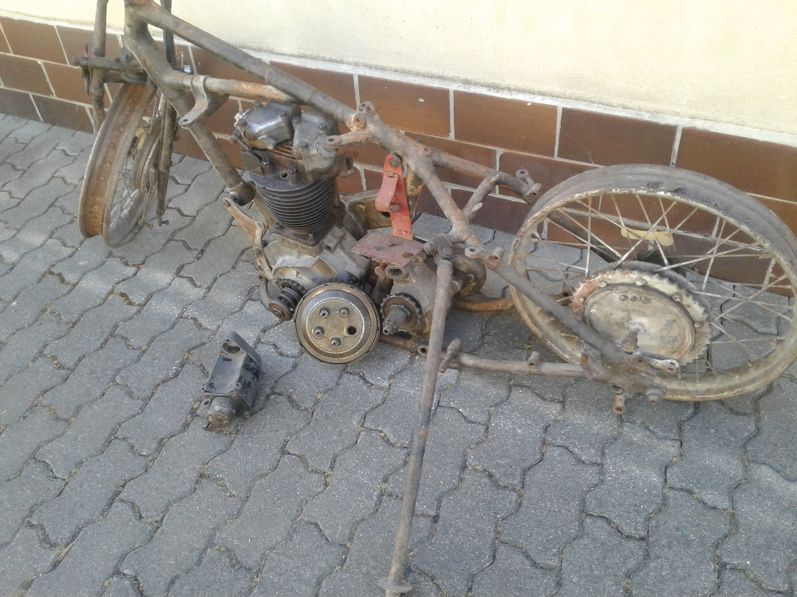

There are two frames : no doupt that one is from a W/NG with field stand.
The other could be a NH from 1946…1950. Unfortunately I did not found the frame number below the saddle.
But as I have learned from some expert here , it is not a W/NG frame.
The components are not enough for two bikes. Also the specifics for W/NG are not included.
So my idea was to create a de-militarised W/NG in black with chromed petrol tank, but field stand still existing.

I think you could equally go two ways with this, either using the civilian frame to build up a 1946-style machine or the W/NG frame and forks to build a 'civilianised' W/NG (there were plenty of those) perhaps with the option of returning it to military specification at some time if you want to do that and can gather enough parts.
Some of the parts you'll need to get (mudguards?) will be common to the civilian and the military versions so you could probably build a running bike and still have plenty of options open. You seem to have already got the difficult 'core' items (frame/forks/wheels) for both bikes!
As an observation, the petrol tank is the slightly larger version than the 350 used - but it looks nice and is easily changed.

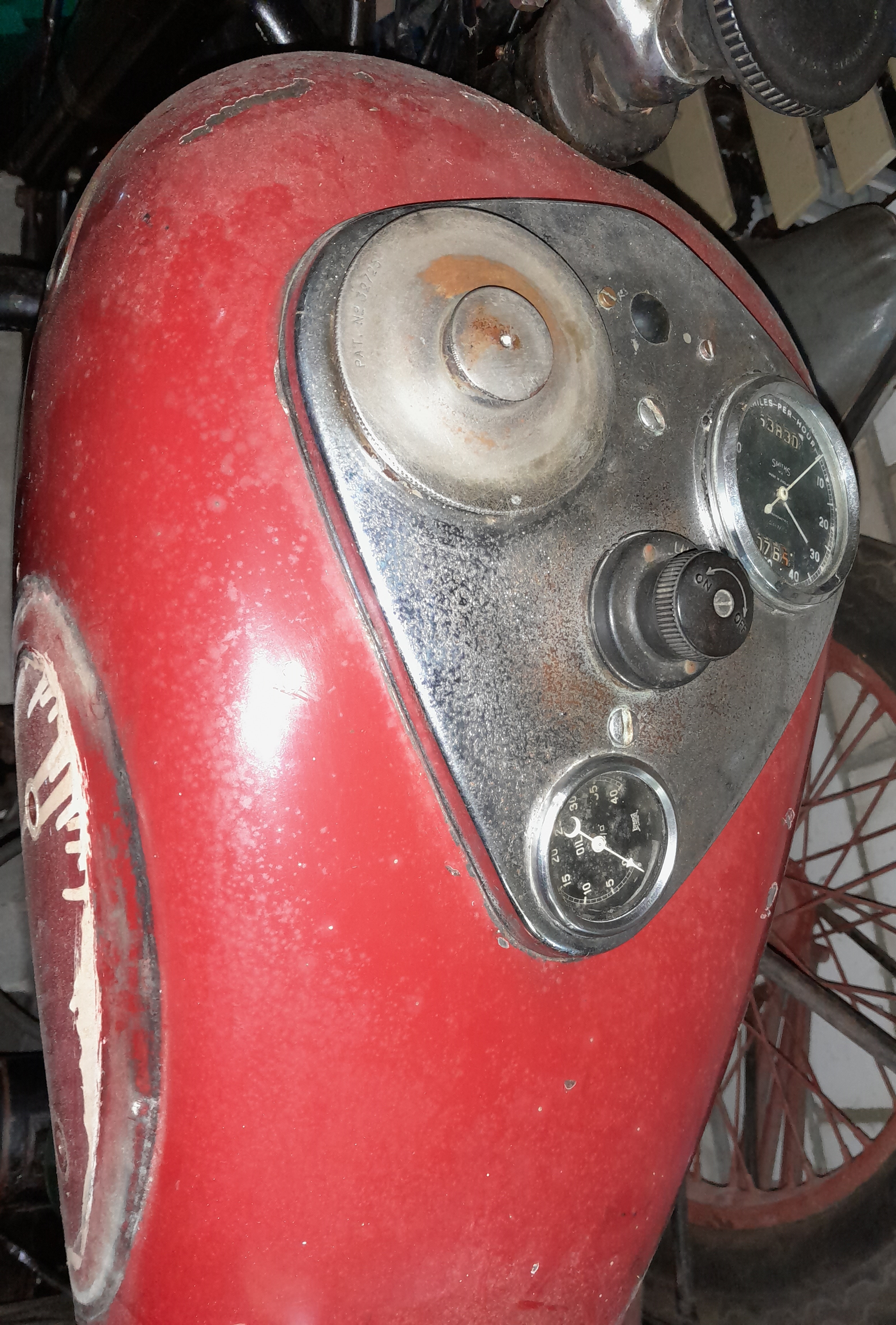

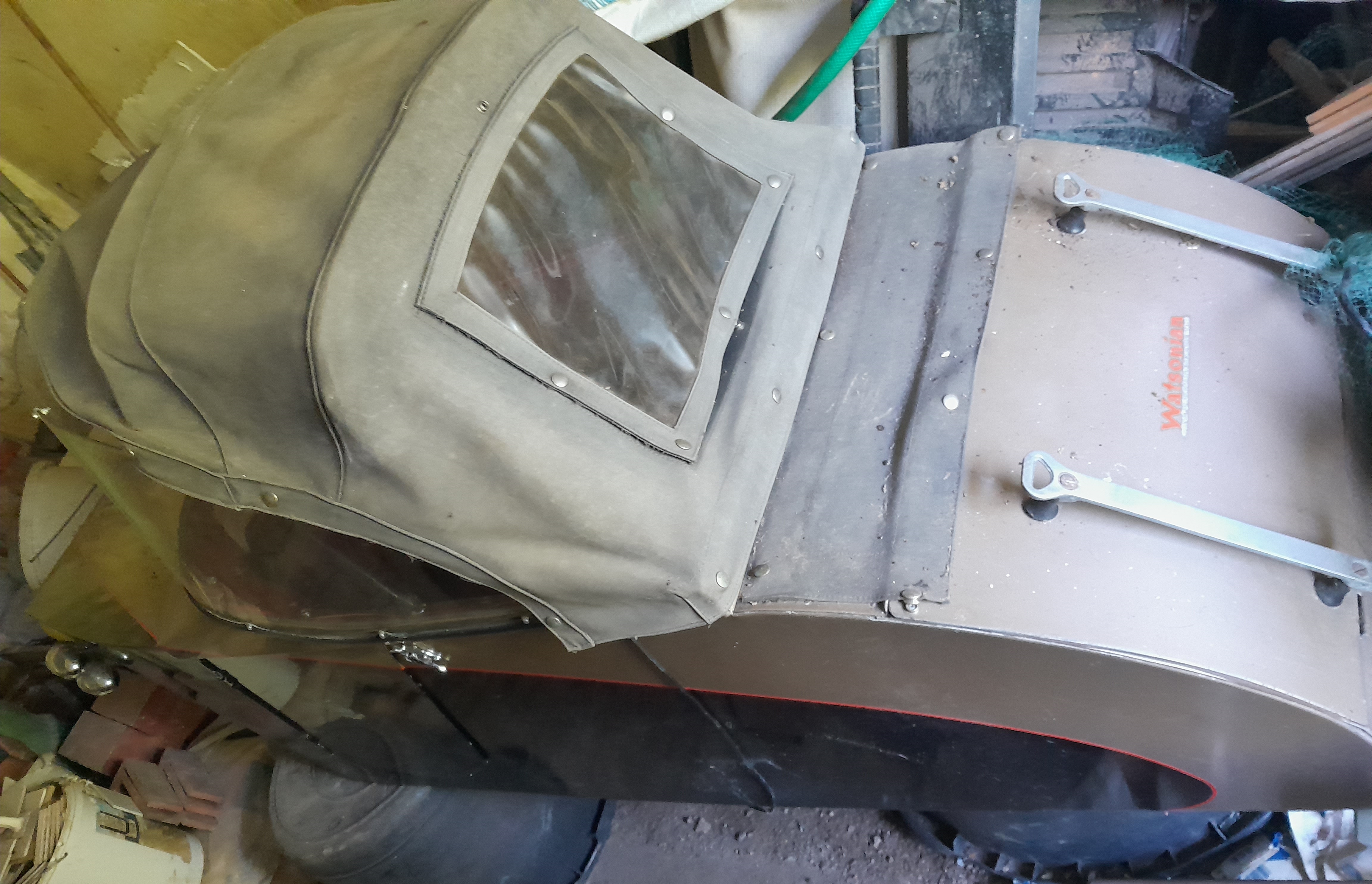

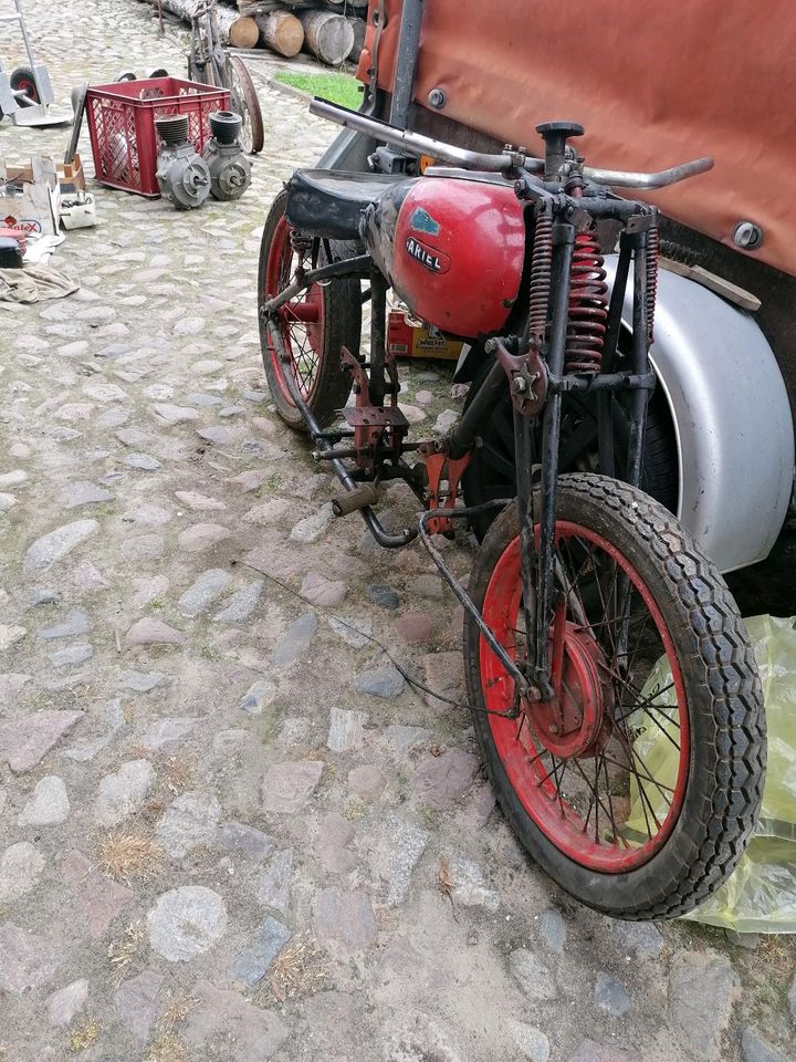

As I was asked for additional photos, here they are coming : This is the vintage fuel tank that I will take for the 'civilianised' W/NG and this will be in future a 1953 VB and it shall run with a Watsonian Monarch unfortunately it is standing in a dirty barn
and I hope for ending this situation soon, but with damaged knees - osteoarthritis -
working is not so easy and takes much more time than in younger years.

The Panel Tank does nothing for ME and the "Field stand" is not a great thing on hard surfaces . It can slip. Nev
