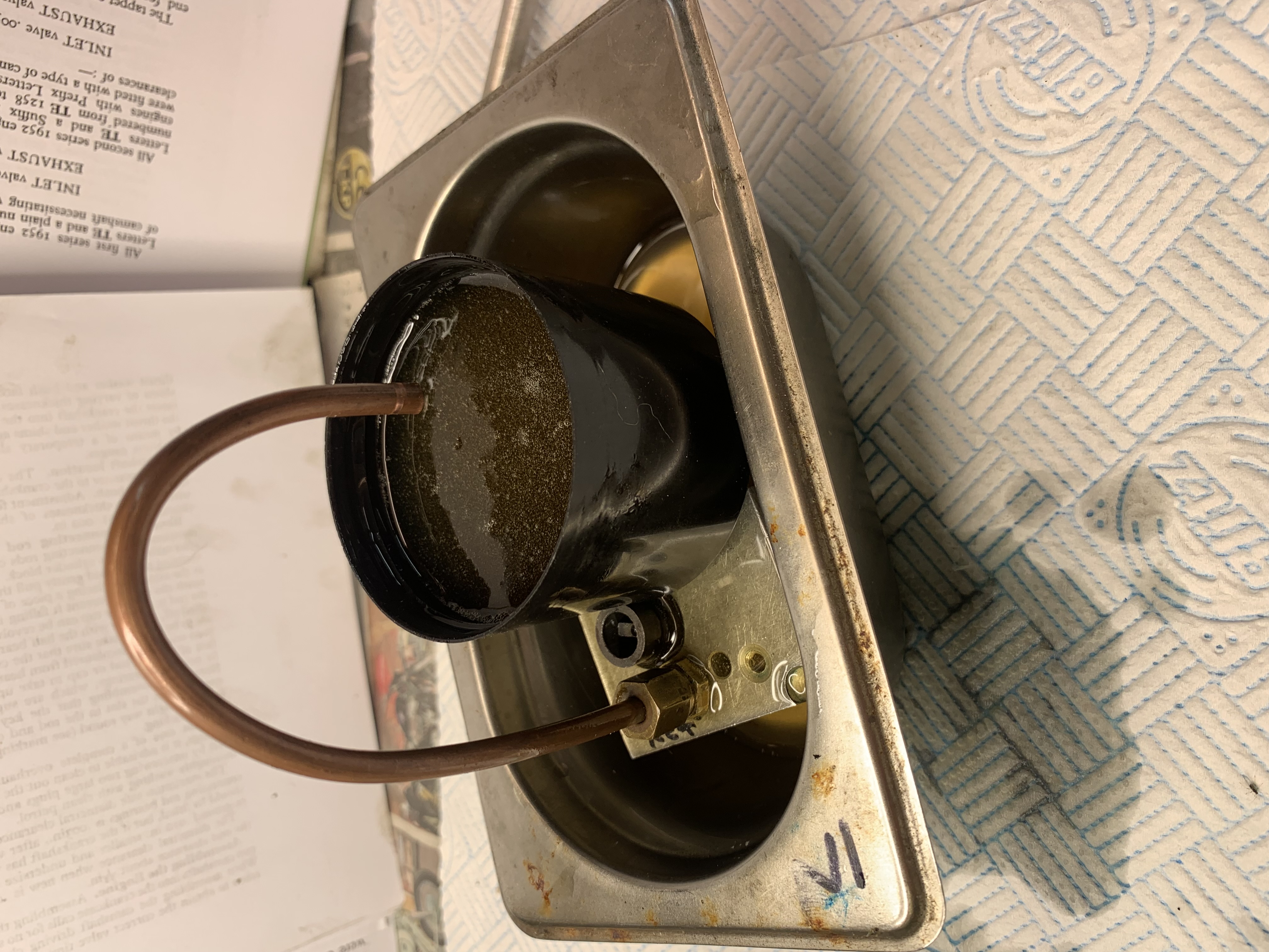

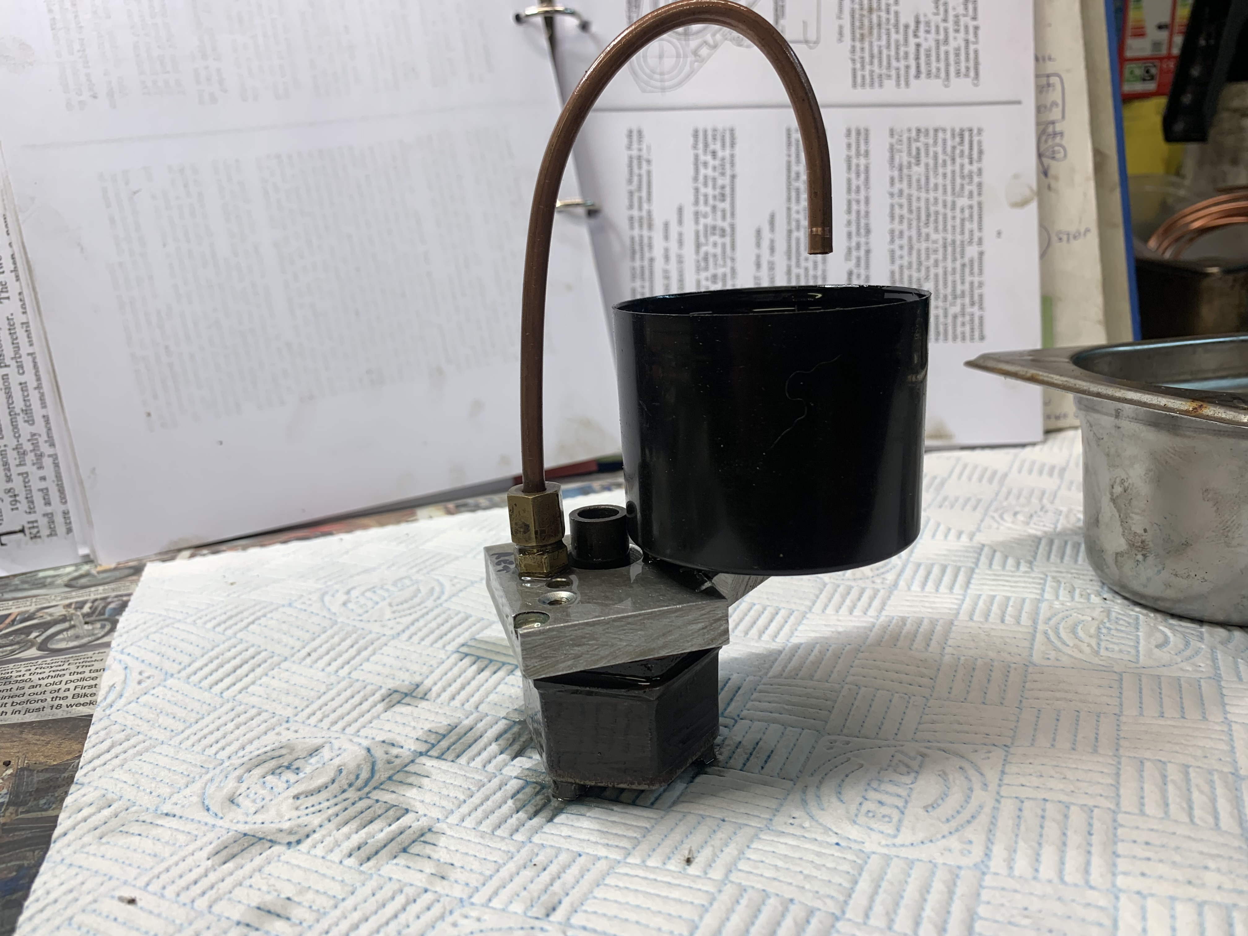

Update: I think the oil pump is fine!
I made up a bench jig with a 'tank' and a 'sump' and drove it with a battery drill. The return flow definitely exceeds the feed flow.
Attached are images of the pump with manifold plate and tank (aerosol lid) and the unit sat in the sump (banmarie tray).
I've also linked videos showing two tests.
'Pump Test Normal' starts with the tank full and a residue in the sump. You can see that once the residue in the sump is pumped into the tank the tank level is maintained and the return side returns aerated oil to the tank. Feed flow is to the manifold plate top surface, the oil then runs into the sump.
'Pump Test Wet-Sumped' starts with the tank empty and the sump full. At the beginning you can see that the feed side pumps bubbles (empty tank) and the return side pumps a steady stream of oil until the sump is emptied back into the tank, whereupon the state in 'Pump Test Normal' is attained.
https://drive.google.com/file/d/17mWNGX ... drive_link
https://drive.google.com/file/d/17gKeyf ... drive_link
So I'll be looking at all other aspects again. It's been suggested I try 'running-in oil' to see if that beds the oil rings in.
