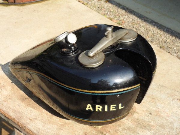

I was able to buy the '28 petrol/oil tank that was for sale on the Swedish auction site and referenced early in the replies to this post (Microsoft translate really needs upgrading :roll: ). It arrived a couple of days ago and whilst it was pretty expensive when all the extra costs were factored in I am really happy with it. It is solid and in great shape except for the usual early Ariel tank issue of some clumsy past pseudomechanic over tightening the attaching screws so they puncture the bottom of the tank. The rear two fixing sites have this problem, but that is easily fixed. I had a look inside with my endoscope inspection camera and it the whole inside is really clean and virtually rust free :shock: . No signs of dents either. The oil dripper is in great shape also - hopefully works as well as it looks.
Posts: 2003
Re: 1928 Mod A/B restoration help needed
Lovely old nickle plating
Posts: 1198
very nice condition, You saved yourself a lot of work with the renovation.
