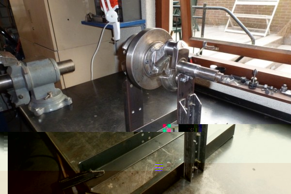

If you cannot find anyone to dynamic balance the cranks you may be able to static balance yourself, or at least check statically. As the 4 is one down and one up crank throws the balance factor is zero.
Make up a frame with 2 narrow straight edges that can be adjusted to be perfectly level from end to end and a suitable distance apart(level across as well) to run on the bearing surfaces. I used 2 steel angles that were perfectly straight. Preferably turn a sleeve with the same outer diameter as the larger bearing surface and slip it on the smaller shaft. If you can’t turn a sleeve then you can set one side higher by half the difference in shaft dia from timing to drive side. It is then only a matter of sitting the crank (with bobweights and flywheel on) on the perfectly level straight edges and seeing if the crank rolls and where it stops. If it stops at the same point every time mark the bottom of the flywheel and drill a small hole. Keep enlarging or deepening the hole until the crank stops at a different point every time. The crank is now static balanced. Static balancing is done in one plane only. Dynamic balancing is done in 2 planes. It is just like having you car wheels balanced with a bubble balance (static) or electronic (dynamic). The dynamic is obviously superior but 9 times out of 10 the static balance will be vibration free.
See the photo for how simple the frame is. I cramp the frame to my lathe bed which is set perfectly level and then I check the frame for level and adjust if necessary.
David

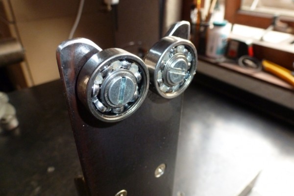

- Posts: 5051
Knife edges are better. You will find if your set-up works well by how consistently the wheels will come to rest in the same place with a very small amount of out of balance. Good knife edges are virtually frictionless, but you have to have them level and the edge must be undamaged. With ball bearings the smaller the better and the wide contact area is not desireable so you could have a thin edged disc with small ball race in each one . Nev
