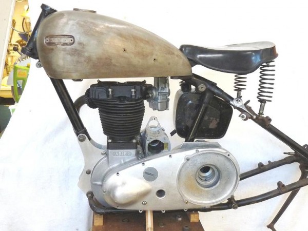

Upon popular demand (....?...) here is the start of a new thread about my SpAriel.
Not at all as deep like Adrie's Edwardian recreation, but just cobbling together some of the parts that I collected in 30 odd years of Arielling .
Idea behind this excersice is building a rigid framed telescopic early '50isch Ariel 500 single for -ahum- dayly use.
The kick off was summer last year when I bought a ex WD frame.
More pics to be added in due time.

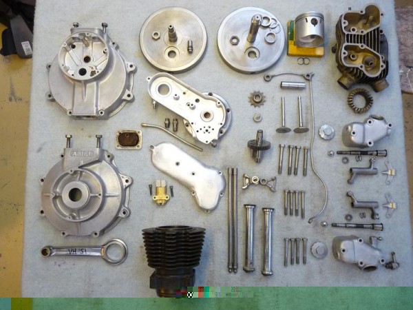

Here a pic of the 1951 VH engine, bought in 1991 in Liverpool from Ben Lloyd (I think) a bike dealer.
Early 50is crankcases can be reconized by that the alloy below the front left hand crankcase mouth stud runs down all the way instead of ending in a scallop (if that's the right word....)
Cil. head will be a single port, head in pic actually belongs to my -other- 1951 VH.
No main bearings yet, I am getting to grips with the price of new Hoffmann ones from R&M, but I think I just have to do that.....
Steel crank has now been rebuild with new Alpha bigend and NOS drive side mainshaft from John Budgen. Piston via Pete Kemp.
Shortened Triumph Morgo plunger oil pump, done some years ago before they where making them for Ariel as now.
Single lobe cam.
Single lobe cam.

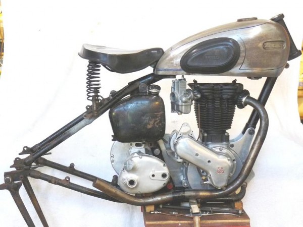

- Posts: 4313
Re: 'The SpAriel'
Front of gearbox comes from AJS/Matchless and brings the clutch cable in the right direction instead of making a 90 degree bend to get to the front (and through a akward hole in the engine plate.
This 'mod' is also used on the HT Trails models, no provision for a speedo cable (that on a GB leaks most of the time)
Gearbox case is the standard Ariel GB housing.
DellOrto fitted is the reason to get another oil tank, this one now graces Andy's RH.
Perhaps I fit the 1931 model tank I got from him, but plans are taking shape to make myself a 'wrap around' tank a la thirties Norton.
Petrol tank is the India made one as seen in another topic here, lining will be according to 1951 scheme but in Gold/light Blue like on a 1928 Black Ariel. (but not the short stripe visible after the knee grip)
Whole bike will be black, hubs, rims, guards etc, A poor man's Black Ariel !
Engine plates in aircraft alloy once liberated from the workshop of the KLM.....rear plates will be flat so spacers are made to connect to the rear of the crankcase.
Large rubber Dunlop 'Drilastic' sadlle , this is a new replica cover from John Budgen on a genuine thirties frame that I had lying around.

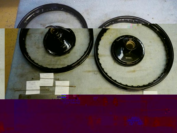

- Posts: 4313
Re: 'The SpAriel'
The wheels in progress.
Makes life easier for the wheel builder.
Vincent
Before stripping the wheels I made up strips of sheet metal to save the offset measurement of the rim to the hubs.Makes life easier for the wheel builder.
Vincent
