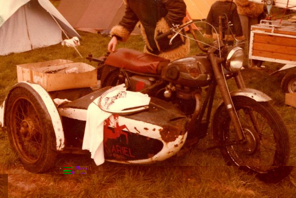

Since 33 years I know of this -in my eyes- most beautiful sidecar ever, period.

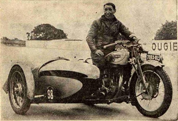

At a Dutch rally in the early eighties I took this pic and was smitten : From a great grandson of one the Bernardet brothers I got this picture:
It shows a Mr. Halhoute on a Motoconfort with Bernardet side during a record attempt in France 1938.
The former owner bought this sidecar in the South of France.
And apart from the color scheme being inverted it rather looks the same......
Streamlined mudguard & and a aeroplane tail.
It's called a 'Grand Sport Record du Monde Avion' !
