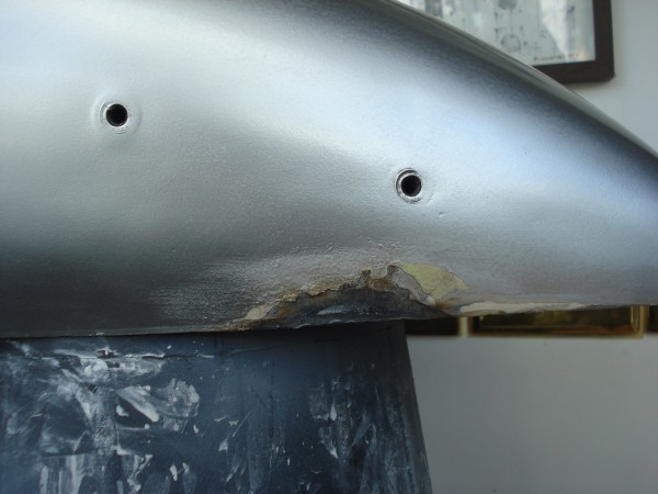

The following picture is of the damage to the paintwork after repair by brazing.
I hope my painting skills are up to achieving a decent repair standard. Any advice, hints / tips etc. gratefully reveived, please.

- Posts: 2950
Re: My 1950 VH
Paint that over and you won't notice it below the knee grip. If you are still worried, slacken off the rocker oil feed unions for a short while to give a decent oil leak and after that you certainly won't notice !
