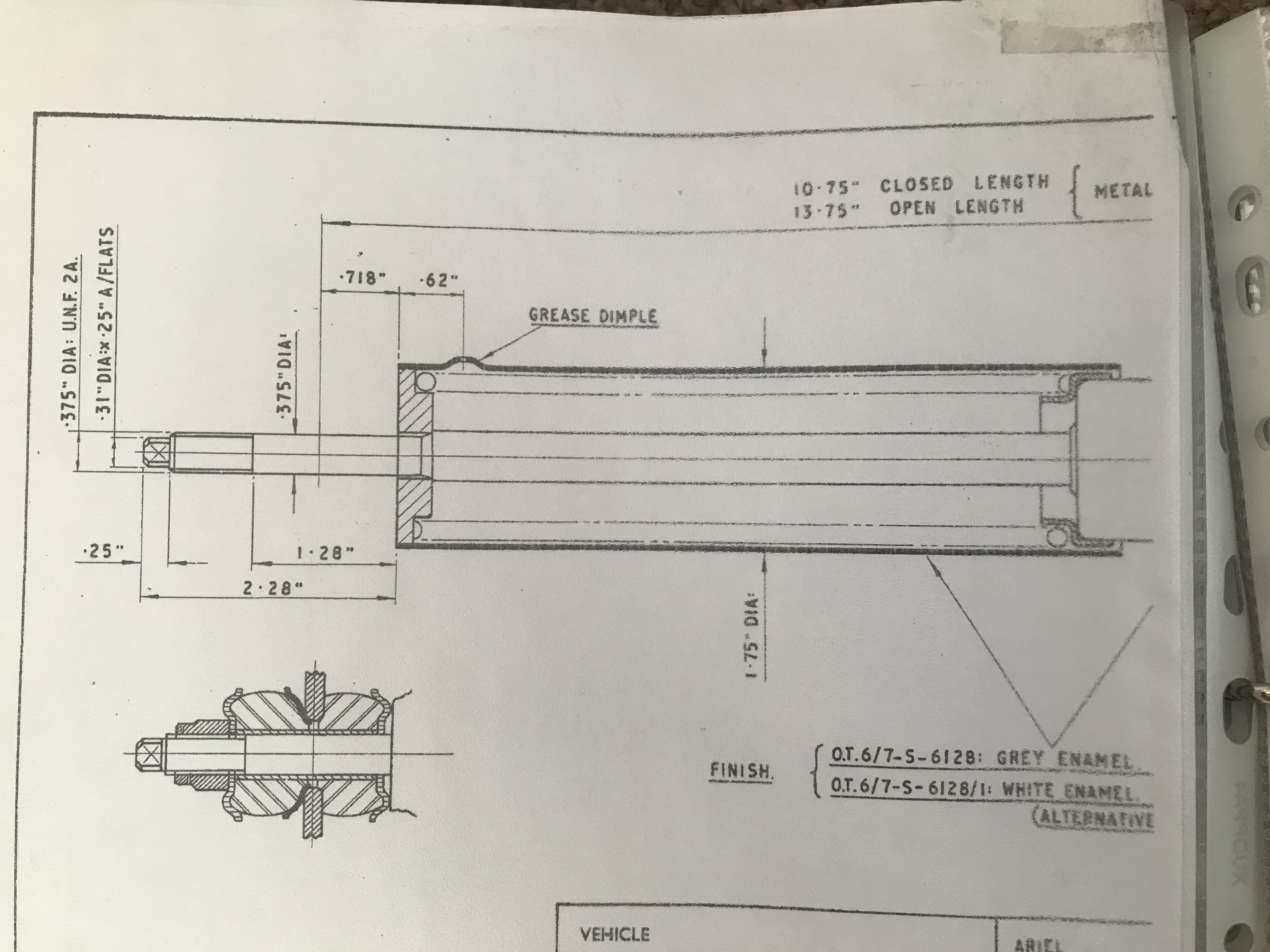

Good morning
Can anyone help please,
I am trying to find out the dimensions of the rear shocks when fully closed and fully open in an effort to source some alternatives to the originals.
Paul
Paul

Re: ARIEL LEADER SHOCK ABSORBERS
There is a copy of the original drawing of the rear damper around, I saved the image but can I find it now…
Does anyone have it to share with Paul?

- Posts: 1128
Ivor, I hope you don't mind, I have added the drawing to the club's drawing archive. Do you have any more that we may not have on file? This one looks like a drawing from Armstrongs and may not be quite as supplied as I am pretty sure that grease nipples were not fitted.
- Posts: 965
I'd wondered about the 'grease dimple' on the drawing. Both of the dampers on my
200 Arrow have holes in that position although they are plain and not raised.
