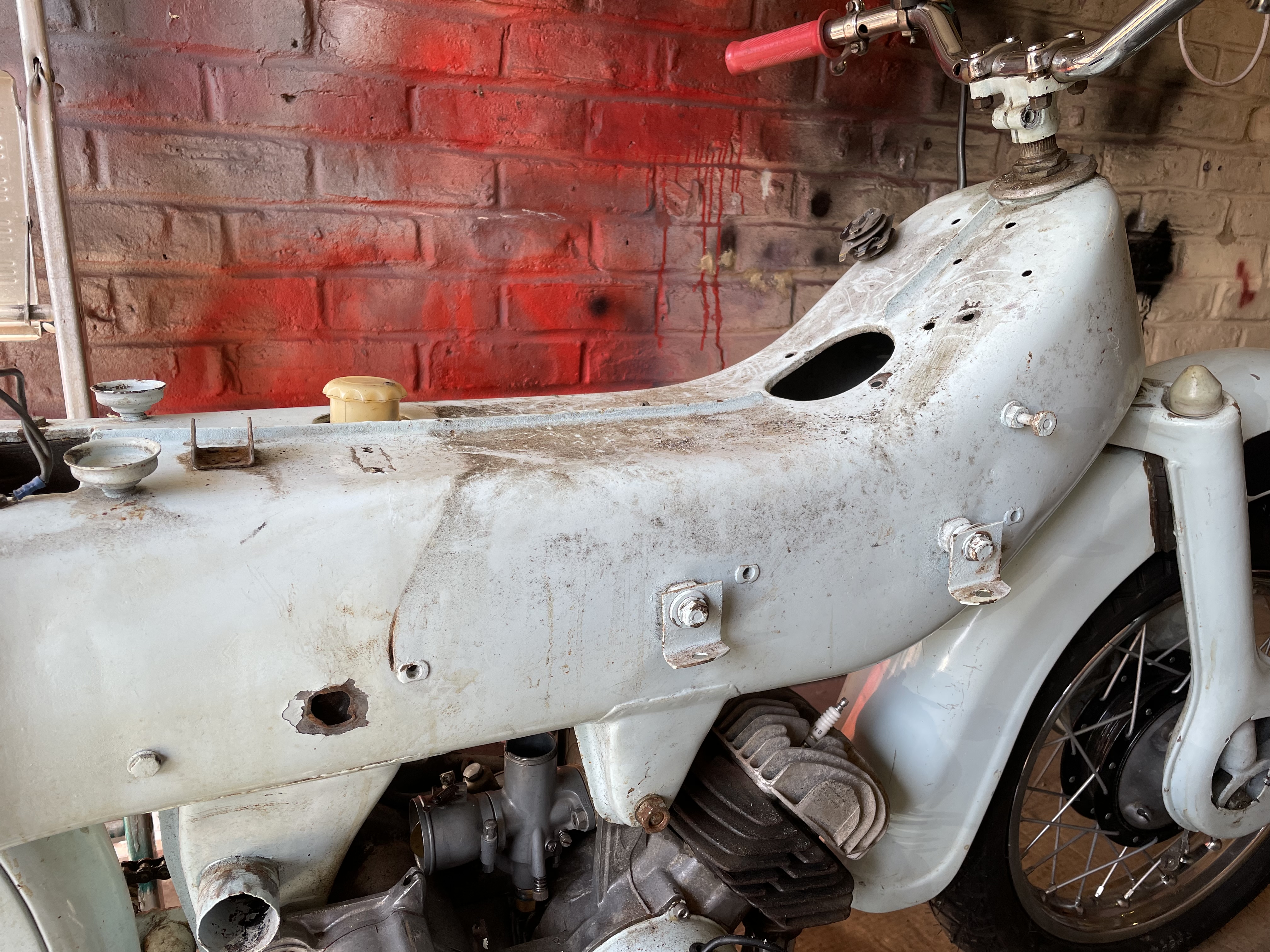

Having been caught with buying a arrow sports in boxes only to find out I had a Leader engine and Frame but a lot of Arrow part. So I did not give up and now own a complete 1961 Sports arrow which runs but needs a repaint and new silencers. All good so far I have a V5 with the same engine and chassis numbers T21314/G. Just started to take it apart only to find the frame looks like the leader one I have! The paintwork looks original and overall the bike is in good condition. So can anyone tell me if its correct or have again been done! See attached Photo

Mmm. I've never seen a VIN plate quite like that before, nor have I seen one
positioned where that one seems to be.
The one obvious difference I'm aware of between Leader and Arrow frames is that
there is a bracket on the front of the Leader frame by the headset which isn't present
on the Arrow.
on the Arrow.

For what it's worth attached should be a photo of an Arrow frame.
There are some obvious differences around the mountings for the dummy
tank and some extra fixings on yours and not on mine.
Another though is that given the frame and engine number the bike would
have had the later front forks with the parallelogram brake linkage and not
the earlier ones which yours appear to be.

Stu, The frame in the picture you have posted is a Leader frame part converted to make it useable as an Arrow frame, the horn bracket at the front has been removed so the headlamp can be fitted, the bracket gets in the way otherwise, the give away that its a Leader frame are the lugs sticking out down the side, on the Leader these are for the side panel screws, I see the lug at the rear has been removed leaving a bit of a jagged hole, on the Arrow frame a grommet is fitted to this hole both sides. You will also find looking inside the frame smaller lugs down the side , on the outside you just see the holes, these are for bolts to hold in place the Leader bodyshell. You can easily remove all the lugs creating a more convincing Arrow frame however please note, the frame might be bent under the headstock looking at how close the back section of the lower front mudguard is to the cylinder heads, there should be a gap of at least 2 inches between the mudguard and heads. I could be wrong, sown to just the angle of the shot taken, a full on side shot with the forks straight ahead would show how much of a gap there is. I've checked the Ariel Factory Despatch Records, T21314G confirmed it left the factory as a Super Sports Arrow in Gold and Light Admiralty Grey on 21 2 61 and went to the Dealer E A Boult of Stone in Staffordshire. Jess

Thanks for your reply this is what I thought a bit fed up but trusted the V5 and vin numbers also the paint does look original so I assume Leaders were also finished in Admiralty Grey. It would be interesting to know the history of when and why the frame was changed, the Vin plate looks like its been there for some years and not a recent addition so all this may be 40 plus years ago!The photo gives a distorted view of the mudguard I have a good 2 inch gap but noticed a small crack on the Engine mounting lug of the frame which I will have a closer look at when I strip it down. At leased the engine looks original with a Amal 376 carb. And the chain guard is good. I would like to get it back as original as possible and unless I find another frame consider modifying the existing one.
- Posts: 1145
Re: Arrow Frame
The VIN plate is definitely home made
