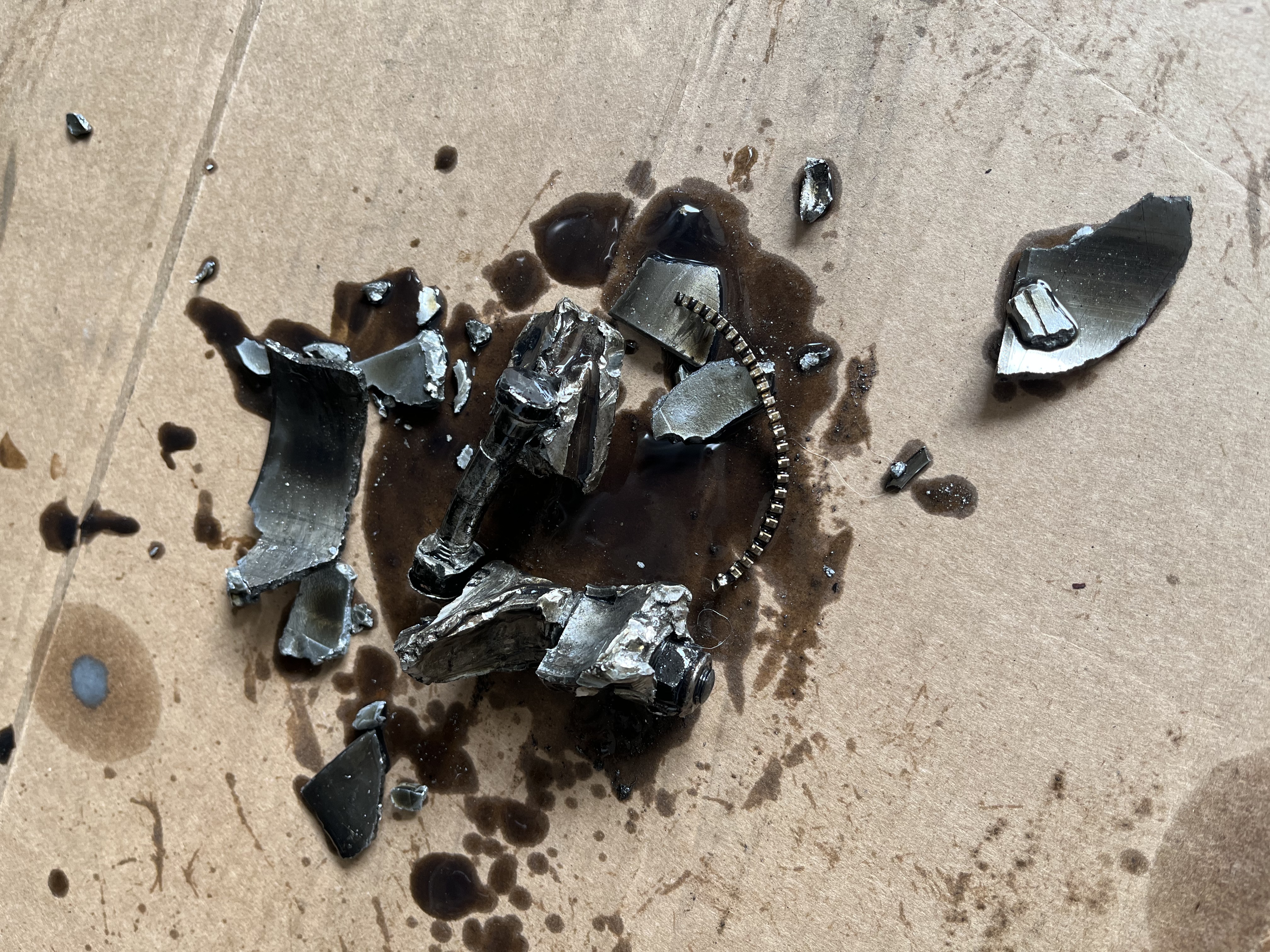

Well, it was the no. 3 rod that failed…
Why? I don’t know. Sludge traps were meticulously clean, everything built up as it should, but somewhere something was wrong, I missed something or made a mistake somewhere.

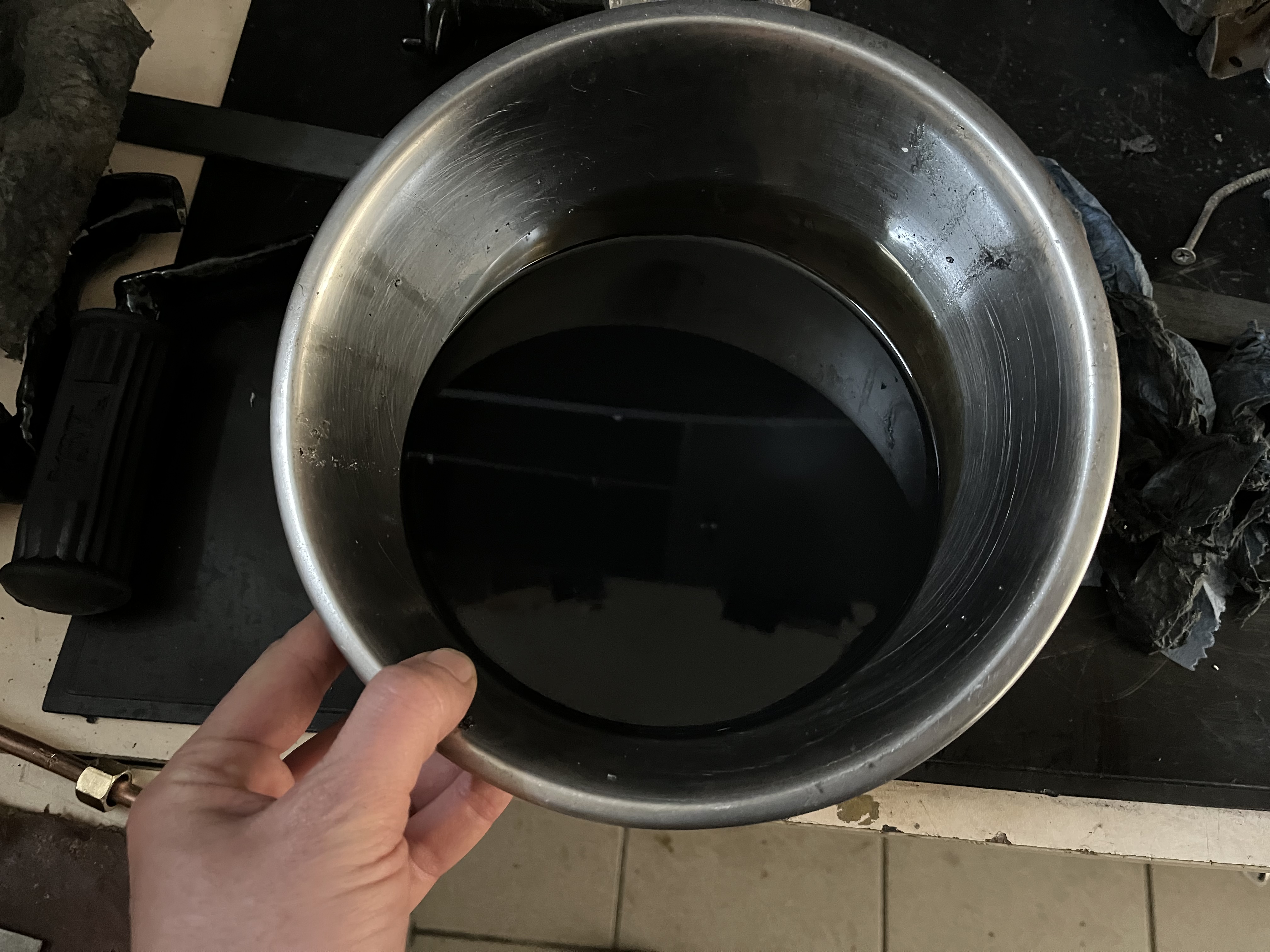

I suspect something to do with the lubrication system. Those who followed my tribulations know I had a problem with wet sumping and I put it down to the morgo which was letting oil flow through. I had the pump repaired at Morgo and thought that was it, but now as I opened up the sump the cases were again full of oil as you can see in the picture. So I suppose for some reason the pump is pushing the oil into the cases or not scavenging (although I could always see a good flow of oil back into the tank), and the oil is not going where it should be.
The 2nd pic one can see some of the bits that fell out of the sump. Rod and piston are destroyed and probably also the piston liner and God Knows what else. From what I could see from underneath the other 3 rods are intact, but who knows what collateral damage they have suffered.

In the lower picture it looks like I can see both bolts that hold the number 3 big end together. They are both very damaged, but one looks like it may have come loose?
Also, this looks like an original rod and big end bolts, not the new club rods and bolts. If that is the case then that might be a clue as to what happened.
Apologies if I’m reading too much into the second photo, and they are club rods.

Definitely an original rod rather than a Club one. We know the head and barrel had been skimmed many times so it may well be that this is a relatively high mileage bike - or a high load sidecar bike - where the rod had reached the end of its fatigue life. When a rod fails due to the big end seizing because of lack of lubrication the end of the rod left on the crank usually punches its way out through the casings. Only a stripdown will indicate what happened.
