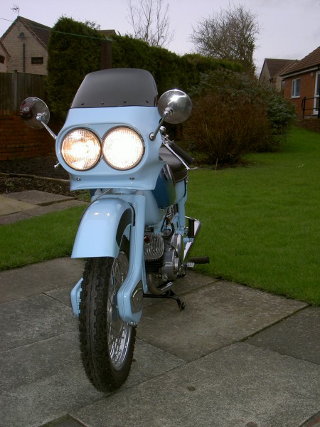

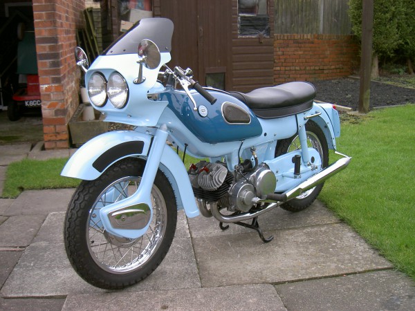

Its not getting warmer here in hilly Derbyshire, pretty darned cold in fact whilst working in the shed everyday last week re configuring one of the Arrow projects, it had a bare crankcase fitted so took a short cut and fitted the rebuilt engine that was in the Arrow Ron used at Mallory the other year only to have a heck of a job to get it to fire up then it ran erratically, after various checks and the running getting worse decided to strip the engine down and change the crankshaft seals and bearings, it had the old Nitrile double lipped seal fitted that had numerous small cracks in the seal lips, although the rubber was still supple it was hardly gripping the journal and therefore suspect allowing leaks from one side of crankcase to the other hence the erratic running. This is the third new old stock centre double lipped Nitrile seal that's failed on my Arrow engines in the last couple of years that have had to be changed, I now only fit Viton seals. Wonder whether its age or the petrol and its Ethanol content that's causing the problem or combination of both.
Couldn't stand another day in a freezing shed so wheeled the Arrow into the house and worked in comfort yesterday as I started the rebuild, should be back together and running today.

I might change that weather summary , it's gone cold again. I like the twin headlights and the mirrors on the Arrow, they have given me an idea for the MK 2.
