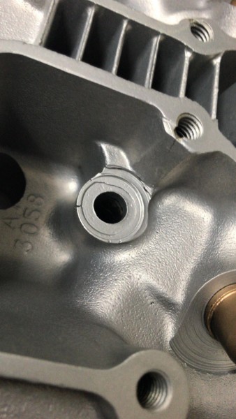

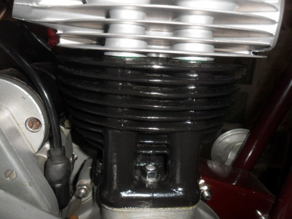

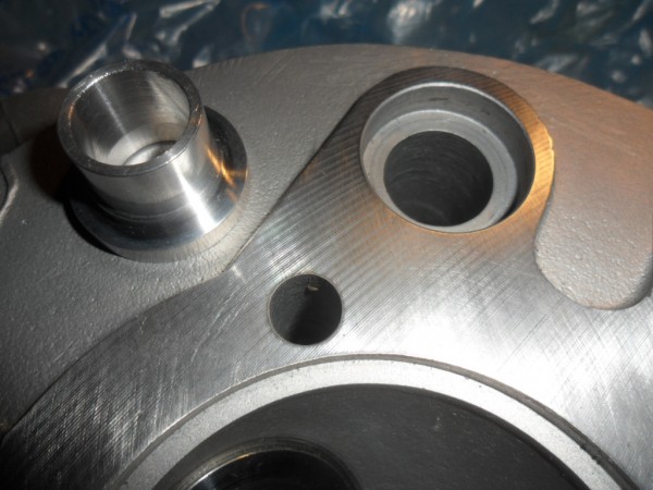

I have re-fitted the cylinder head. Hardened valve seats, new valves, guides and springs.
From this: To this: I also designed and made a collar to locate a Viton O ring instead of the rubber sleeves to seal the push rod tube. The green O ring is just visible in picture 1.
Like this: Push fit into the head (and a smear of Wellseal) as in picture 2.
A 'top hat' insert was made up to overcome the cracking under the head to barrel fixing bolts.From this: To this: I also designed and made a collar to locate a Viton O ring instead of the rubber sleeves to seal the push rod tube. The green O ring is just visible in picture 1.

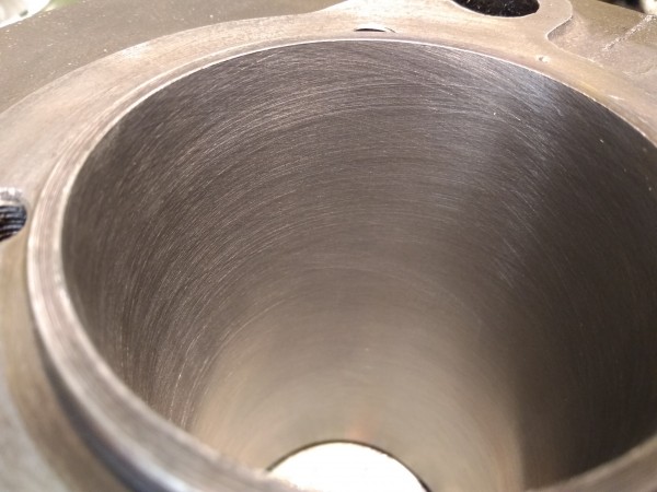

Honed the bore:

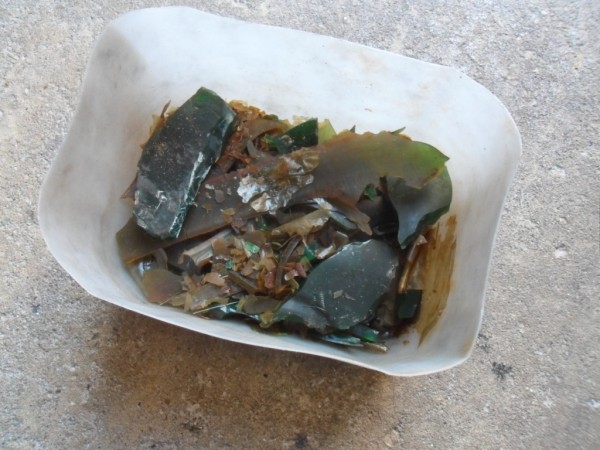

Petseal......argghhh.
Remains of Petseal applied 40 years ago. Destroyed by un-leaded and E5 petrol.
Spent ages shaking it out and blowing it out with the airline and a long nozzle on the air gun.
