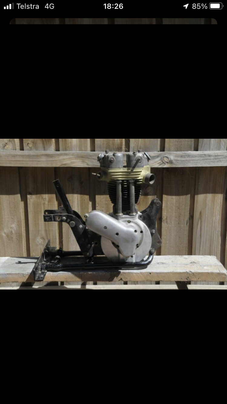

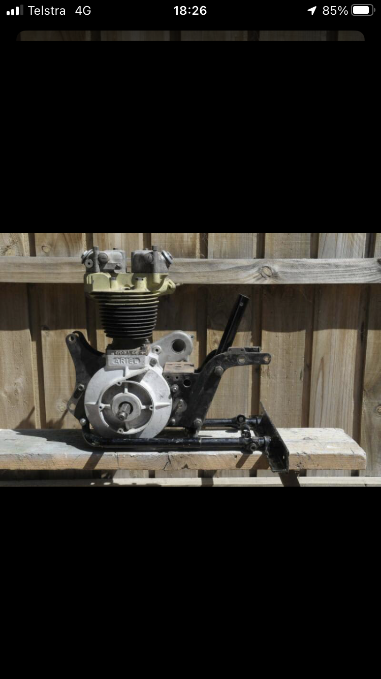

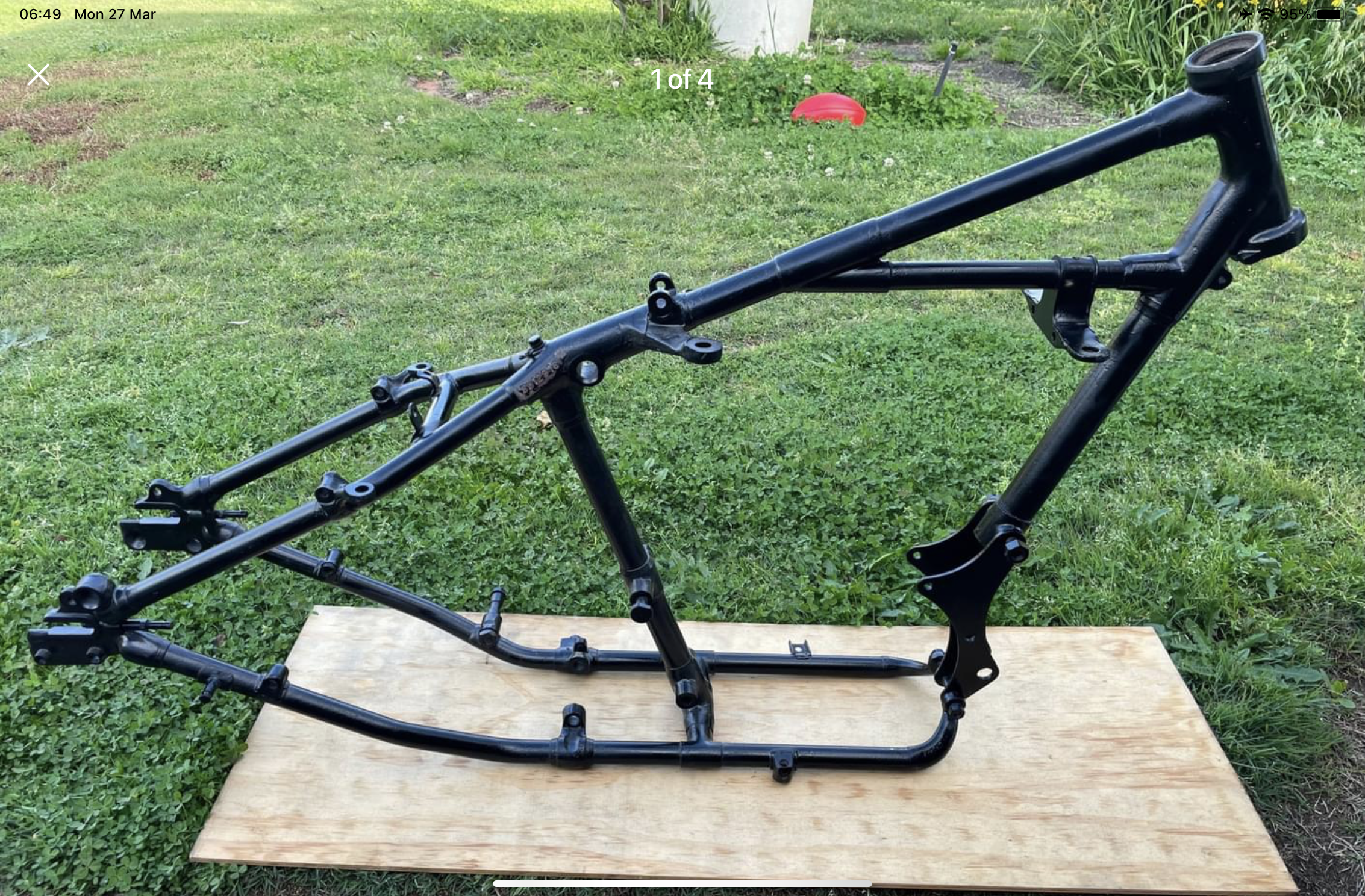

Have built a few engines and bikes over the years and have always been keen to find myself an Ariel but i just didn’t get around to it. Well that is until a few days ago, I’ve just picked myself a rigid frame, serial number prefix BP which I believe puts in the years 46-48 and either a NG or NH. I have also picked up a BK prefixed 350 engine that is 90% complete. Engine comes in an old cut down frame with front mount and rear engine/magnadyno mount…engine is on the other side of the country, just got to get it here!!

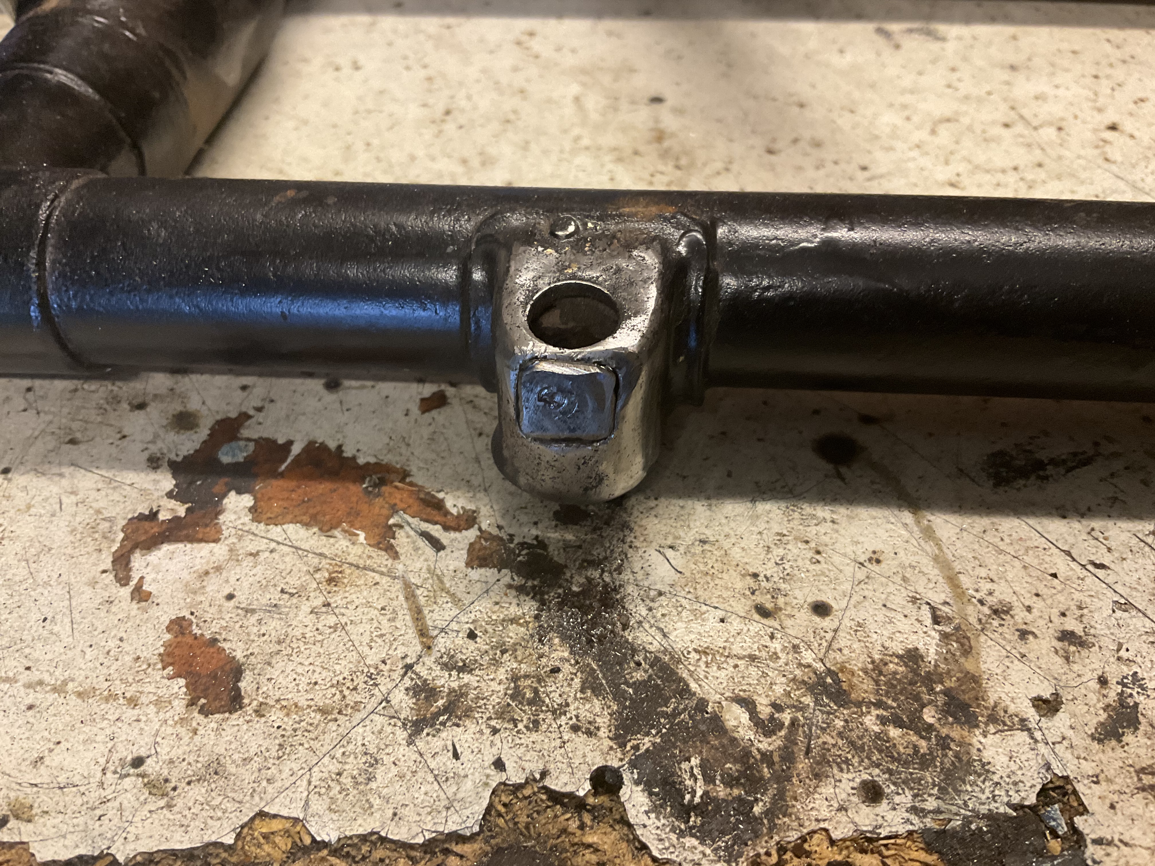

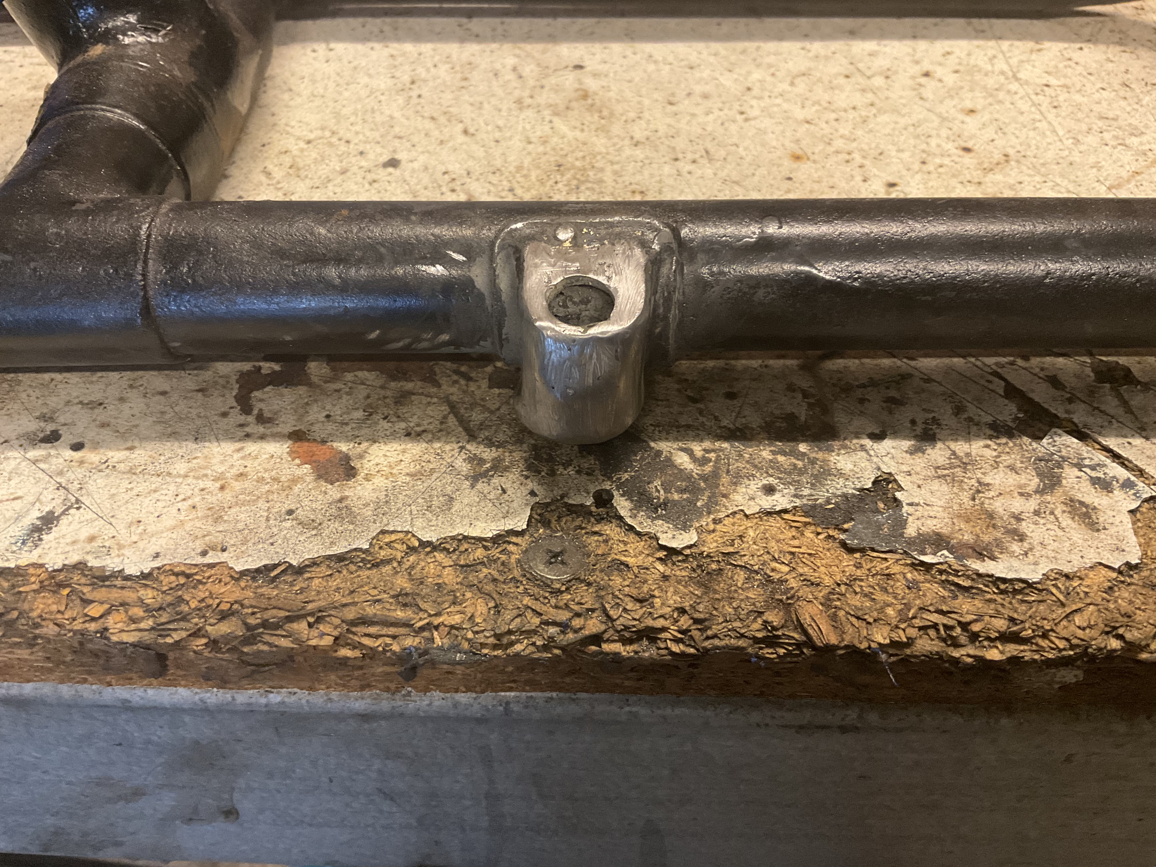

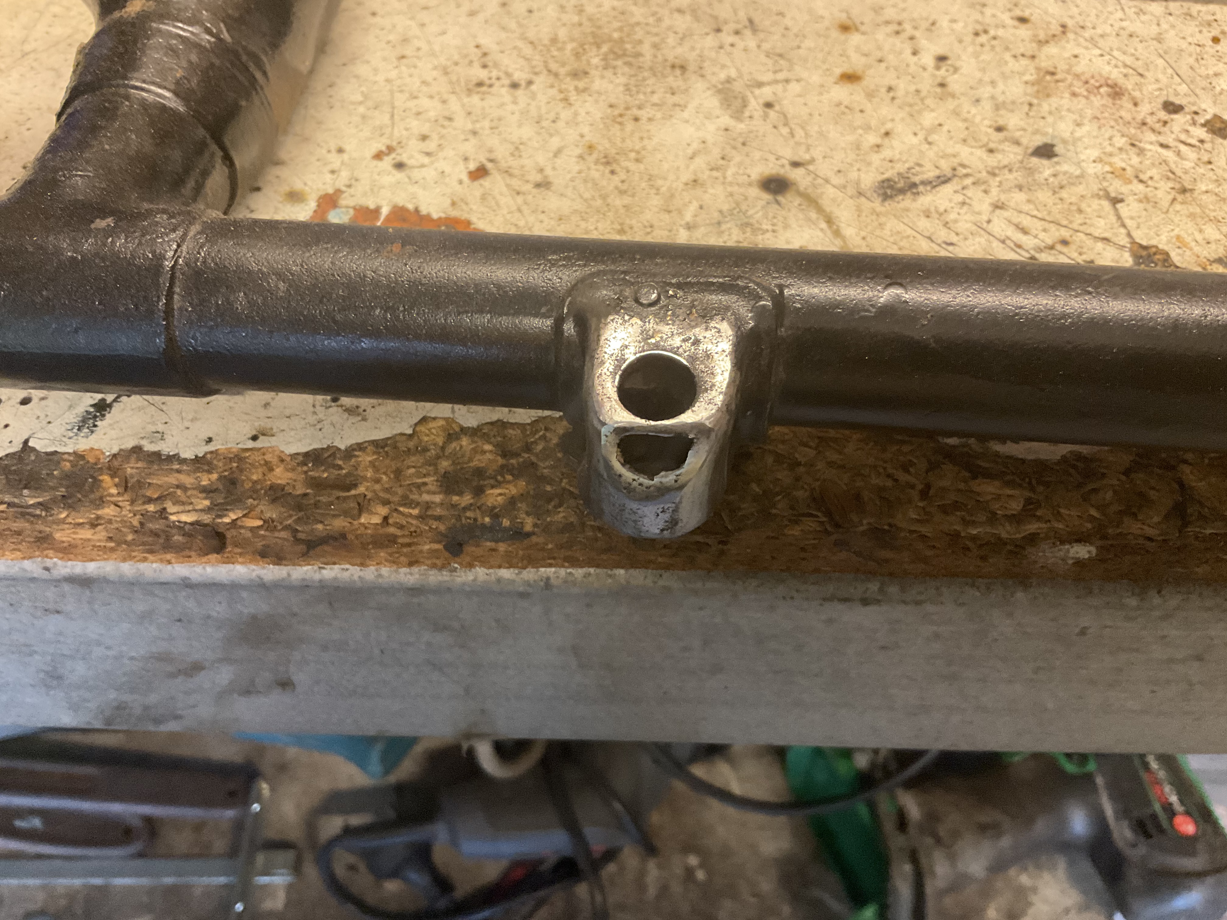

Got a couple of jobs done on the frame today, I found a broken bolt on what I believe to be a primary case mount on the lower left side on the frame, was a sod to get out but got him in the end. Also patched up a hole on what I believe is called the breather bracket on the lower right side, not sure how it got there..looked like gravel rash.
Few pics of the patch up job, squared out the hole with a dremmel then cut a small piece of plate to fit in the hole. Welded her in with the mig and it’s come up ok.

The lug in your pic that you have neatly repaired is for a 'P' clip to hold the exhaust pipe in place.
